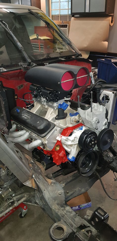

AJ- thanks for the info. I have decided to do the Holley sniper Dual EFI conversion with my 383. I will do some type of IFS coil over to help the front sustention bounce for next year. then will be the front and rear axle upgrade. It is real tight with the headers so I will get a universal kit a tig everything. That way I can do dual exhaust with electric dumps. I'm keeping the NV3500, transfer case and axles for now.
Ordering off of Holley website soon. Will post pics.
I have looked at the 205s and the full sized MP3023 (still chain) for futuret-cases. Also considering converting to AWD (less moving parts) but no low gears.

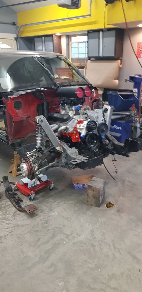

Hey Don- I sure can. I will take some pics when done. I got the strut tower on summit. RTE-BR1059 I used the budget friendly Summit coilovers SUM-G773501 with 150# springs SUM-72-12-150. I left the torsion bars in and am supplementing them with the additional 300 # rated coilovers. If you remember, I had a bad bounce with the 4.3 was in it last year due to all the weight added to the front. And now it has even more weight with the 383. The torsion bars are great when designed for a specific weight. the coilovers are two way adjustable which will help with the control up front. The bottom of the strut is attached to the top control arm which is not idea but I am not using them as the single spring. The majority will be handled by the factory installed torsion bar. the past set up destroyed the front tires. I'm hoping I will be able to dial it in when I bring it our in the spring. I still have more welding to do as well. the top of the towers will stick out slightly on the inner fenders. My set up includes a 2 3/4" body lift. I might look at connecting the towers to the roll cage and each other late on. I do currently have the high lift torsion keys at the lowest capacity. I might put the factory height keys in and crank down on the coilovers if things are still not controlled the way that I want them. I do not want to eliminate the torsion bars all together due to the coilover mounting to the top control arm.

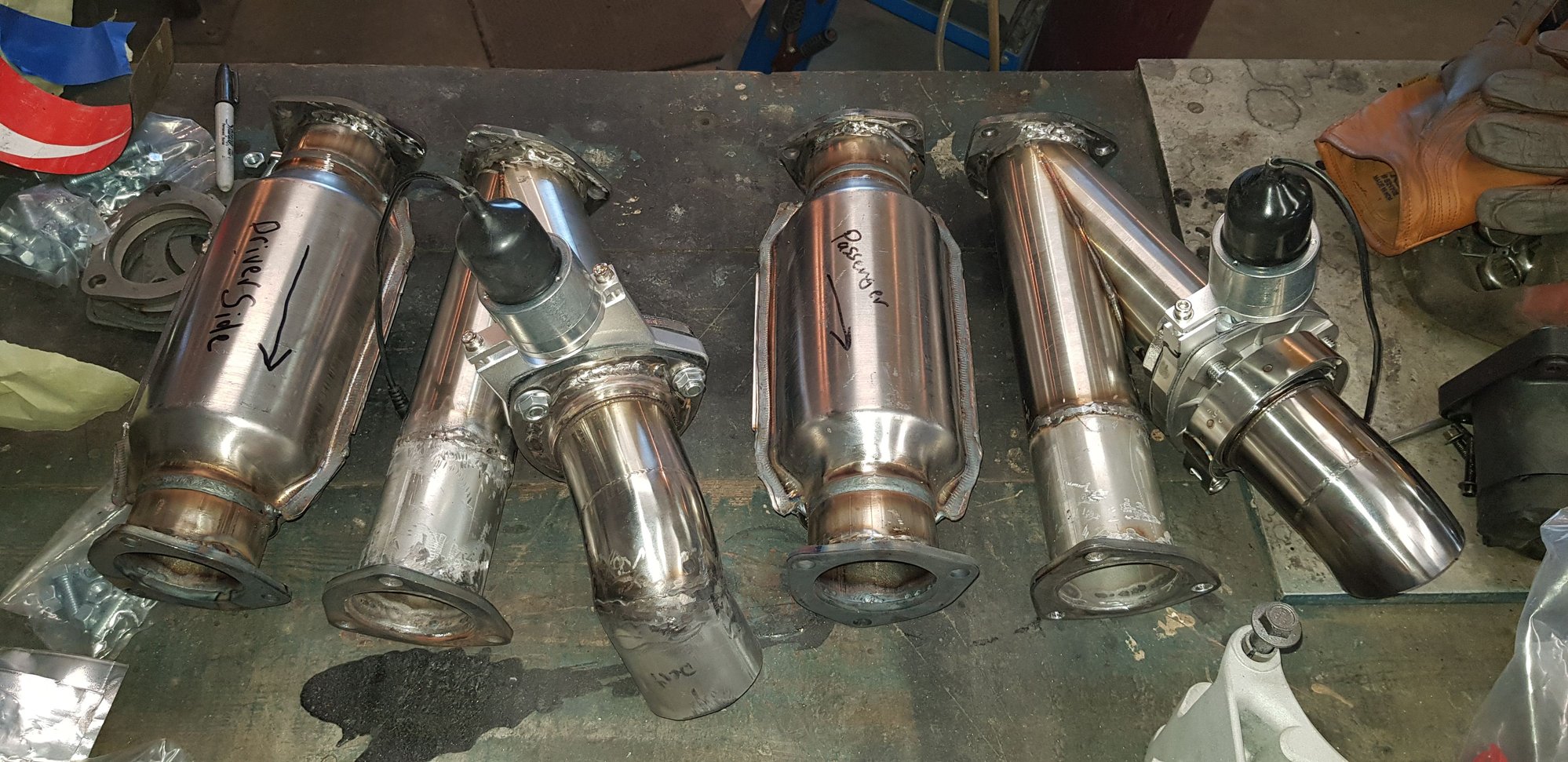

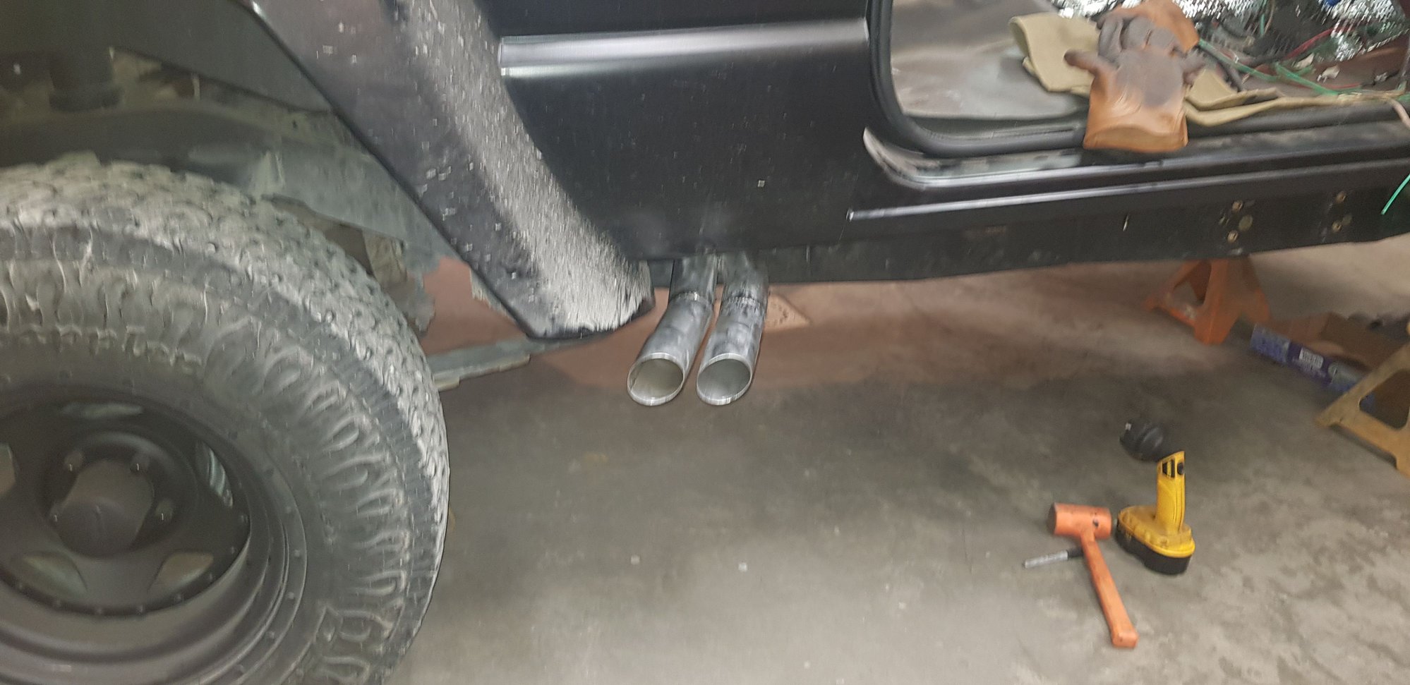

Things I've learned... you can run a 2.5" dual exhaust above the skid plates with cutouts and still exit before the rear tires. The type of lift requires some relief cuts in the lower control arms (tie rod hits when turning). I have not done this yet. The Hedmen headers and
Black Horse motor mounts Black Horse motor mounts
were awesome and basically painless. Everything I read about 8v conversion in to a 4x4 said it was a nightmare. Not true if you have a body lift and the correct parts.

Things I've learned... you can run a 2.5" dual exhaust above the skid plates with cutouts and still exit before the rear tires. The type of lift requires some relief cuts in the lower control arms (tie rod hits when turning). The lower control arms were aftermarket so it might be from the differences causing the clearance issue. I have not done this yet. The Hedmen headers and
were awesome and basically painless. Everything I read about 8v conversion in to a 4x4 said it was a nightmare. Not true if you have a body lift and the correct parts. I did lower the aftermarket bump stop to limit the cv axle angles so when spirited driving with the big motor won't send parts flying. I also discovered all 2 door v6 manuals came with beefier 8.5 rear Posi (limited slip G80). Similar to the ZR2 but without the disk brakes. I might just save some $$$ and build off the factory rear axel. That might be next year tho along with the 3 link and coilovers.
