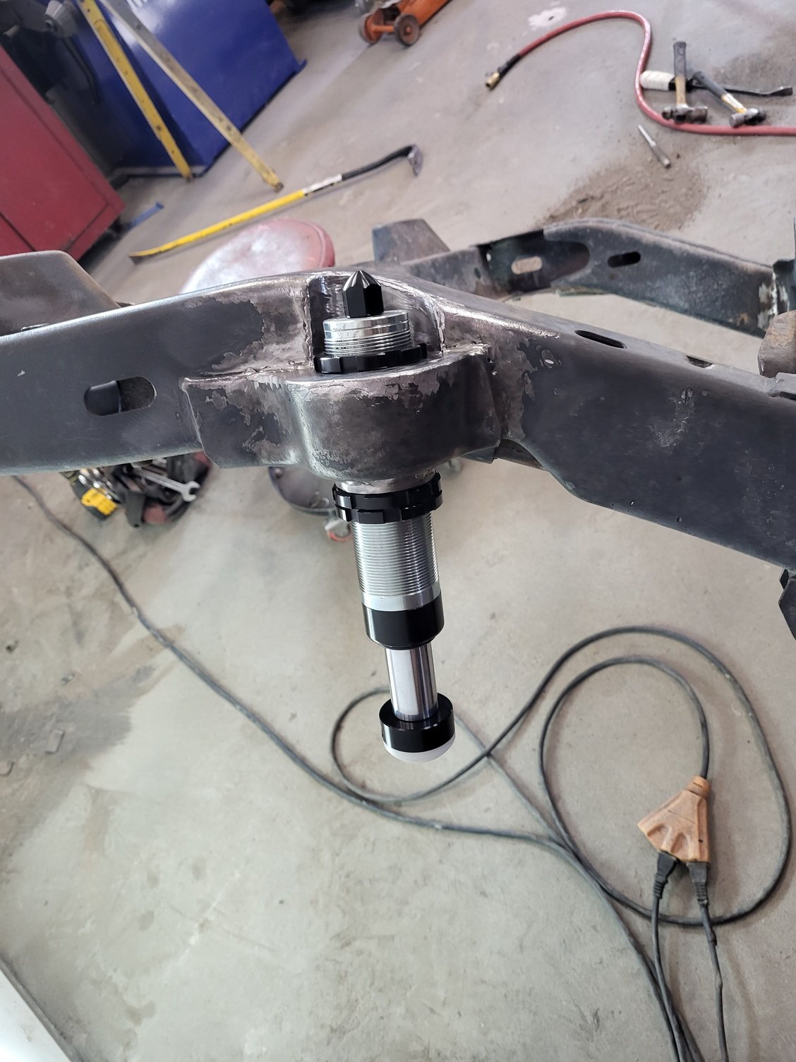

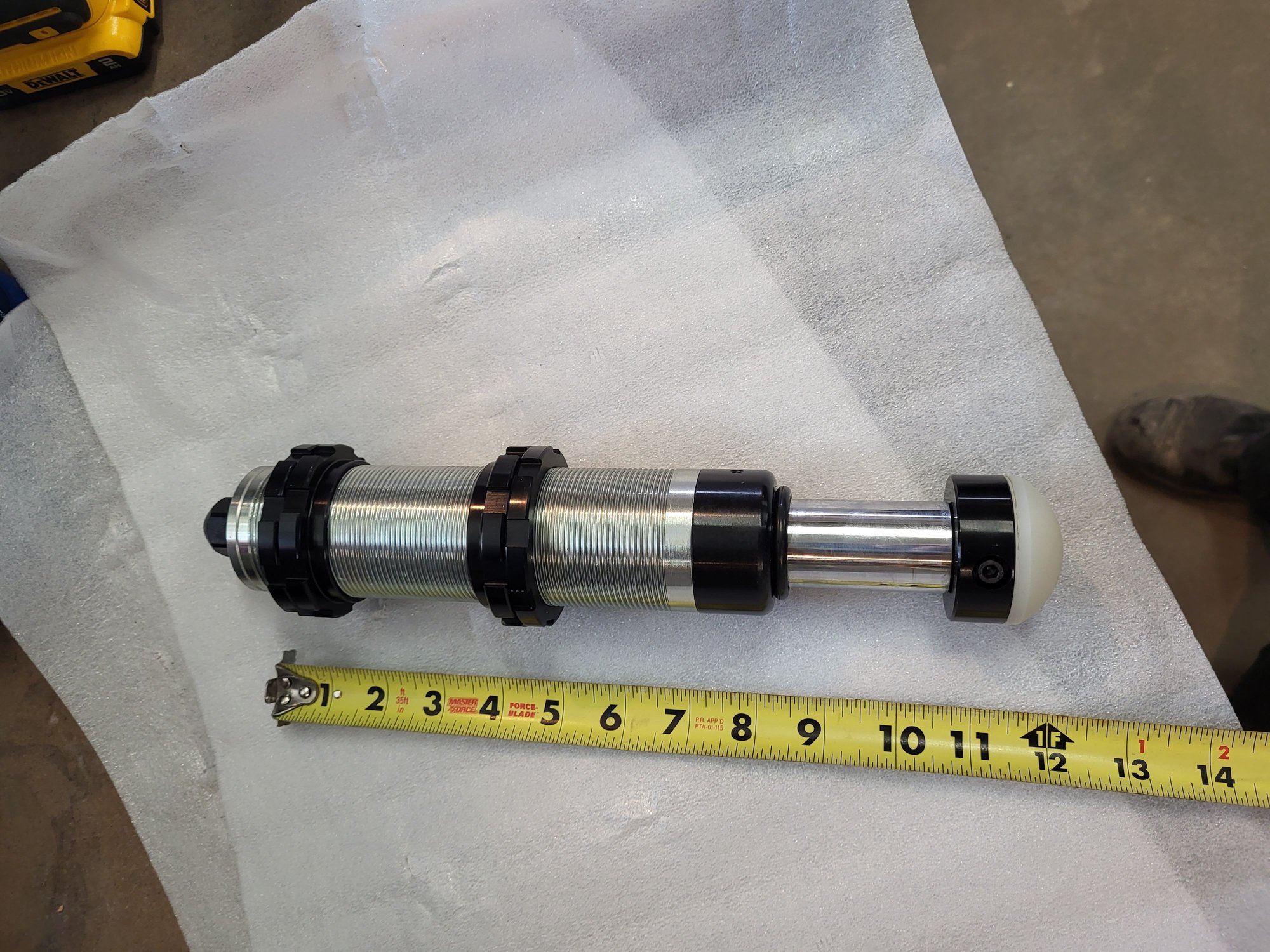

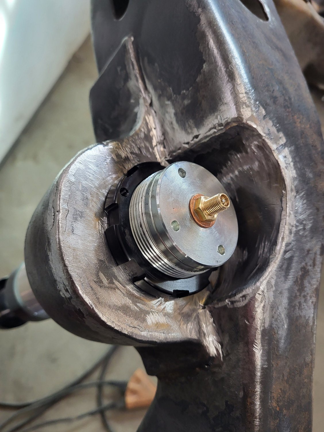

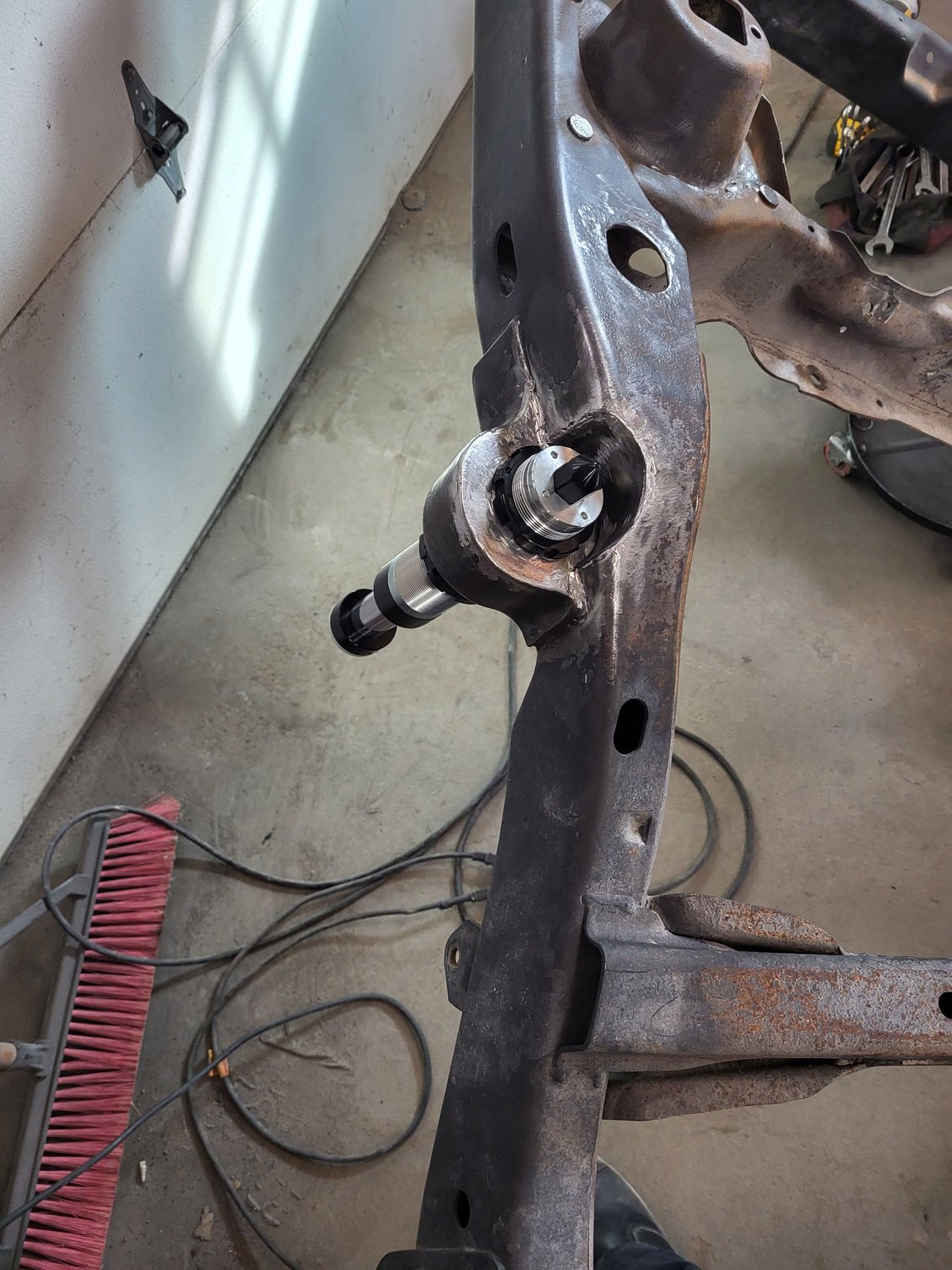

For the lifted trucks out there. I found a hydraulic bump stop that is internal and externally adjustable.

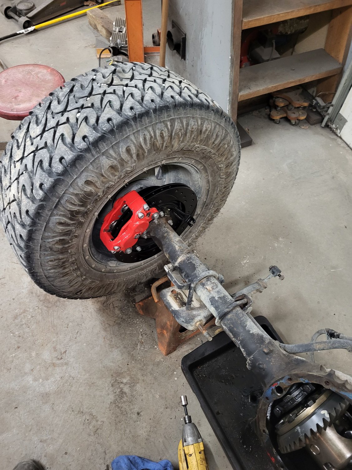

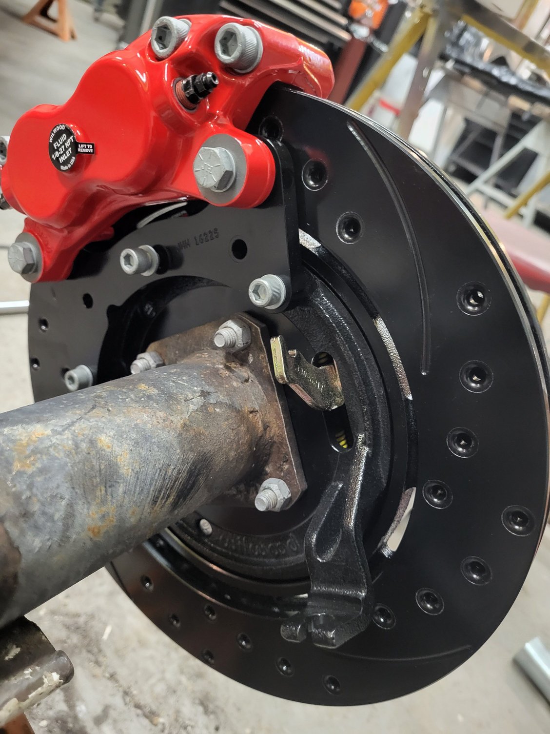

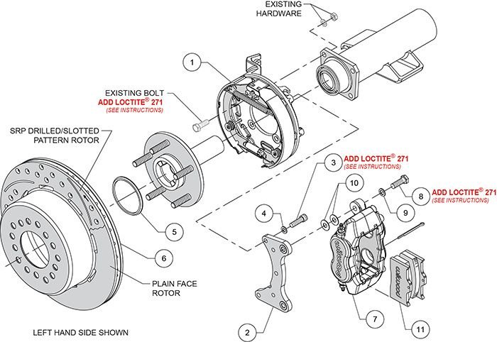

Also going with the Wilwood rear disk conversion. Sharing as I was not aware they made such a clean set. they incorporate the e-brake with a drum inside the rotor. Check them out. I still need to take the axel out to measure the axel flange to order the correct set.

Sent the frame to get sandblasted and powder coated. the rear brake conversion came in today and I mocked it up to make sure everything fits and was included inside the kit. I really like it compared to the other kits with external e-brake mechanicals on the outside. the drawbacks are price and the need for shim washers (came with the kit) to center the calipers over the rotor. Wilwood doesn't have a matching front rotor but I found one from powerstop (AR8606XR & AR8606XL) that are really close. Matching Wilwood front caliper kit is
amazon- ‎140-12097-R amazon- ‎140-12097-R
. those are 15 " rims and clearance would be too close if not running spacers. they technically will clear but I would see rocks or other debris getting in between and causing issues.

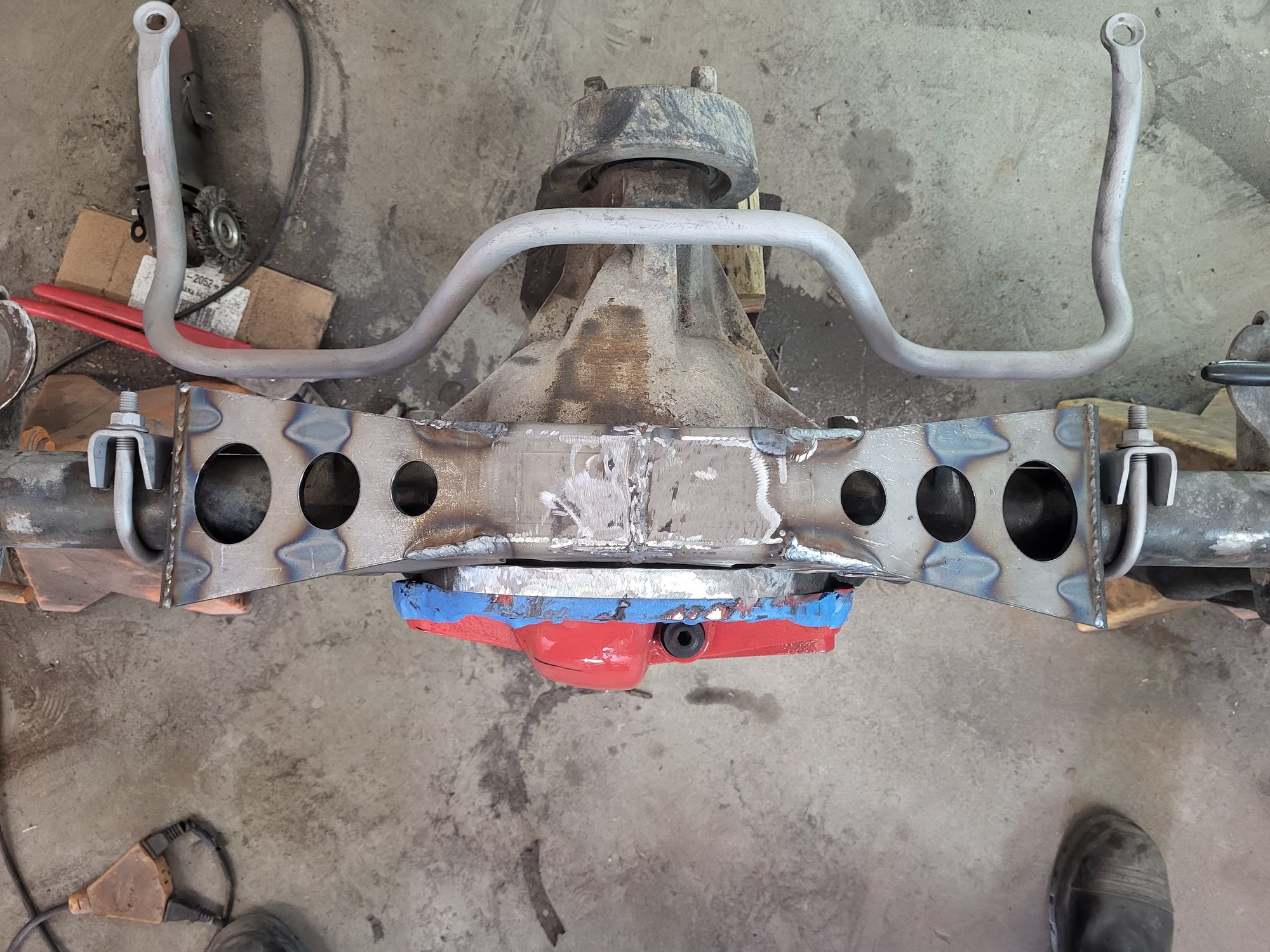

Next I have a weld on axle truss for a Dana 44 coming. I hope its not too much modifying to make it look good.

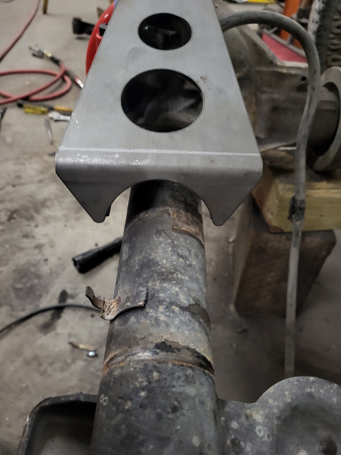

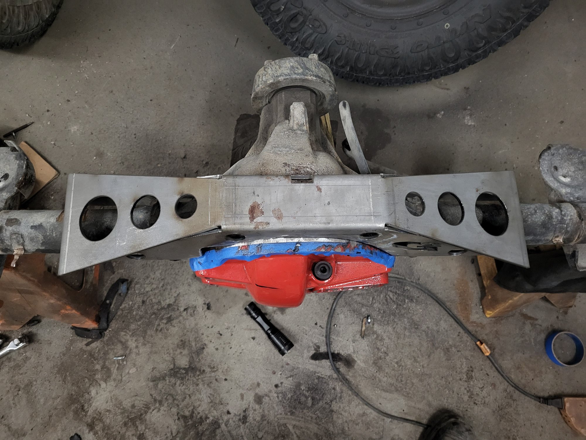

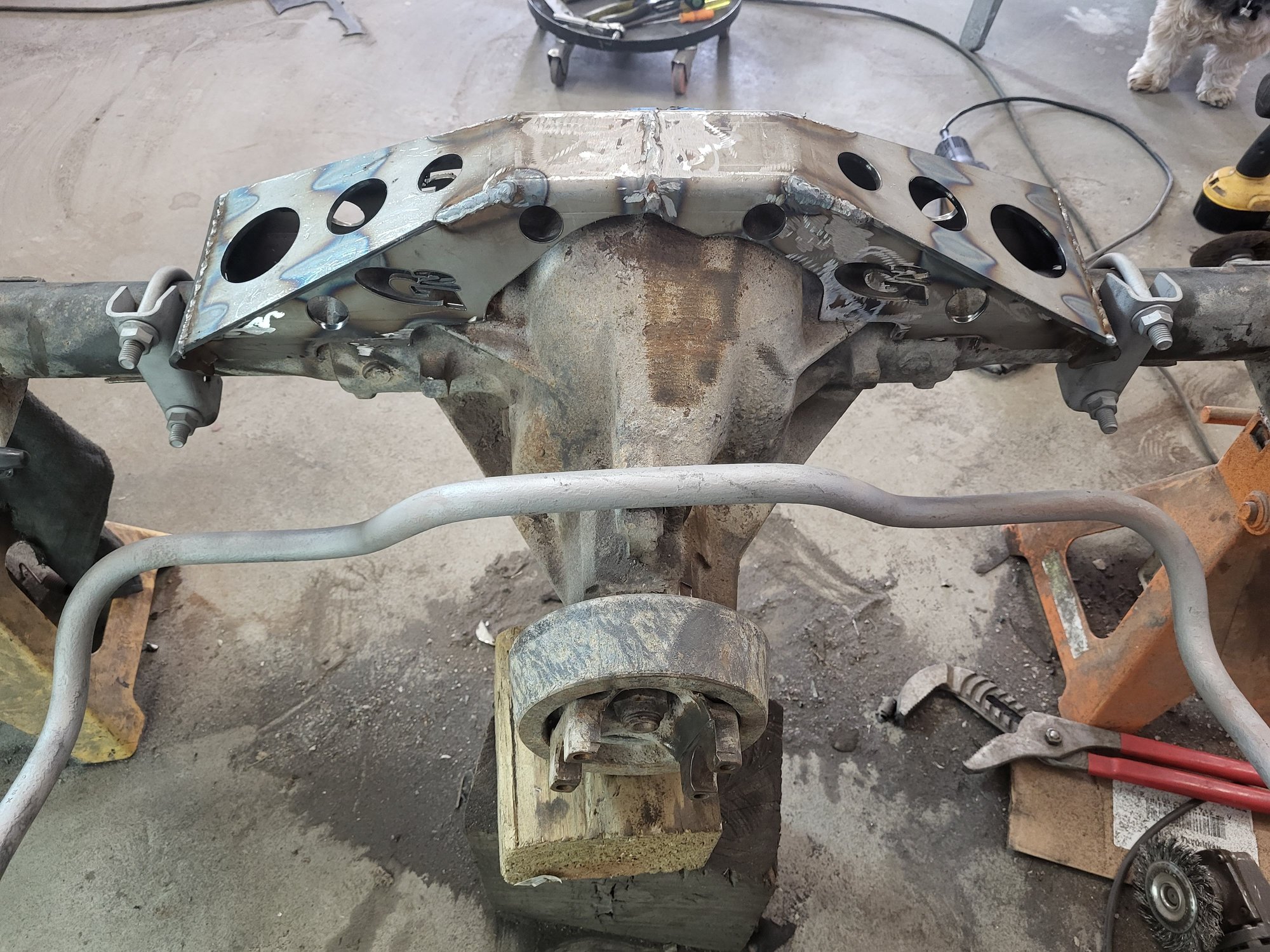

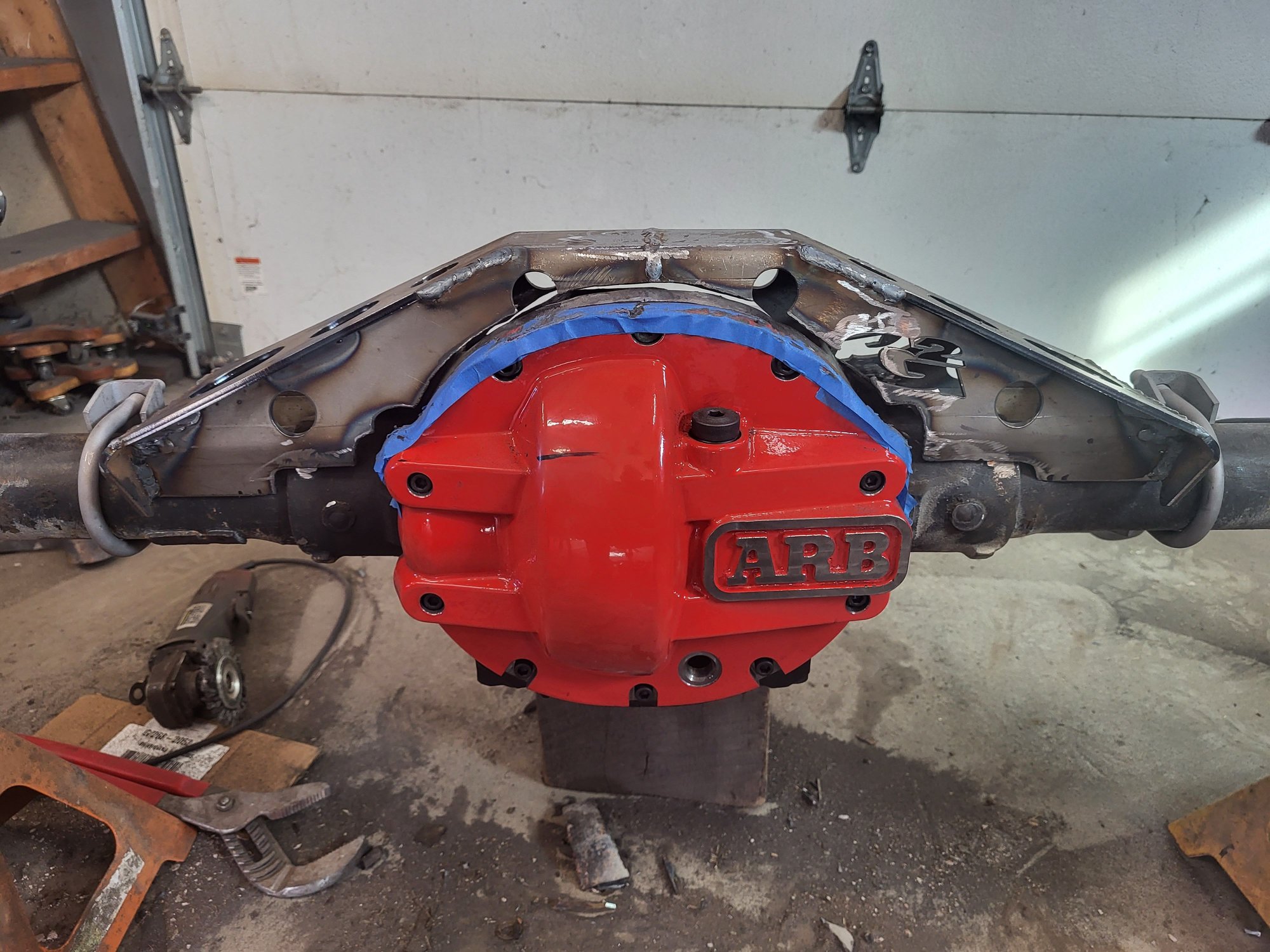

got the truss in the mail yesterday. seems like it will work with a bit of trimming. I rounded the top of the diff housing and trimmed some on the truss. I'll post the finished product once complete. the sway bar mount is right at the end of the truss so that will need to be modified as well. I'm happy that it will work and yes its mostly for looks.

cut to fit.
