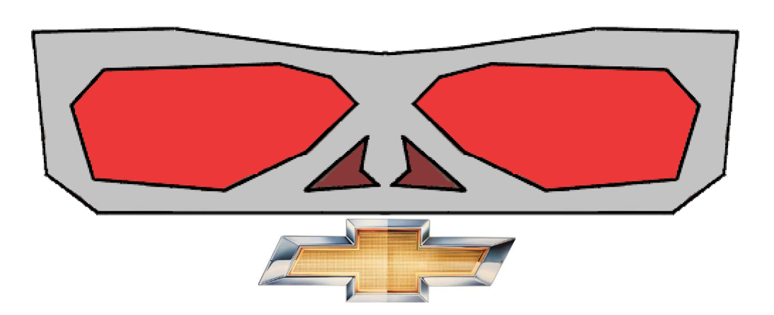

Originally Posted by DonL
Looking really good... I'm liking the grill design, looking forward to seeing how you form it around the winch tho lol
The grill might be the most challenging fab work i have done in a simple garage/shop. I might need some more sheet metal. I'm running out of welding gas too. I don't have a tig welder yet but might have to see about getting one to do the grill.
