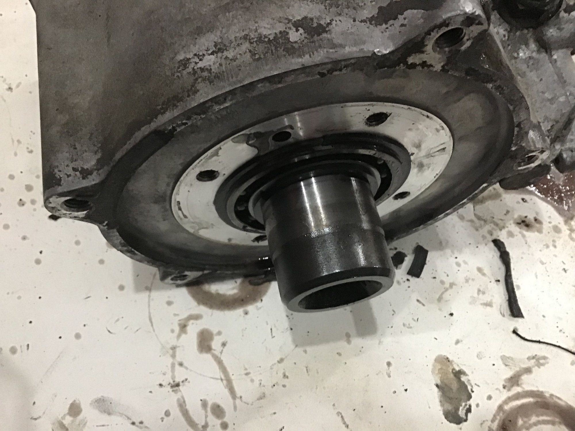

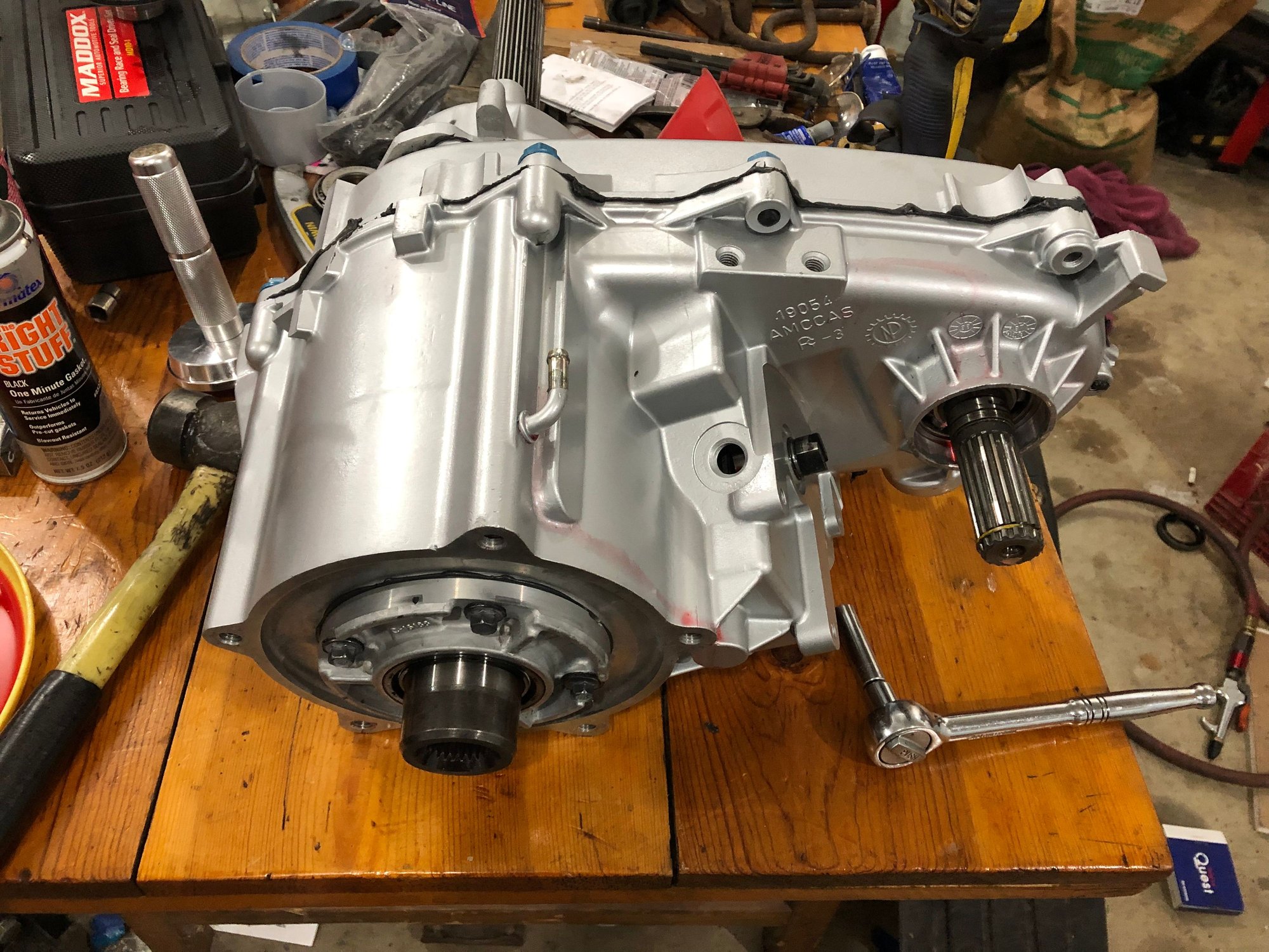

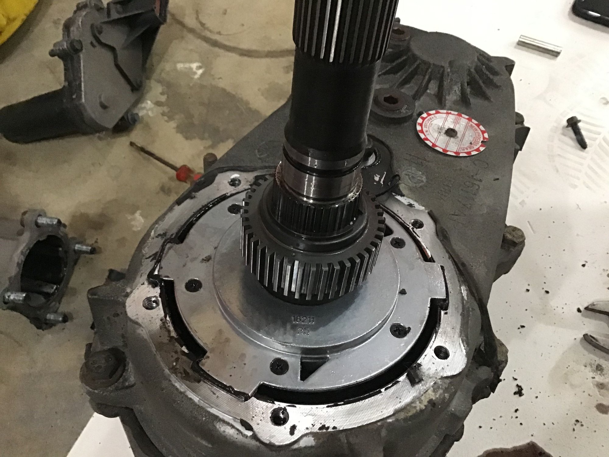

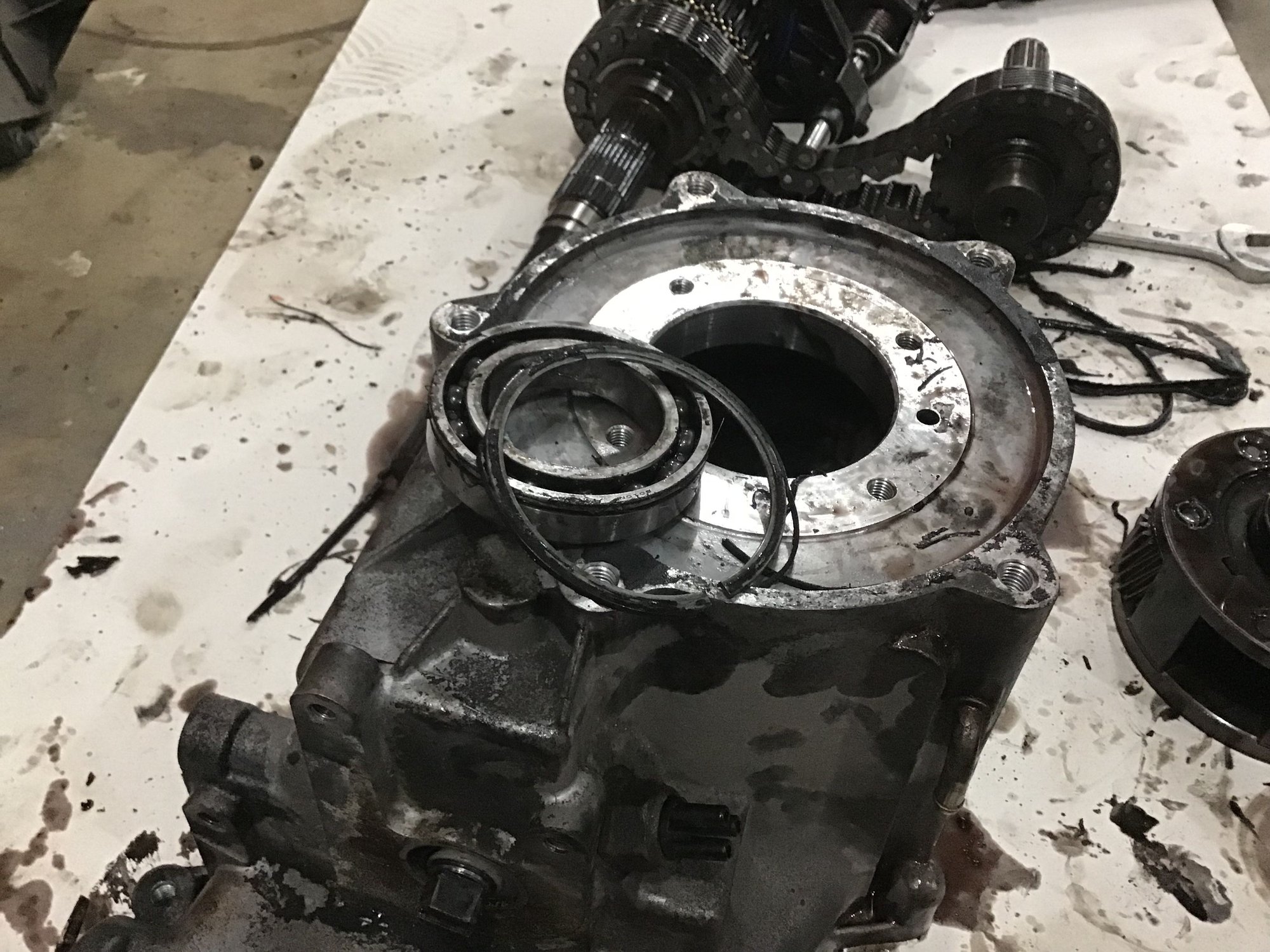

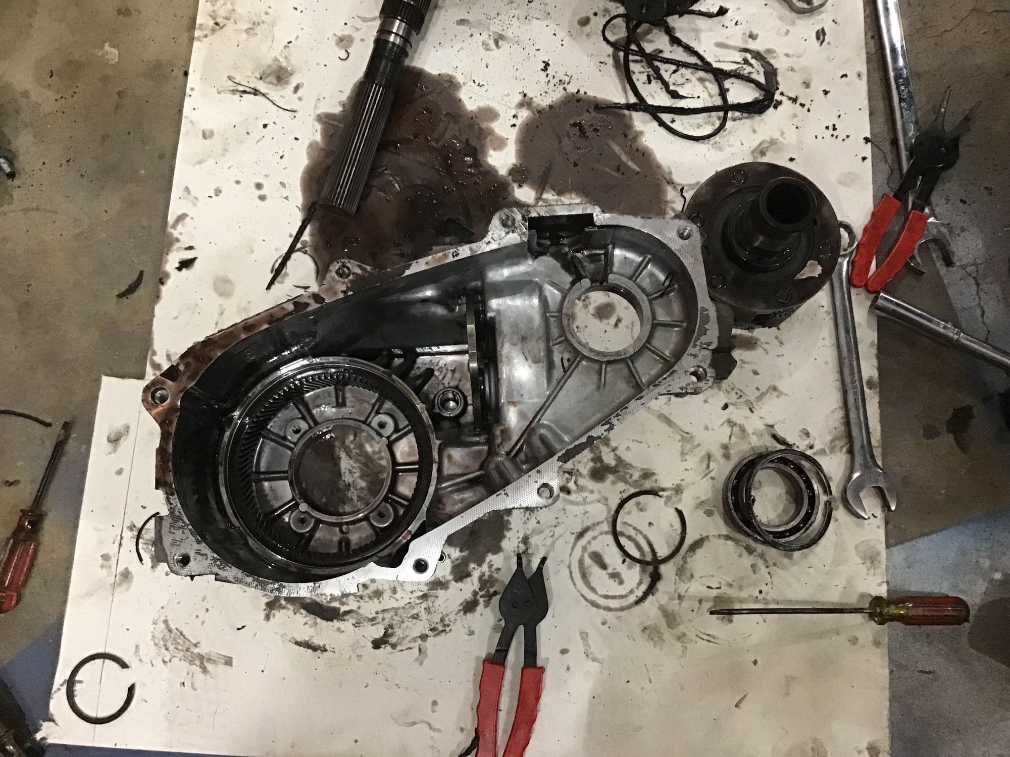

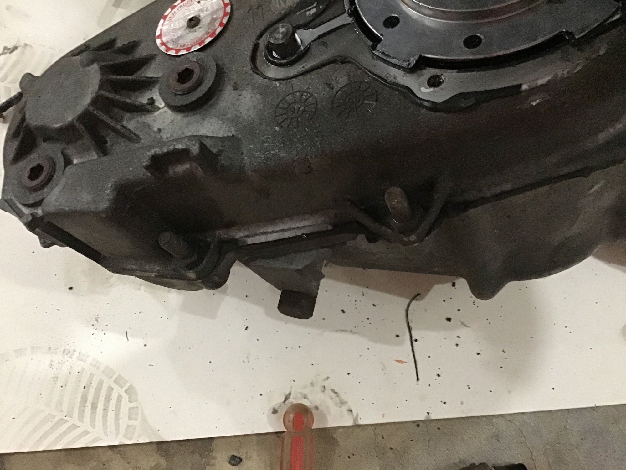

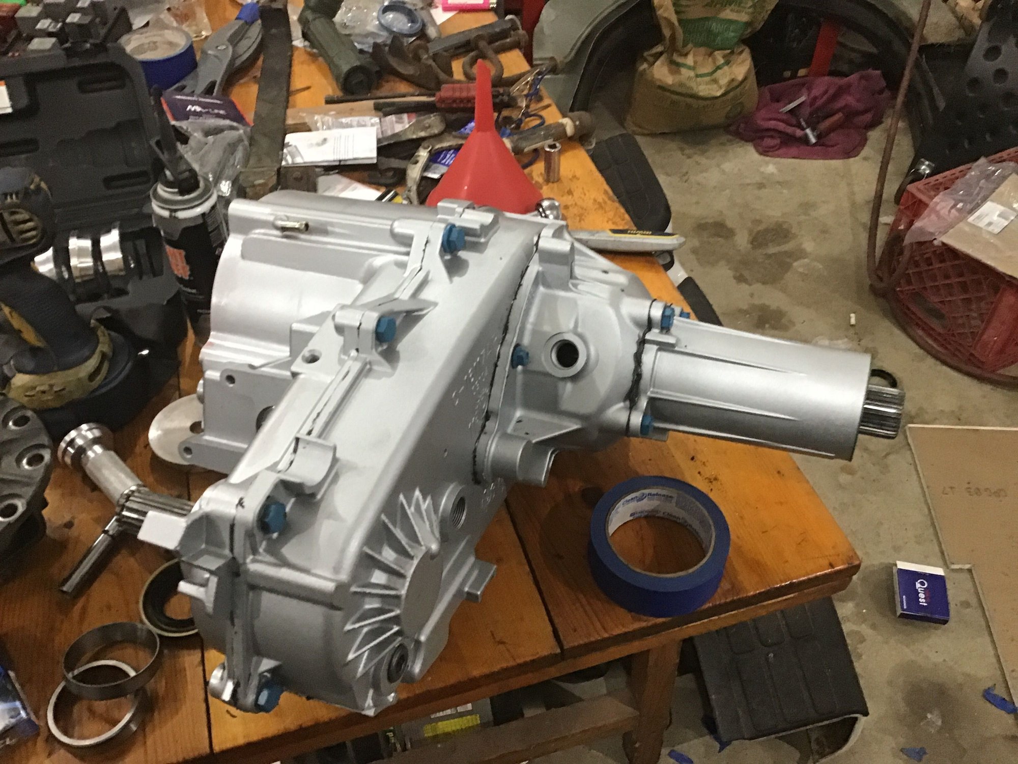

Well guys tonight I reassembled the tcase. Ruined my favorite shoes with trans fluid. I also made a mistake assembling and forgot that there was a lock ring on the front output shaft so I have to go pick up another seal for it. Was thinking of getting the oil whip seal for the rear output but since I have to buy a front seal now and I’m way over budget I think I’ll throw the tail housing on tomorrow . Also my front locker came in from Eshaw (thanks Eshaw) so I plan on installing the locker tomorrow as well. Can’t finish that as I’m having issues finding the inner pinion bearing for the front differential. Here’s some pics I will trim the excess silicone tomorrow.

Looks like you have the good 6 pinion planetary carrier for the trans case. Is the chain a one and a quarter inch wide one also or did you notice?

Thats what i thought to when i started doing research on the rebuild, but when i actually checked its the 3 pinion planetary and the 1" tcase chain. I did replace the chain and all the bearings . For the cost of the revuild kit i didnt see the point in just replacing the front seal that was bad. . Glad i did cause as nasty as the trans fluid was that was leaking from trans im not sure how long that case would of lasted.

Well I got the tail housing installed tonight and the lunchbox installed. Again thanks Eshaw for the locker. Just a note I was almost had to order shims for the lunchbox
