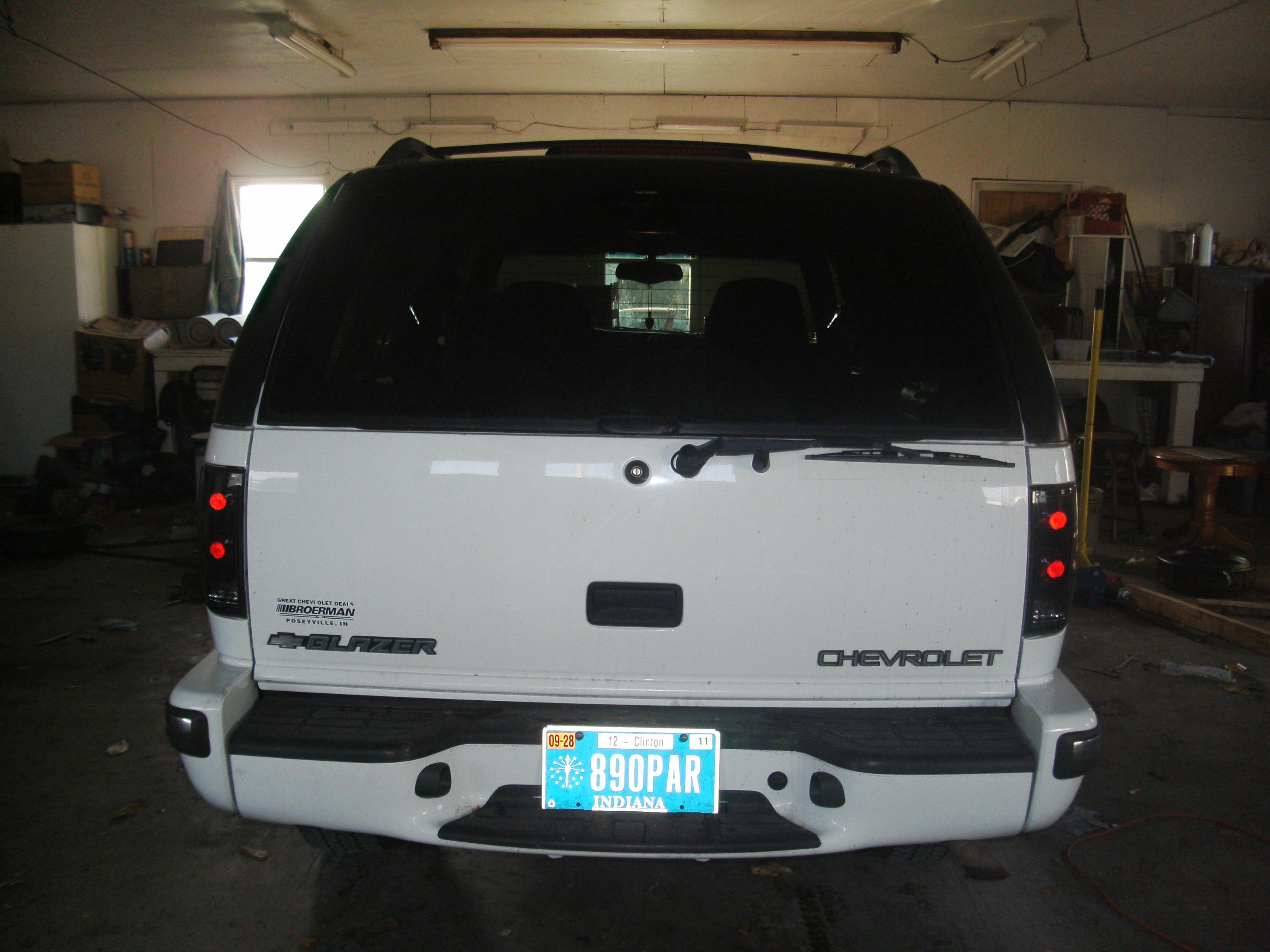

i also put new head and tail lights in just for style

i wanted to detail this build as much as possible but the wife took her camera back because she didnt want it all greeay lol but here is a couple tear down pics
