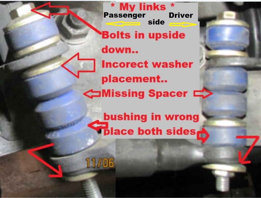

HOLD UP ....WTF... I just noticed I am also missing a spacer on links...
A BIG SHOUT OUT TO chevyriders for initially catching this .
Originally Posted by chevyriders
Just noticed in a pic you had, sway bar links aren't installed properly. Not trying to hassle you about it. But will improve ride quality and safety if installed correctly
AND...To newguy
Originally Posted by newguy
yeah those are wrong. rubber bushing on each side of mount with washer on outside of them
As newguy pointed out Bushings are not in correct order.....WTF

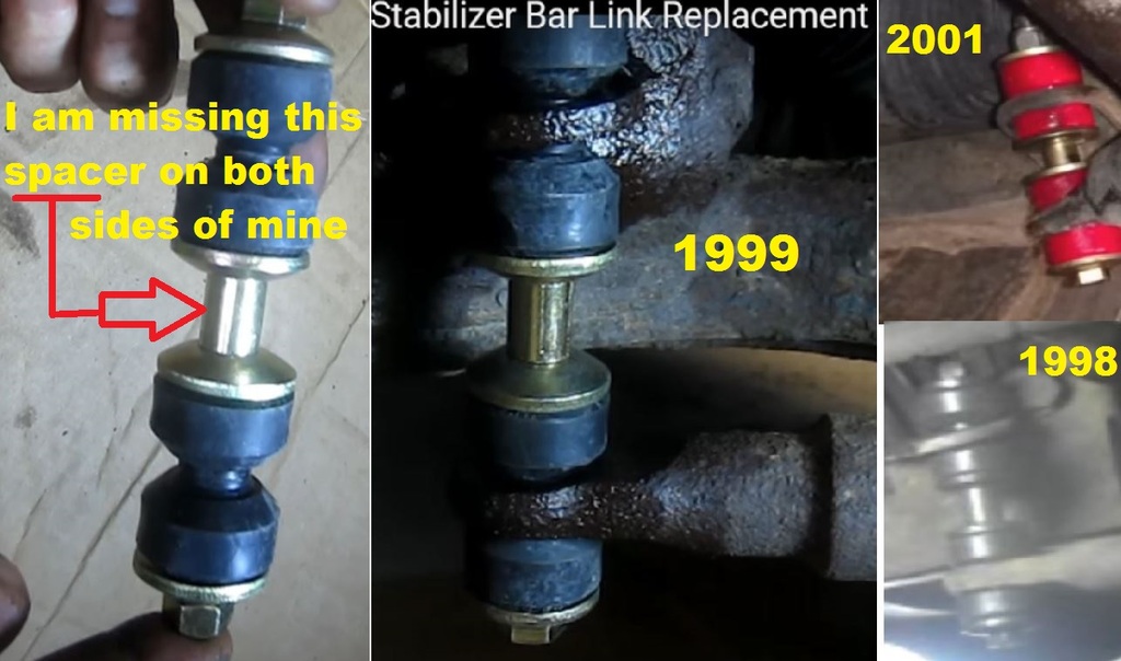

I checked other years and they all have this spacer....(see pic below)
Is there a reason I don't...other than ..
SAY IT AINT SO...The shop forgot them...??

.. New Flash..
After looking into this all day, then taking a 5 hour Nap.

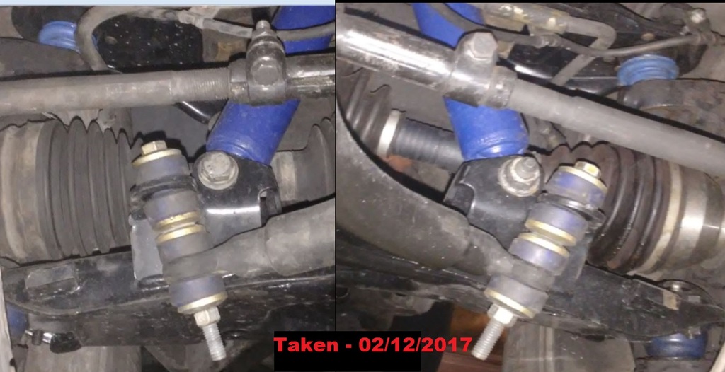

....It just dawned on me.. The above photos were taken between June and Nov..
I had the entire front end replaced December 20'th....
Ding ding..Ran down and snapped some pics....
The bushings and washers are correct now....
The only thing is bolts are upside down ..And the no spacer issue....
New pic below
I remember also they fired the guy that did my front end 2 wks after i bought it back in June..

I would say that the shop owes you a correctly installed set of end links or a bit of a refund. The link kits are $10.39 from Advance (less if you use a coupon code) and they come with everything needed, including the spacers. They are also very easy to install.
