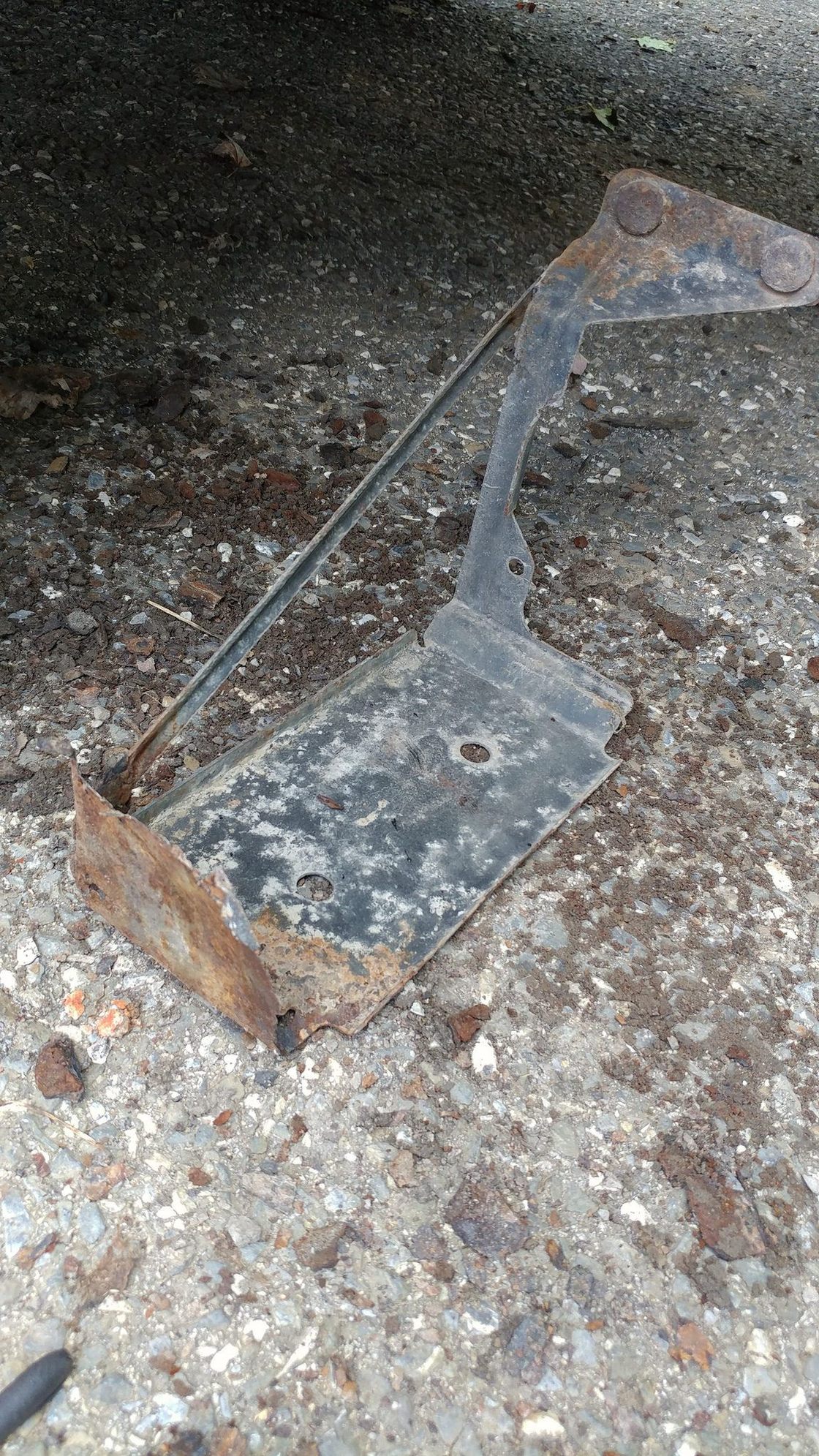

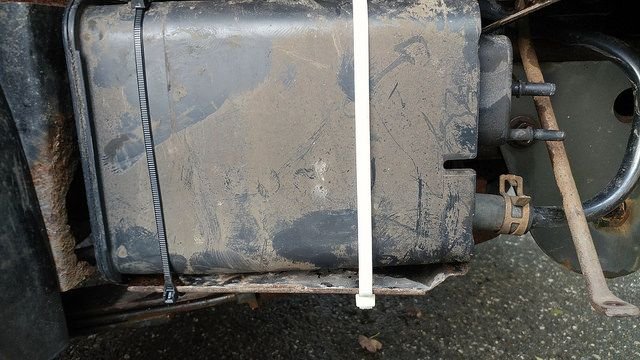

I was out and about yesterday and on one of my stops I came out to the blazer to see my charcoal canister hanging down below my bumper. So I shoved it up into my bumper and left. I did notice that he rear section didn't have the nuts to hold it in. I swear, whoever owned this thing before me.... I took the bumper end cap off and this is what I found.
I bolted it up and decided to fix it.
I want to eventually find a new bracket, but for now zip ties FTW.
Now, onto the second part of this issue. I have had a PO440 code for a long time now. I think I may have just found my issue.
Yup, they were only connected to the charcoal canister. Here is the other end
The lines are actually pretty solid a few inches further up. However, these things are shot.
Now, I need to figure out how to fix this.

Since I have a couple of days off I figured I would tackle these fuel lines. I went to advance and got some 1/4 and 5/16 brake lines. I also got a small pipe cutter. They didn't have any fuel line but my dad had some so I was good there. Cut these pieces off, the smaller line was still rusty where I cut it but it was just surface, it was still pretty solid.
Test fitting
All done. I didn't plan on needing 6 hose clamps and only bought 4 pack of fuel line clamps. So I used 2 regular hose clamps but it seems plenty strong.
Since i had it out, I found and old heat shield and flattened it out to make a piece to weld onto the canister bracket. My dad had some blue engine paint sitting around so I painted it because I could. I tried to get pictures but my flash got turned on and most of them are too washed out. I didn't feel like taking the bumper end back off just for pictures.
The canister still didn't fit quite right so, zip ties again.
Hopefully that keeps the engine light from coming back on.
