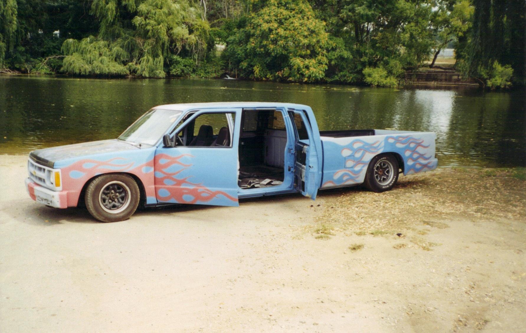

been there done that back in '99. took a '84 ext cab Dime, and made it into a crew cab, ext cab long box. the last pic is just to show that it was drivable.
Wow Nice!!

thanks. too bad the friend that it was being built for, didn't follow through with it. the pic's were taken @ the Battle Creek show in September of '99. Mini Truckin' was taking pic's for the 'Under Construction' section of their mag, when my brother snapped the 1st two pic's as i was talking to the Editor. thw truck came apart for the final work over the Winter, but he never went forward after we body dropped it. now it's sitting in a friend's barn-in pieces.
