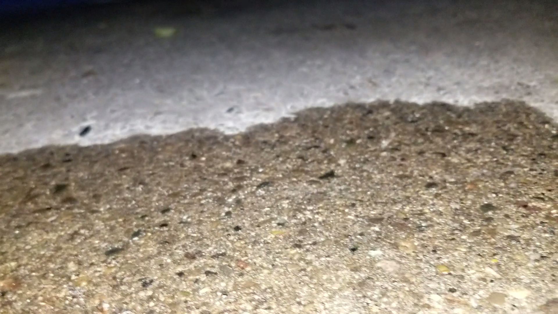

i noticed a puddle on the ground as the car has been sitting since Thursday.
Will post better pictures in the morning. It looks like engine oil, and when I wiped the ground, it comes up brown. Seems to me like engine oil. Not sure if my shift linkage seal is leaking or what. My shifter does need to be adjusted slightly.. lol. Any thoughts?

The picture of the leak above - It seems to have stopped after fixing the oil cooler line leak. Must have just been blowing all over everything.
