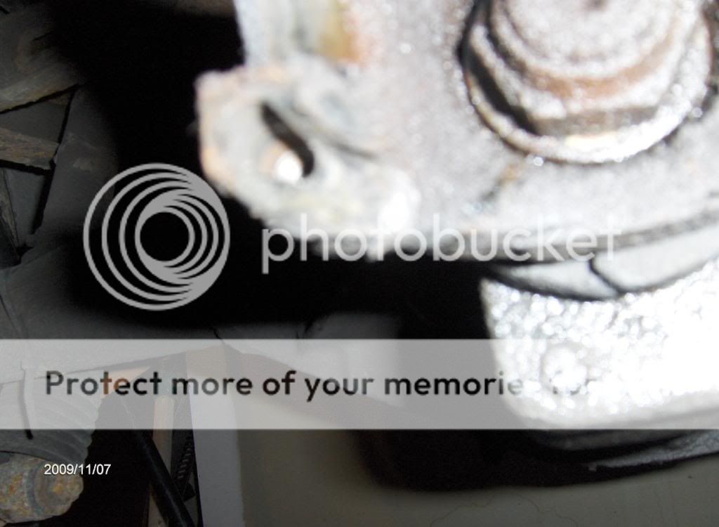

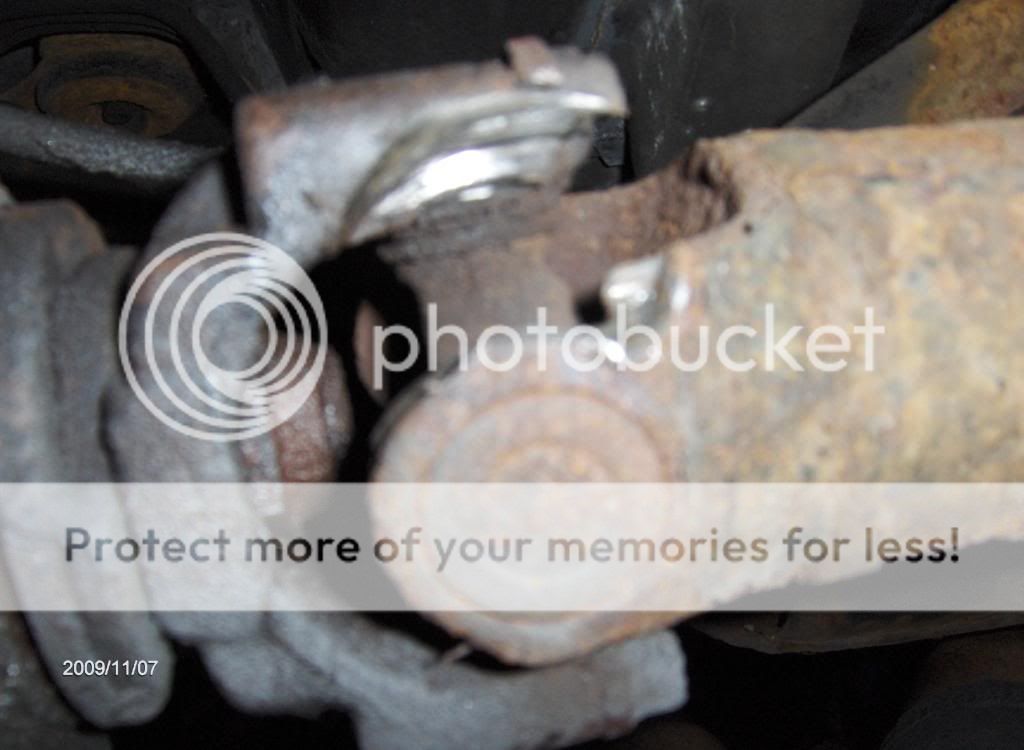

So far I've just got the case out of the truck, and I put them side by side to compare. As far as case removal, it's pretty straight forward. Only thing that really held me up was the constant dripping of ATF (needing to tend to it) and the fuel line clamp at the very top of the T-case.
OK, so besides the obvious length difference in the tailshaft, there are actually quite a few differences. This is not a direct bolt in swap. The 231 I have is for a gear driven speedometer cable, while the 233 from my '94 uses a Vehicle Speed Sensor. Also, it can't be seen in the picture, but my current driveshaft will not work with the output shaft of the 231 the way it sits. The output shaft is too small on the 231. So, at the very least I'll have to swap the output shaft with the housing and the vehicle speed sensor stuff. I'll take pictures as I go.
