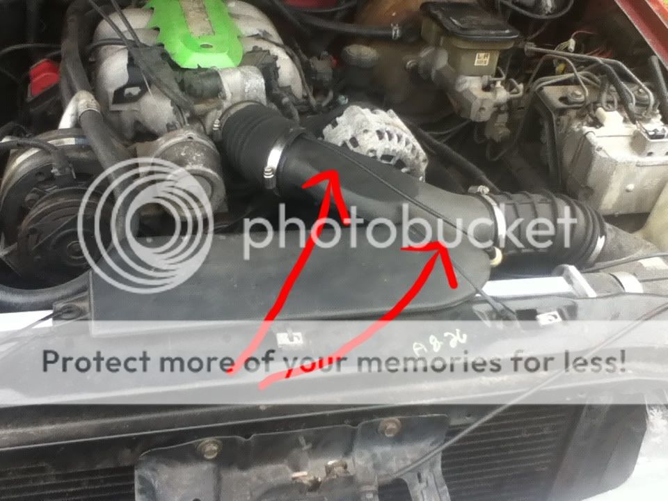

So while I'm waiting to gather the money for all the parts I want, I'm tugging at all the strings trying to find out what else is wrong with this truck. One of the things I noticed early on that didn't make sense to me was this plastic line that I couldn't identify, leading from somewhere below where the air cleaner assembly attaches to the core support and into the air cleaner duct itself beneath one of the clamps thus:
What is that thing? What is its purpose? I got tired of wondering and temporarily removed the air cleaner assembly to find the answer. And the answer, my friends, is that it's the front windshield washer fluid line. Finding this out, I yanked it out of the air cleaner hose. It was only tucked in about an inch or so. Since as I pointed out earlier the under-hood washer tubing is all missing, I initially figured that the junkyard replacement hood didn't have the necessary hose, and rather than leave the feeder hose loose under the hood to flop around and get caught up in something (or whatever), the tip of the hose was tucked into the air cleaner duct just to secure it. Dumb, but whatever. Obviously the washer fluid reservoir was no longer intended to serve the function it was designed for, because I found the rear washer feeder hose snipped for no other discernible reason and capped off with a screw close to the pump.
But then something occurred to me. If you remember earlier in the thread, I mentioned that the previous owner's wife happened to remark that the owner had a "trick" to starting the truck - running the washer pump for a few seconds. At the time I dismissed this as nonsense, because there's simply no possible way that running the windshield washer can have any effect on starting the engine whatsoever. And that's true, assuming the windshield washer apparatus is connected the way it's supposed to be.
But now it does make sense. The owner's "trick" worked because he had rigged his windshield washer pump to inject something into the air intake. But what?
I suppose he might've been keeping starting fluid or ether in his washer fluid tank; but surely it would evaporate too quickly to be useful wouldn't it? What else might he have been using? The owner's father mentioned he raced; when I bought the vehicle there was a performance intake tube laying in the back seat. Is there any kind of fluid substance a racer might want to inject into his air intake during a race (or any other time)? And what could any of the possibilities have been doing to my poor engine? Once started, the thing runs with no problem, but...
I haven't filled my washer fluid tank yet since buying the truck, and it's a damn good thing too, because while trying to get it to work I would've been spraying windshield washer fluid into my intake. Imagine the damage that may have been caused. Grrr...

All right so, it's been over a year, what have I gotten done? Well, not as much as I hoped to have gotten done by this point. But I did get a few things done - a couple of which were mentioned in other threads, but some not. To recap, so far:
New (used) power brake booster, and new LF brake line (had a hole).
New ignition control module; old one was...old, and starting to cause some sputtering when the engine was hot.
Removed Former Owner's bizarre intake-injector setup using the windshield washer pump - someone here told me that apparently there's some performance advantage gained from squirting water into your air intake? Hey maybe, but not really my thing - this is going to be (well, IS) a daily driver and I live in a dusty area so I need the washer system more than a few more RPMs. So I reinstalled some tubing and got the front windshield washer spraying again. The rear washer line leaks somewhere near the endgate; and (a separate issue) at some point within the last couple days all my washer fluid drained right out of my tank, so that system will need a little more work yet.

So I did some research, and as far as that washer fluid-injection thing the previous owner nig rigged, it seems that water injection helps to provide a form of internal cooling to the engine. These seem like very precise units which give a fine mist of spray. The system in your jimmy is sort of like making a supercharger with an electric leafblower (
). Anyway, glad to see you fixed it up.
