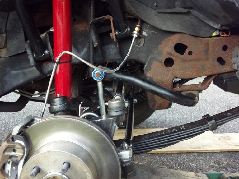

KM346 will become famous soon enough
Originally Posted by jbb421
How far forward is perfect? IDC about the cross member at this point I just want it to look right and not a hack job... Also I was planning on using the wagoneer axles sway bar @ the stock location but I'll just fab something up.
Here is my setup... i kept the cross member and used the factory mounts for a sway bar. Im running a WJ bar in the picture, but i swapped it for a modified 06 mustang bar to gain more turning radius. My truck fits 33's without rubbing...

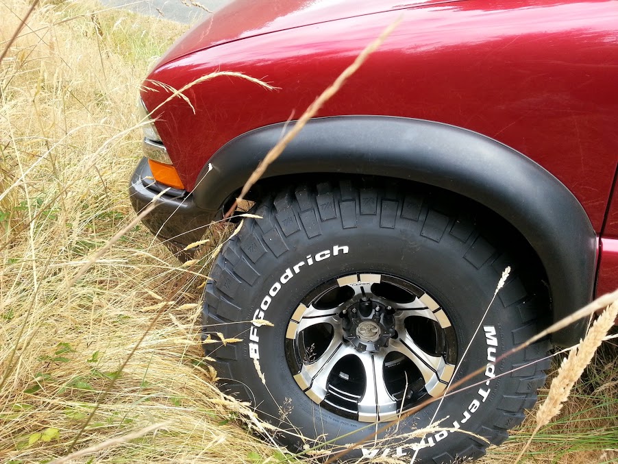

there are too many variables to have a perfect location. tire size, wheel offset, suspension travel all play a part in where you should locate it. Mine is 4" forward and it is just about perfect for 35s with high offset wheels, if i used a stock offset wheel i could have made it work with ~2" forward.
