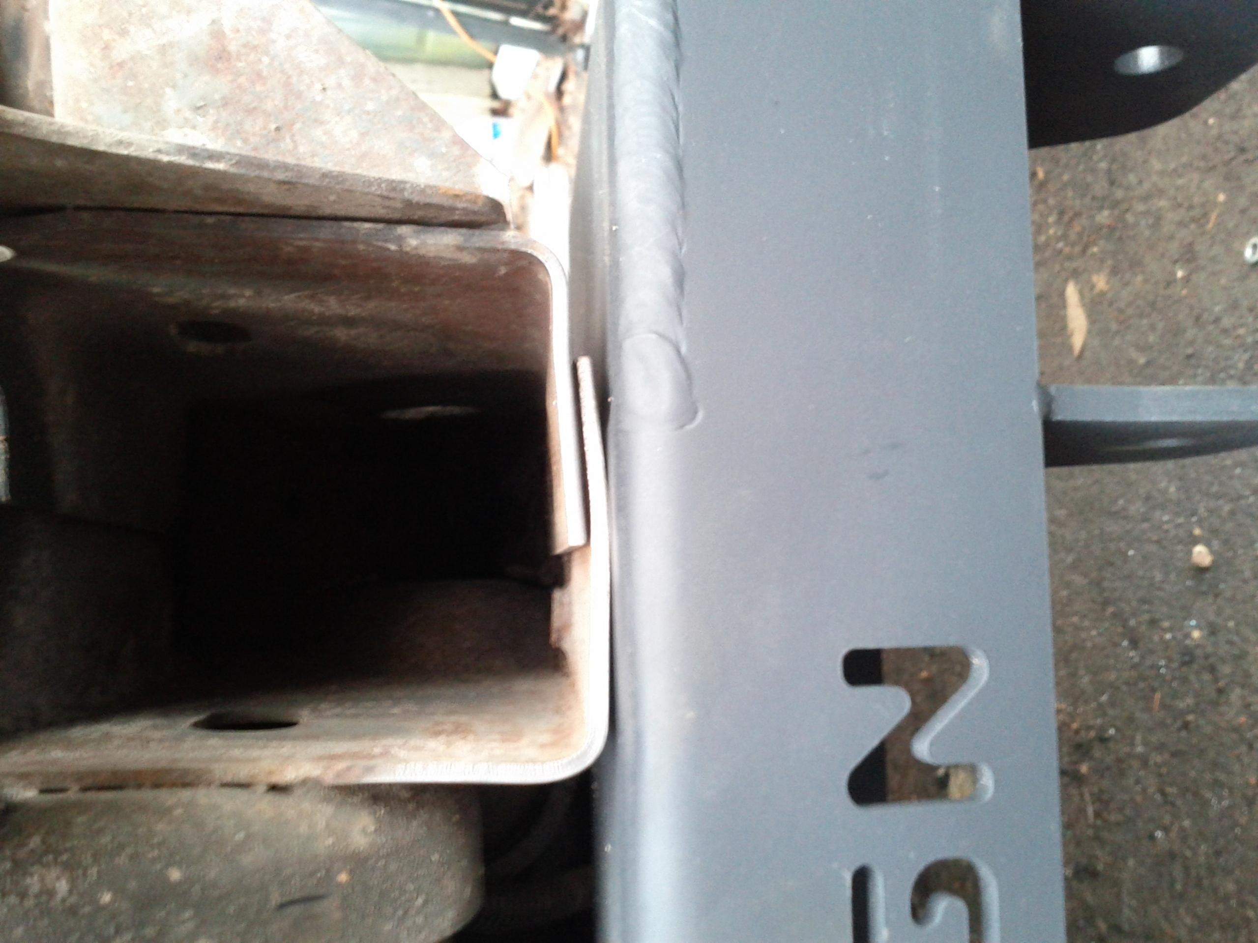

Thanks for the reply km... after talking with atv warrior i started hacking away.
I diddnt like the way that the crossmemember just sat on the frame so i notched abit of the frame out to accept the cross member, It fits so perfect now... almost like a glove... Got it tacked on and started going to town then i ran out of wire. Heres some pics like i promised thanks again guys

Looking good! You may need to trim the cross member a bit, but it looks like it'll go together well. Probably won't need histeer or an astro box, maybe just a zj pitman arm to help steering angle a bit.
Oh, and not annoyed at all, happy to help!

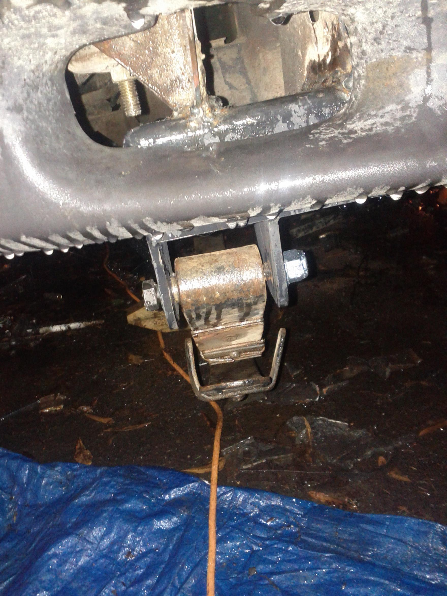

Thanks!! I am gonna do away with the cross member its just more junk in the way Lol. I do have another question tho the spring mounts on the sky cross member are 3inch is it okay that I'm using 2.5 inch springs? On their site it says to use 2.5 inch springs, but there is quite abit of play.

your springs 2 1/2" with the bushing in, or 3"? you shouldn't have any play, it needs to be a tight fit, or you will have issues.

My springs are 2.5 all the way up on both ends.... heres what the bushings look like. Buy Moog Leaf Spring Bushing SB371 at Advance Auto Parts
they have to be replaced and ied prefer to use poly bushings, but i cant find any for them.
this pic is with bushings in.
Thanks jbb
