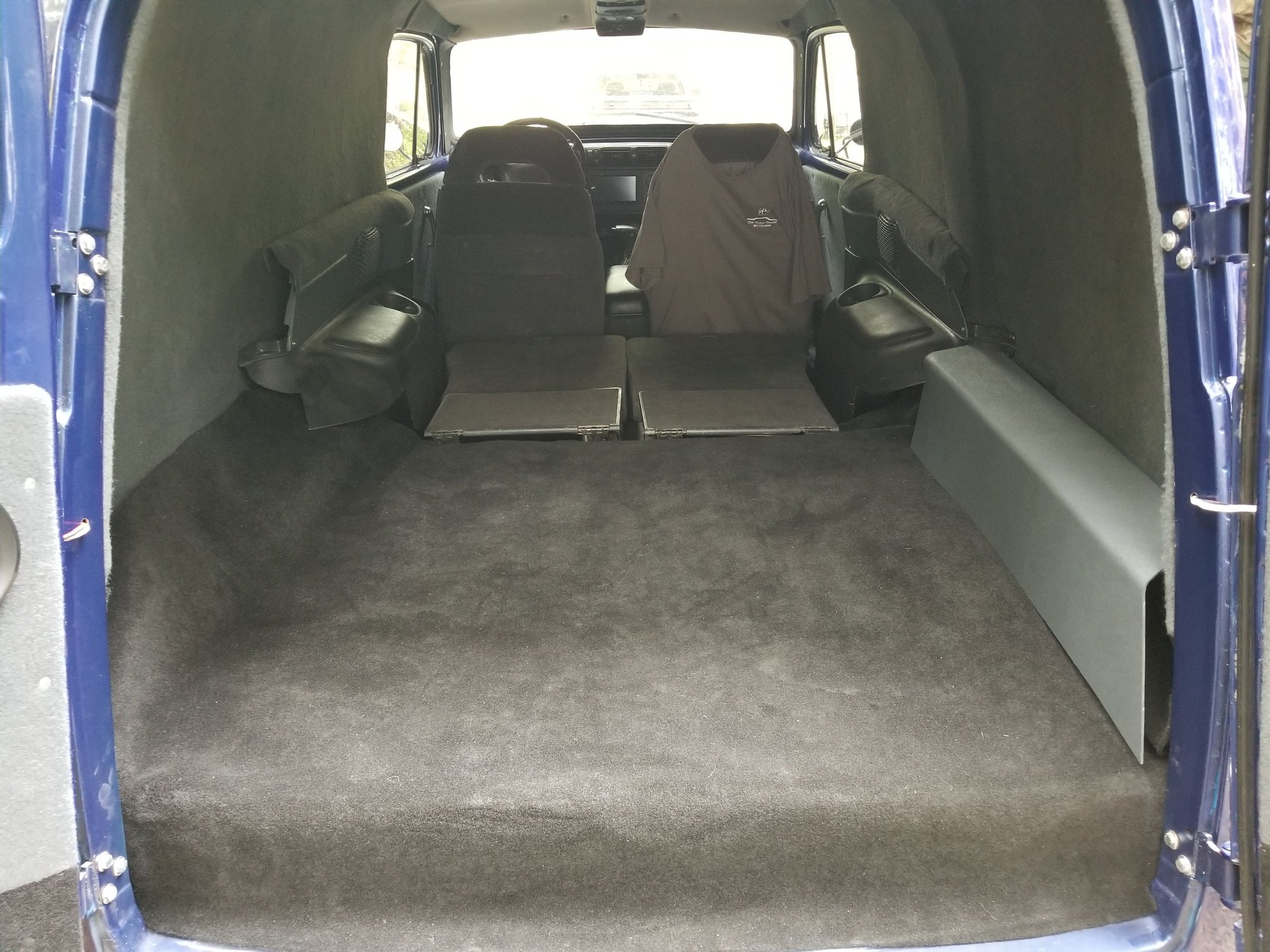

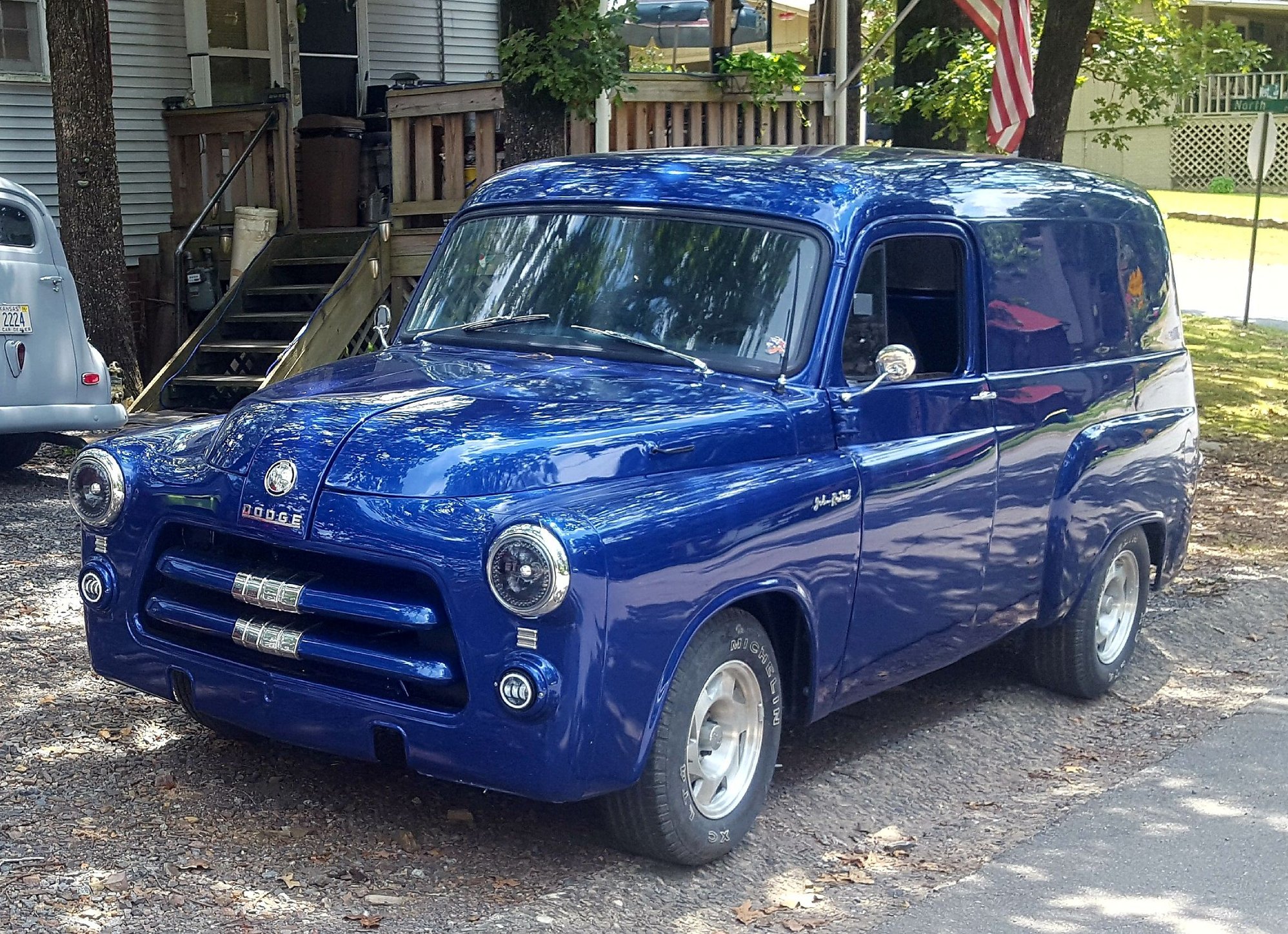

1954 dodge town panel b4 and after.
97 jimmy complete hiding underneath.

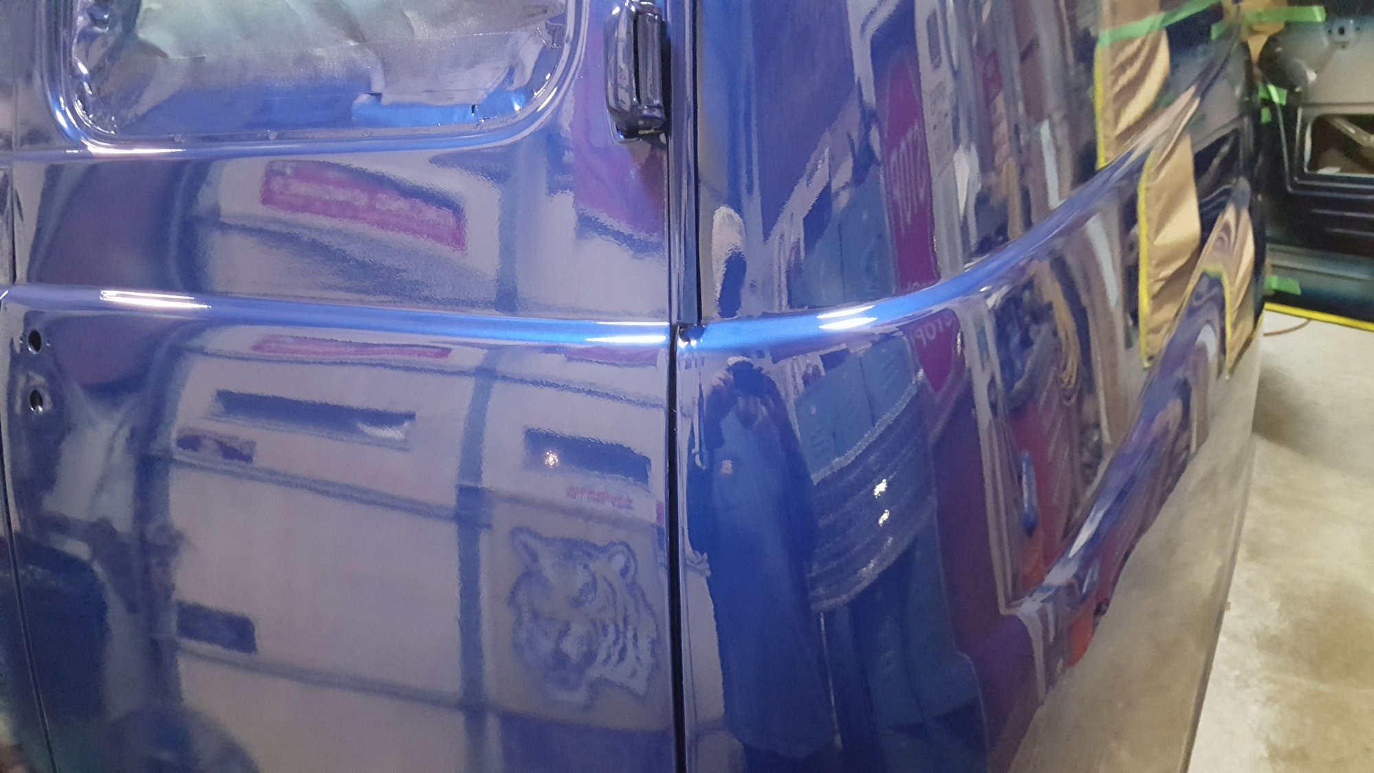

Fathom blue ice pearl. Ppg

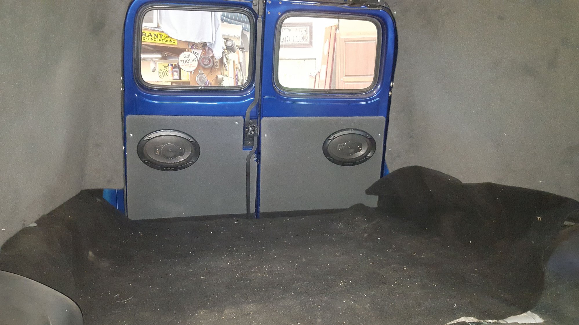

Kenwood and Rockford Fosgate in escalade headliner w/rear ac

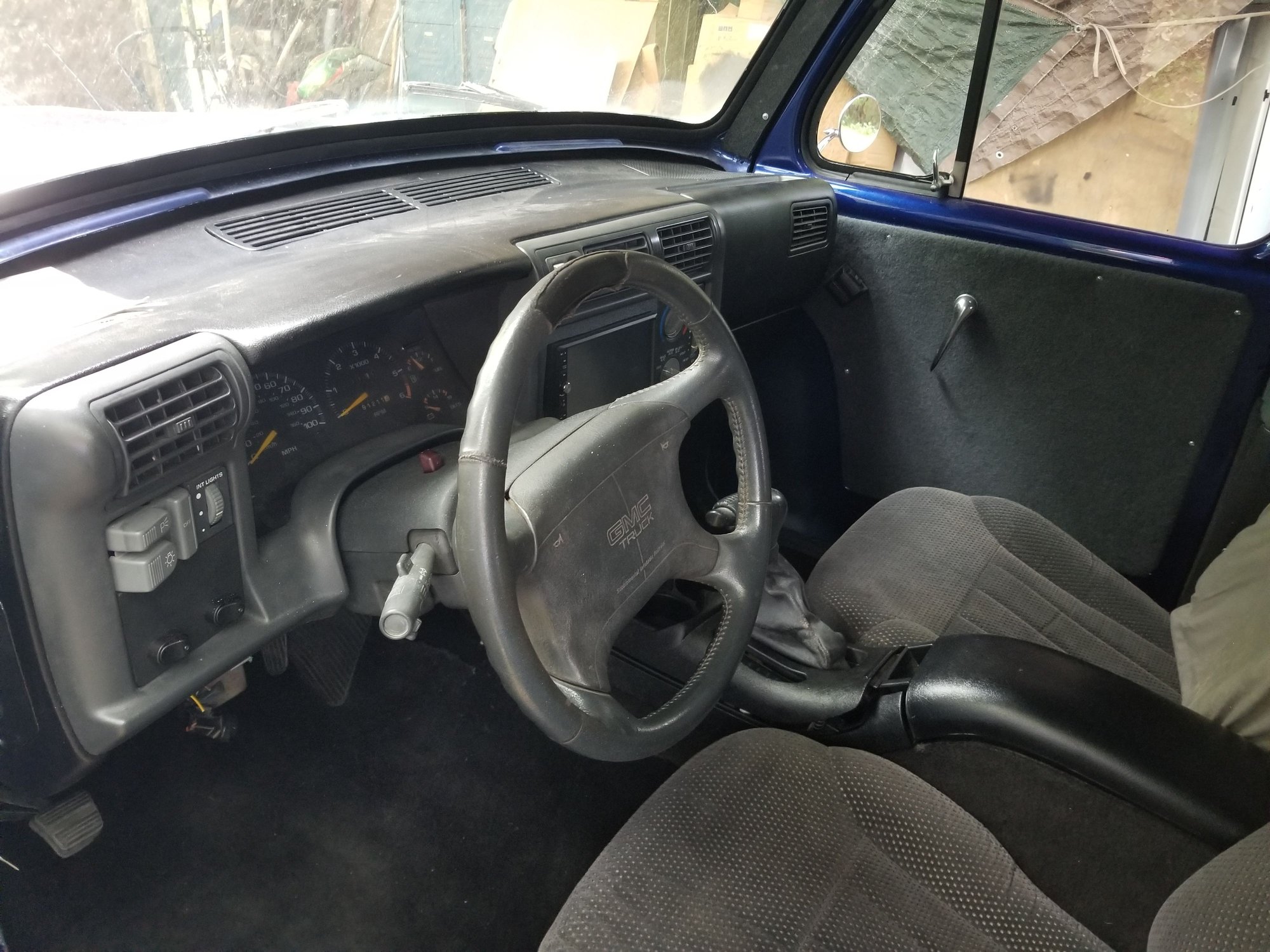

95 s10 2 dr interior
Need new steering wheel soon

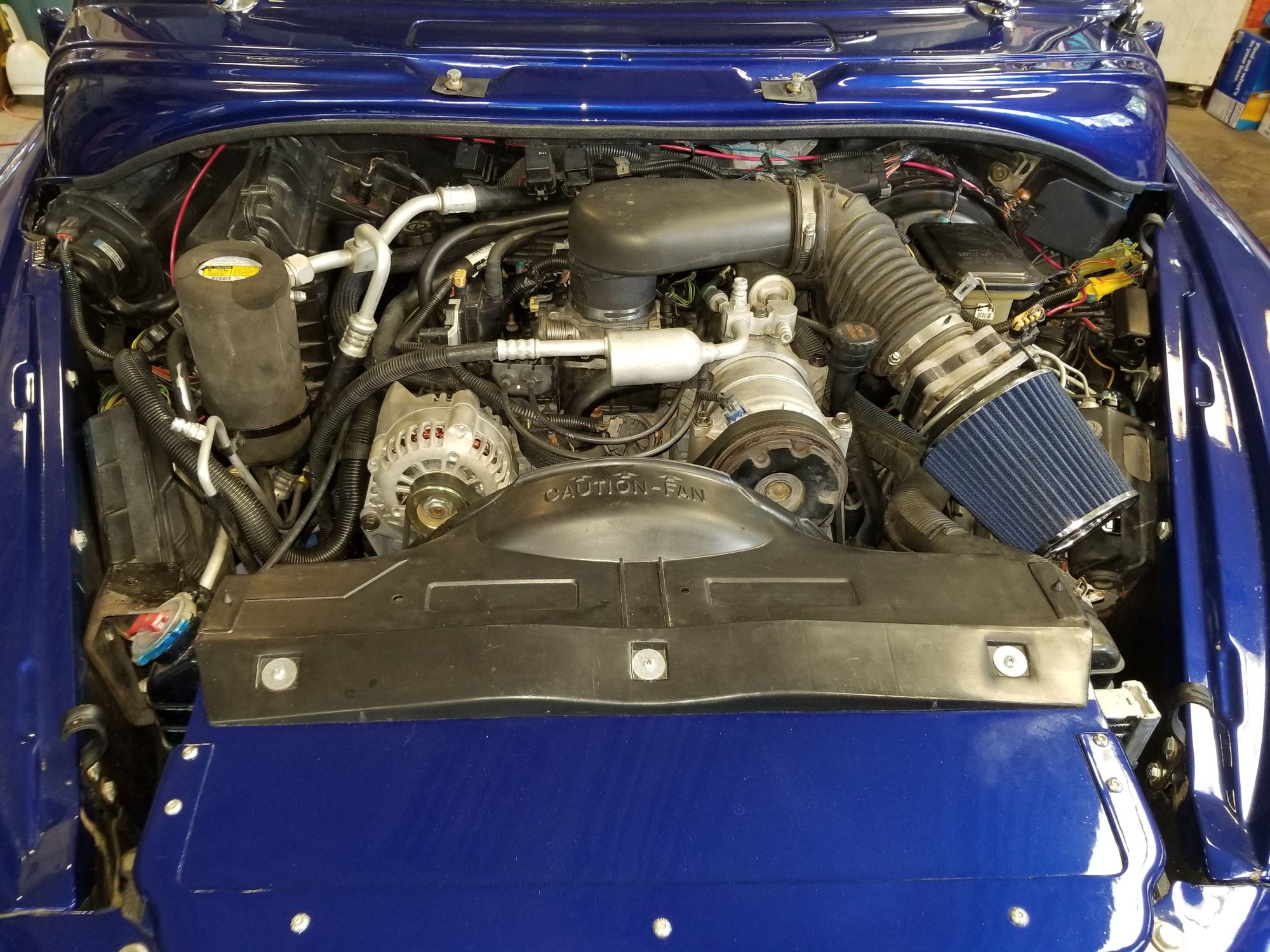

4.3L Vortec. All fresh w/trans built

Im having an oil pressure gauge issue, cant bring myself to drive it with out it
Old Nov 18, 2021 | 02:54 PM
Mods's Avatar
Joined: Oct 2019
Posts: 699
From: West-Central Florida
Check wiring first off, since its a 1997 I believe its a 50/50 chance if you have OBDII or OBD 1-1.5 depending manufacture date. if its OBDII then try reading live data for the pressure sender to rule out a cluster wiring or cluster stepper motor issue.
Old Nov 18, 2021 | 08:17 PM
boudreaux55's Avatar
Joined: Apr 2018
Posts: 193
From: central arkansas
Ive got the distributor out at the moment. Gonna add a tee for a manuel oil gauge under the dash 4 the moment. Everything else is groovy. And will check that, thanx 4 info..
