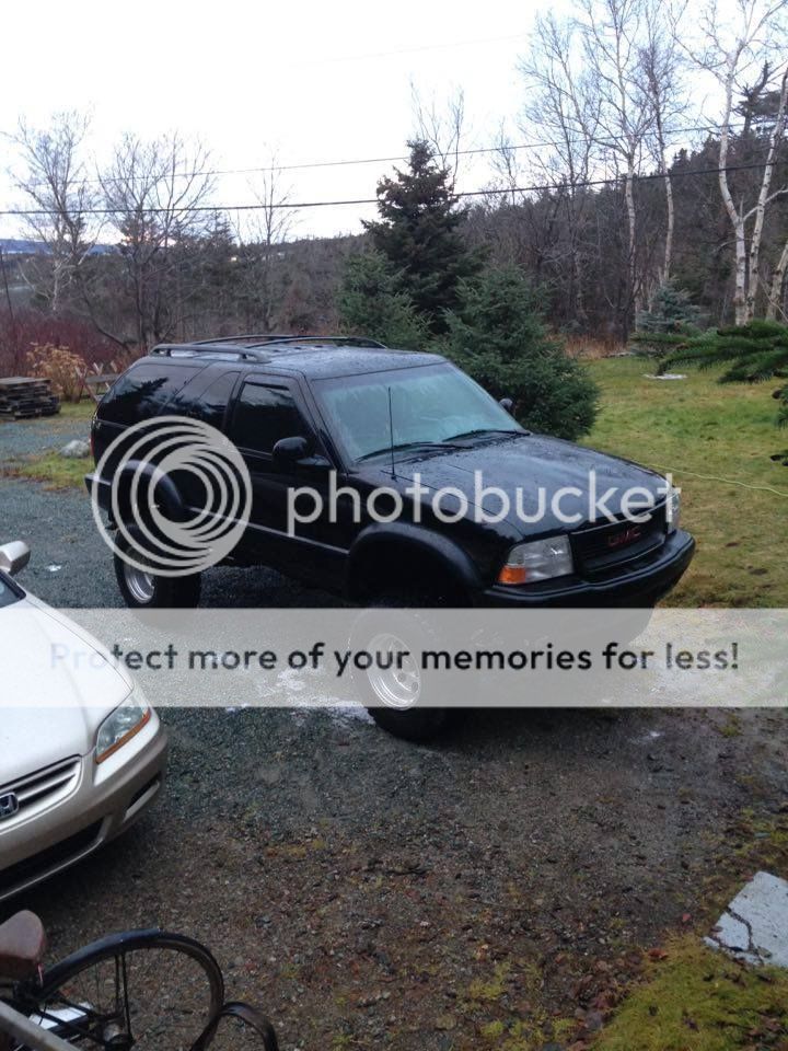

- 6 inch suspension lift, 2 inch body lift.
- 32x11.50x15 bfg ko tires, eagle allloy wheels with matching spare.
- bushwacker fender flares.

She is gorgeous, What size wheel and backspacing you using? they look like 15x10's

15 x 8 i do believe.
- trying to get my tire rack painted as well, pretty much upgraded the front end also, new pitman arm, idler arm, ball joints upper and lower, new fuel tank, sending unit, fuel filter, truck was in storage before i bought it and moisture must have gotten in tank and started to rust from the inside, clogged up fuel pump as well, replaced it all with new.
