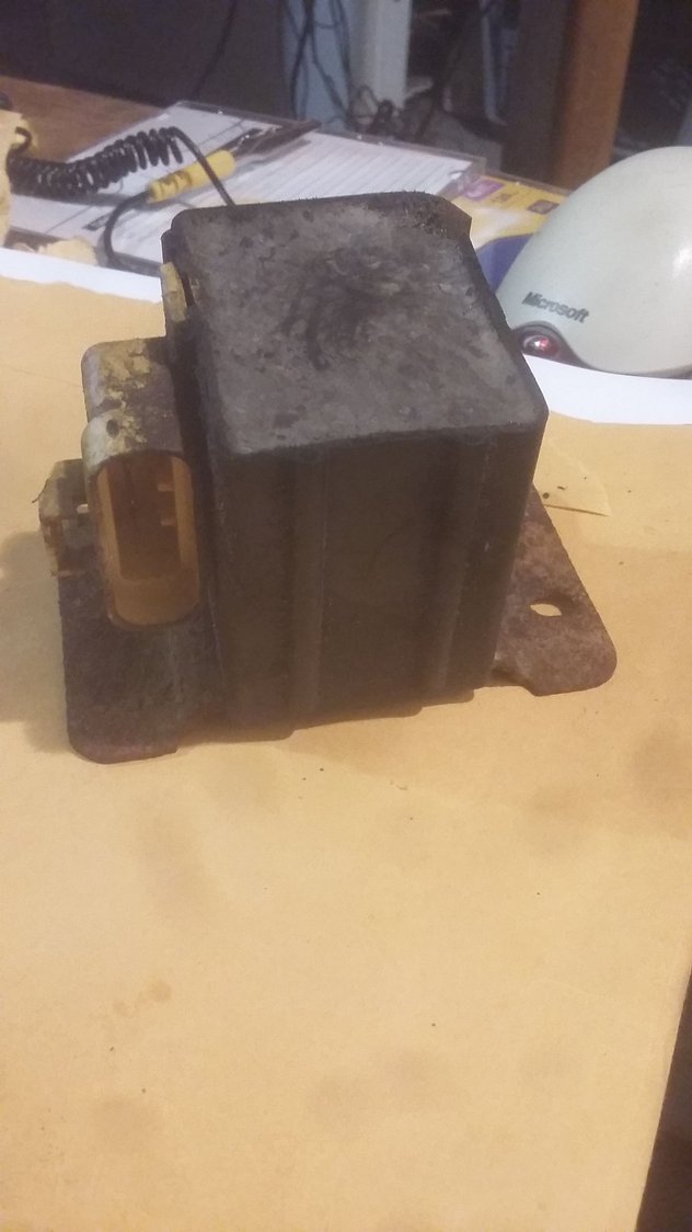

I am fully aware of the tools I will need and I'm bringing into my friend's garage where I have access to a bearing press and I'm aware of the fact I will have to set the preload on the pinion nut to make sure my pinion gear is in proper alignment with my gears I've been researching and studying for last week and a half to do this job cuz it would be my first official rear end rebuild but I've worked on vehicles since I was 12 ...and I have a backlash tool Im borrowing from a friend and I have grease so I can make sure the pattern is correct when I spin my gears through.... I actually have another question I'm also doing my power steering pump which is easy compared to the rear end and I found a module under the cowl right by the oil filter and there's actually two of them but this one's Fallen just dangling by The Wire and was originally riveted on I'm going to upload a picture if you could tell me what this is it would What is this?
be much appreciated

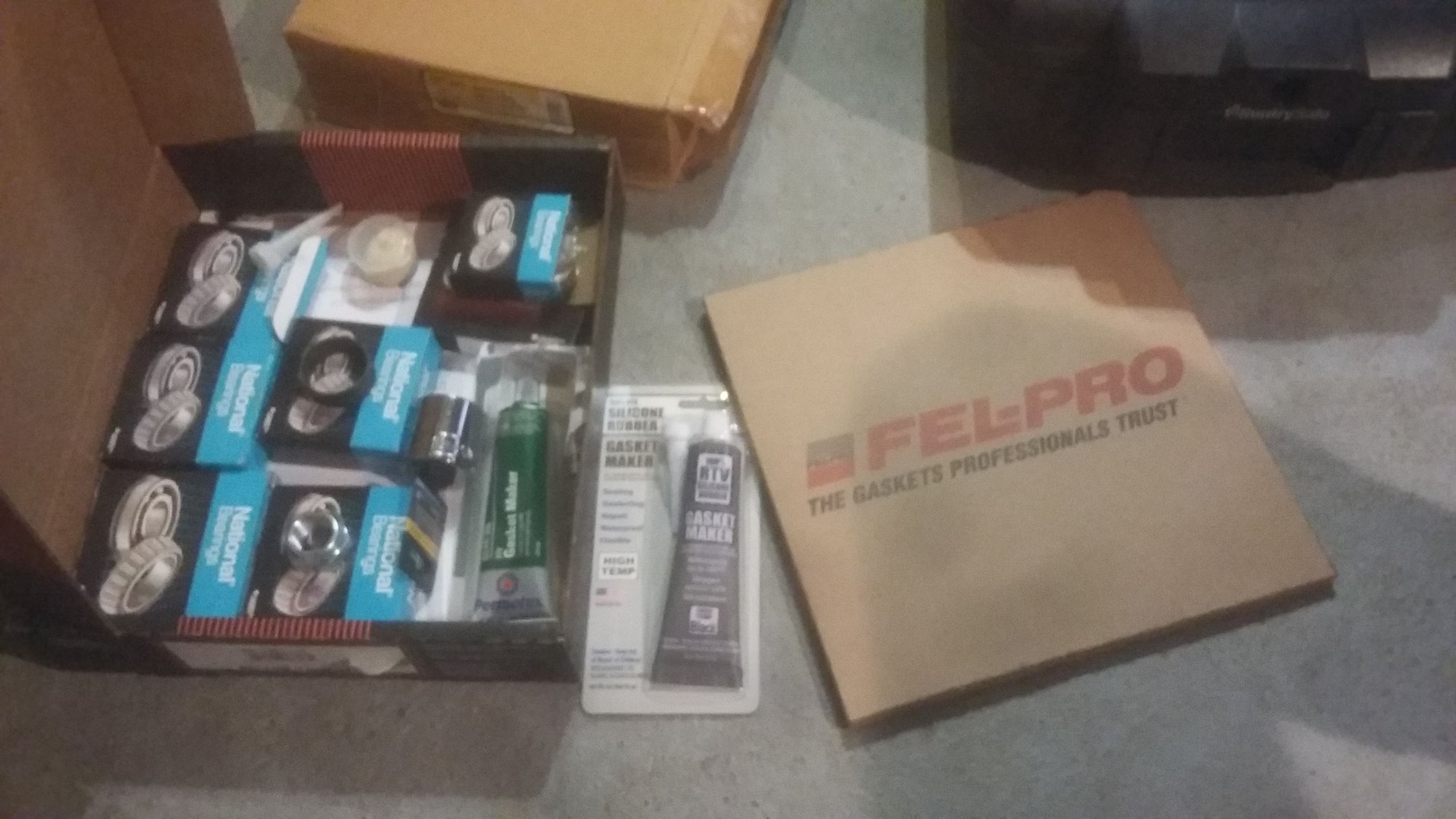

As you can see I have all new bearings crush sleeve grease pinion seal axle shaft bearings Etc ignore the gasket maker that came with I have a brand new gasket and there's a new gasket on it right now cuz I didn't want my rear differential leaking anything more than I could help
The Fel-Pro box is a brand new gasket And there's a brand new gasket on the truck right now it's still leaking out the pinion seal but it slowed it down makes it so it's drivable and it isn't hurting my gears I keep an eye on how low it gets I'm doing this job in like 3 days so I should be okay I drive my car like a grandma anyway

Originally Posted by Daisy Hebert
What is this?
be much appreciated
I believe that component in your picture above is one of the airbag sensors.

Yes it turns out it is an airbag sensor and I'm going to zip tied up or something looks like it was originally riveted or some kind of plastic Clips the rotted out I had no lights on my Dash so I definitely want to put it back and make sure I don't end up with lights on my Dash lol and I just ordered some nice torque wrenches so I'm not worried about that I have a cheater bars also and pipe wrench is also and all kinds of stuff for the last year-and-a-half but I have stepped it up to get the torque wrenches big jackstands big boy Jack LOL etcetera and I've been doing my reading every night I know what I need to do to get this done correctly I'm not trying to do this twice thank you for your input I appreciate it the more I know about how it's been done before the better
