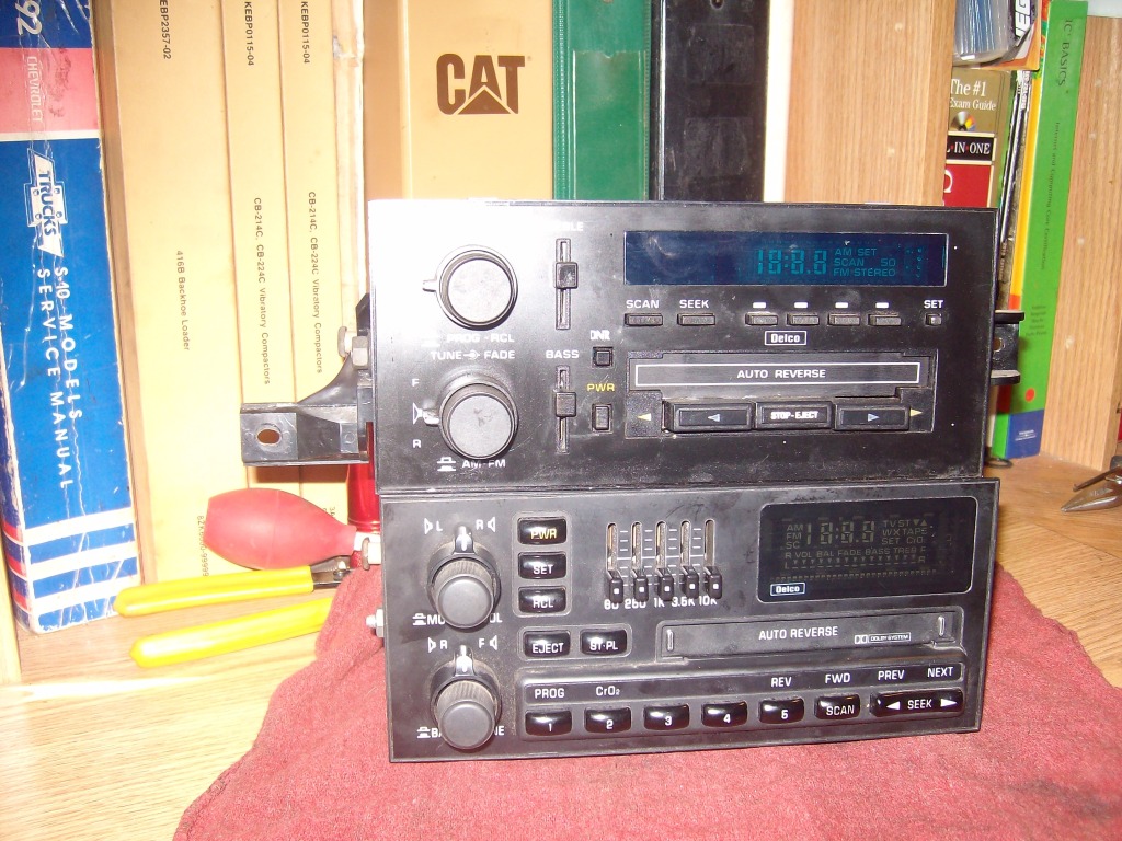

Well I got the radio today. BUT I have 2 issues.... I need an adapter wire harness and I can mod an aux port on to it.... UNLESS I find an other DIY to do so.
its a sweet radio tho. =D The top one is my original.
