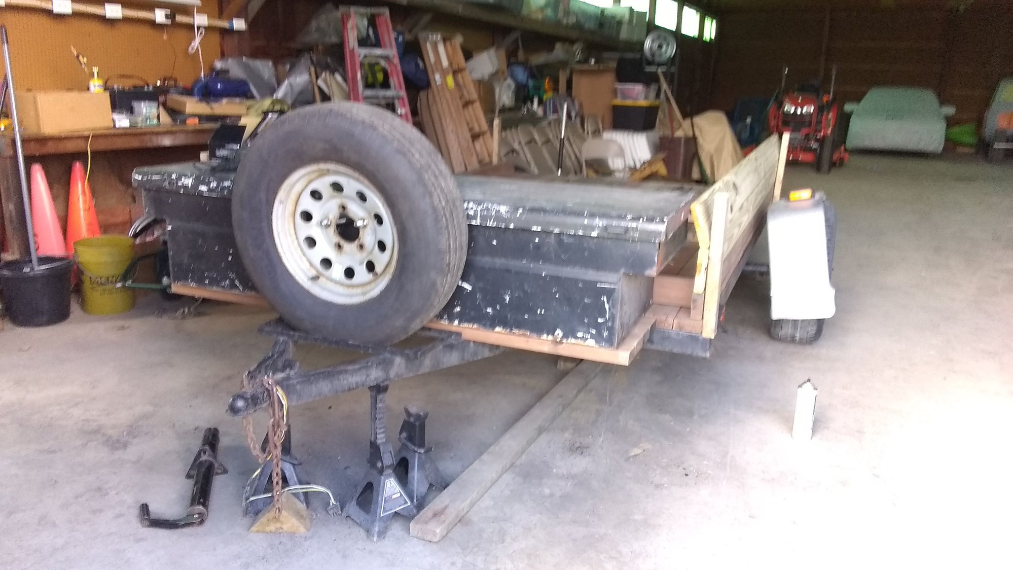

Old May 30, 2020 | 06:53 PM
bravo99's Avatar
Joined: Nov 2019
Posts: 219
From: Lansing, Michigan
progress...
that top row of backstop is literally the scraps from my side boards. Total waste two inches lol. The lid opens without touching, like a glove.
U bolt with lug nuts through the tool box.
ignore that Fender it's a placeholder. this is the general shape though.
Old May 30, 2020 | 07:20 PM
Looking good!
How did you extend the wheels out further? Did you swap the axle or something?
Old May 30, 2020 | 07:56 PM
bravo99's Avatar
Joined: Nov 2019
Posts: 219
yes we took the little axle off and I bought that axle from the guy who's barn I'm in. he runs a trailer rental business in town. I kind of contracted him to do it / help me do it. it was the good one of a salvage dual axle Haulmark total out of his. when he rebuilt his trailer he replaced both axles and kept the good one (until now LOL). Those wheels are Chevy 2 wheel drive Astro / 1500 5 on 5's. Another great Craigslist find that I paid 60 bucks for the pair, with the tires on them.
