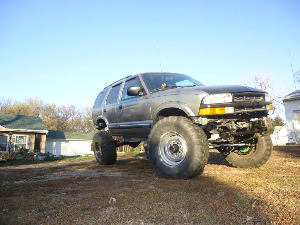

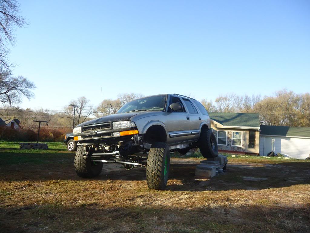

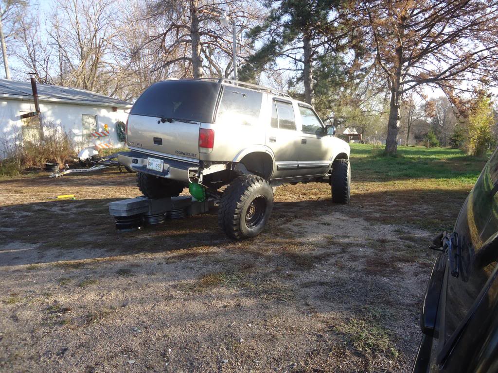

Ik you guys love pics so here are some, i get paid tomorrow so hopefully I will be able to get a few things.
it is not fully flexed but it does need to be trimmed some
