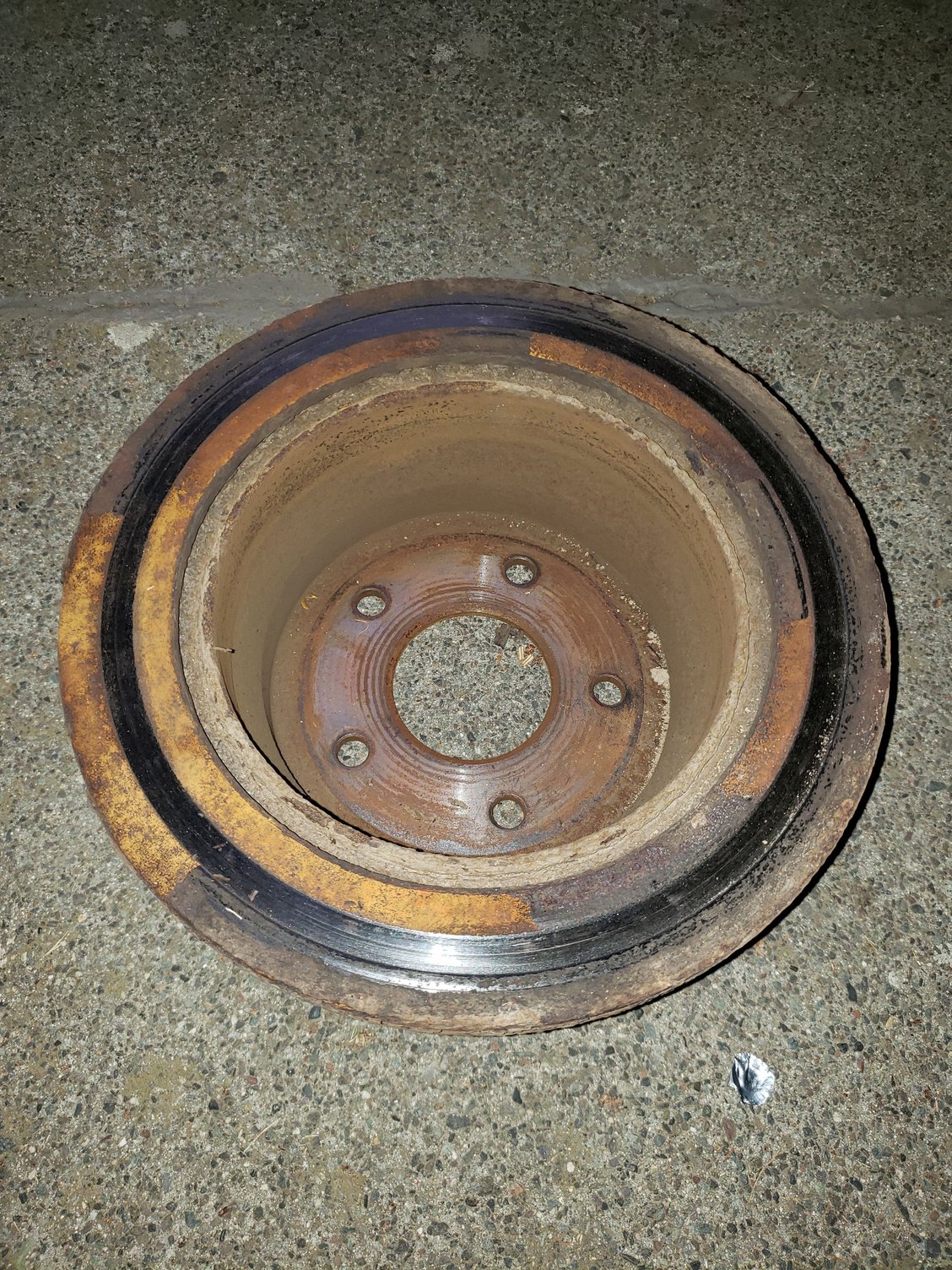

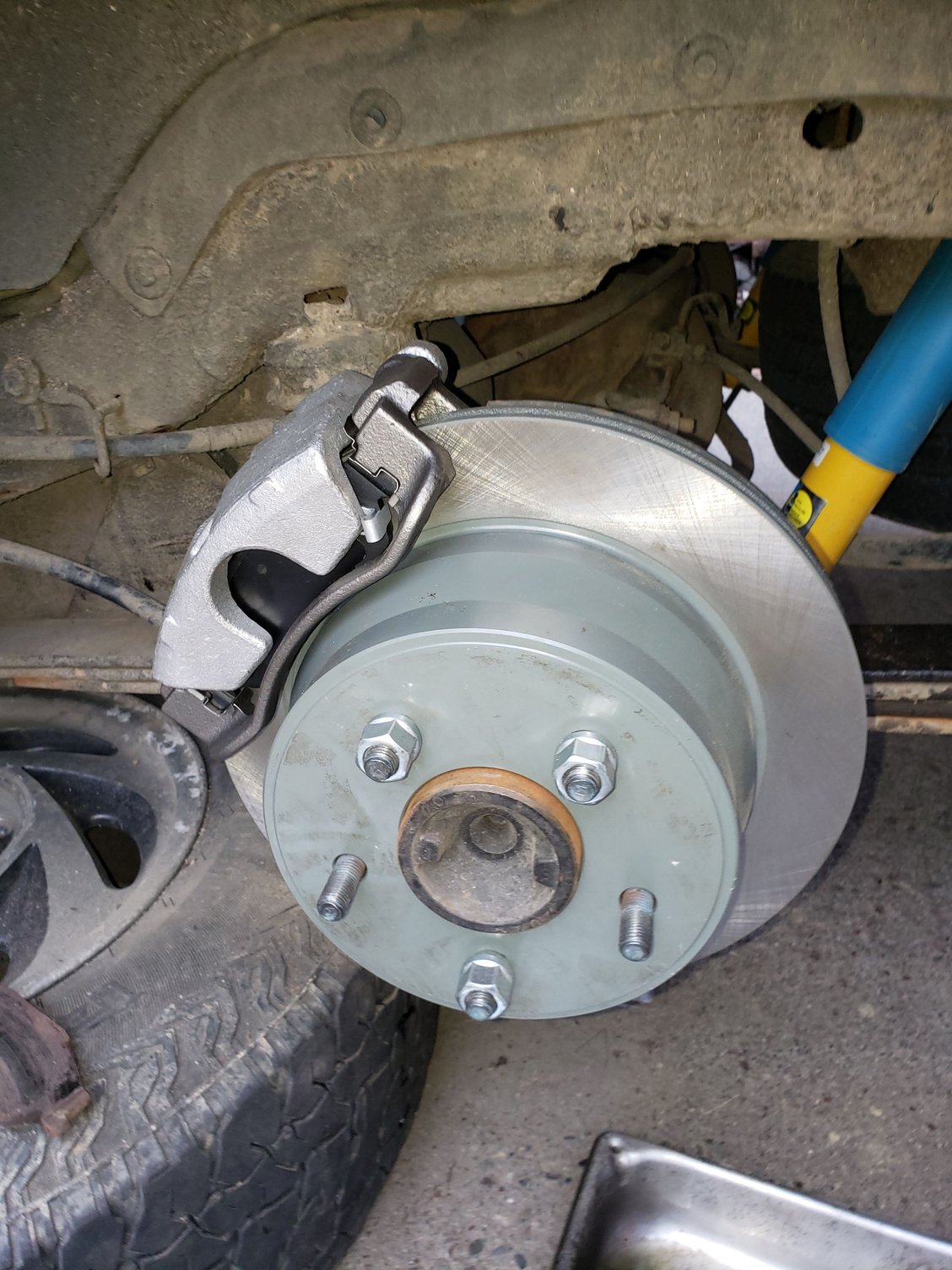

New rear brake calipers, pads and rotors. This didn't need to happen but I dropped the ball and was not good about checking the guide-pin lubrication, especially after launching my boat in saltwater. Ugh.
The result? The inside pads wearing down to metal, gouging the rotors, and a several hundred dollar fix.
I did find that one of the caliper pistons was starting to leak so maybe that was on its way out anyway. Rear brakes are so easy to ignore but I did so and suffered the consequences.
New rear brakes for the driver side.
New rear brakes for the passenger side.
I figured that it would likely not be able to be buffed out. (driver side)
Passenger side not as bad but the rotor was still toast.

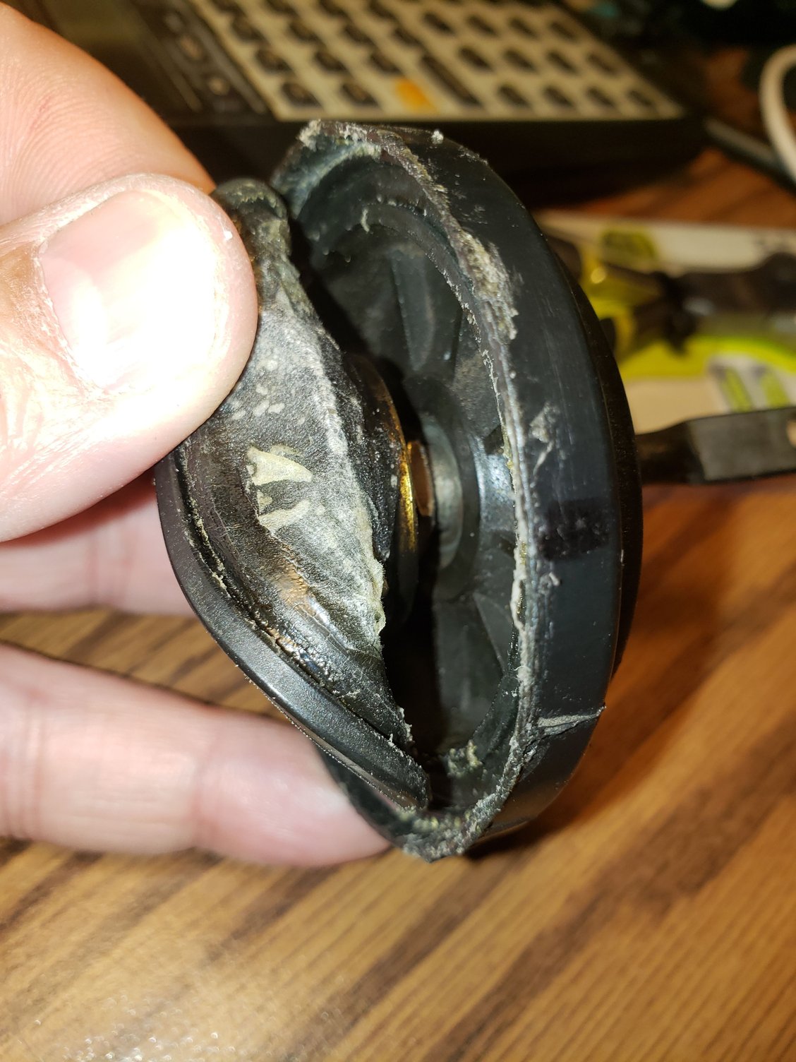

Blown old vacuum advance after trying to seal the old diaphragm with sealants.

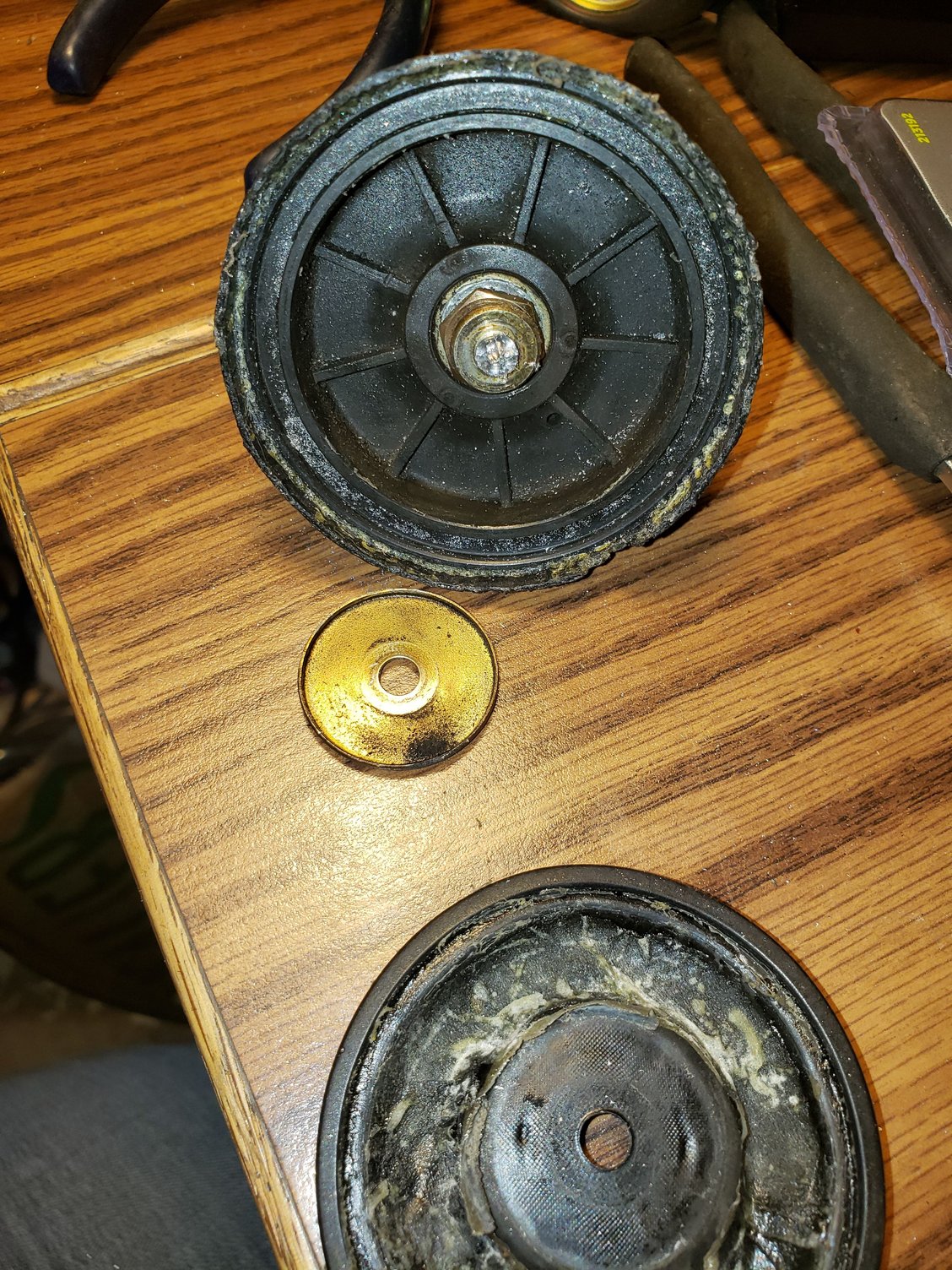

The disassembled vacuum advance (the top is not in the picture) and nasty old diaphragm. I found out in my research that these were notorious for failing. I should be happy mine lasted so long. I did reuse the lip of the old diaphragm to take up a bit of space to help the compression seal of the new diaphragm between the back and top parts of the diaphragm.

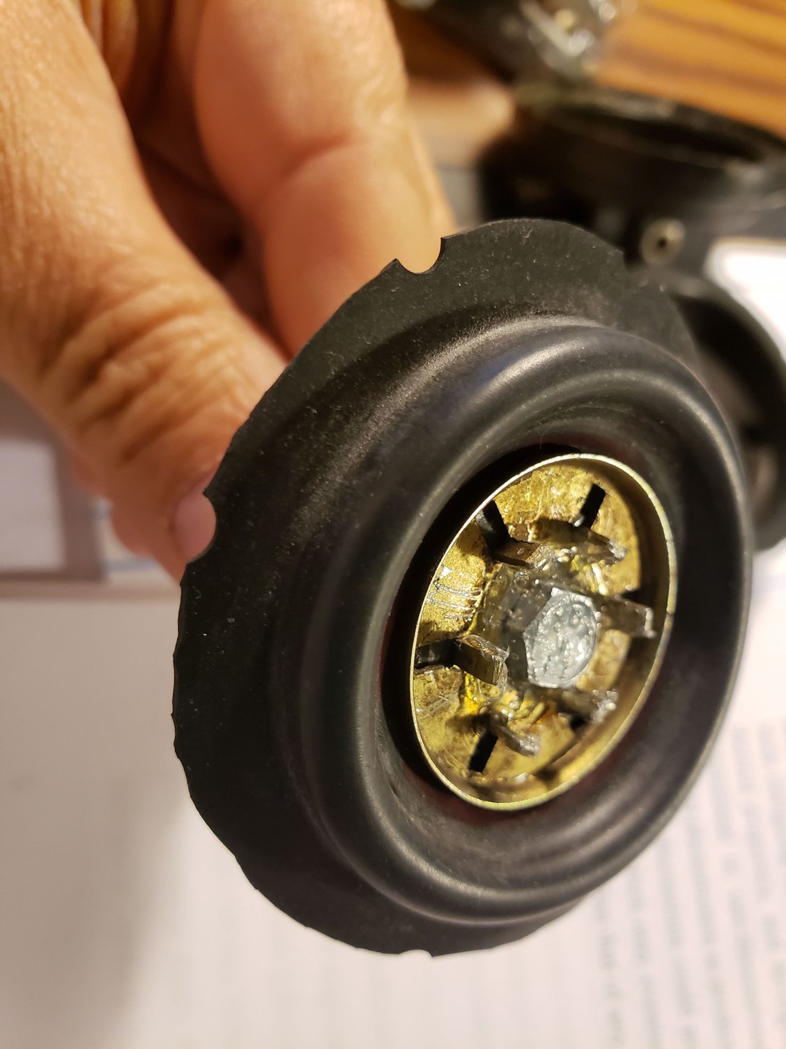

The repurposed diaphragm from an Autolite (Ford) 4100 carburetor. This is the vacuum secondary diaphragm. If I had to do it again, I might just JB Weld the bolt to the back of one of these diaphragms instead of disassembling it. By doing so I'd preserve the original seal of the metal plates to the diaphragm.

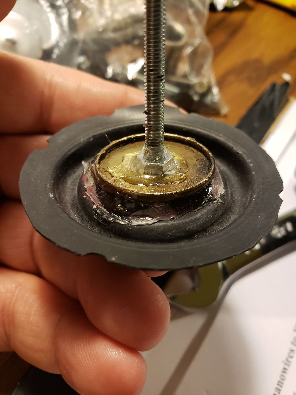

The vacuum advance uses a threaded rod as part of the mechanism to adjust the initial tension on the spring and the amount of advance/retard allowed. Used a bolt to replace this. I had to add sealant to the edge of the plates. Finally found that the Amazing Goop product worked best but only after trying a few others.

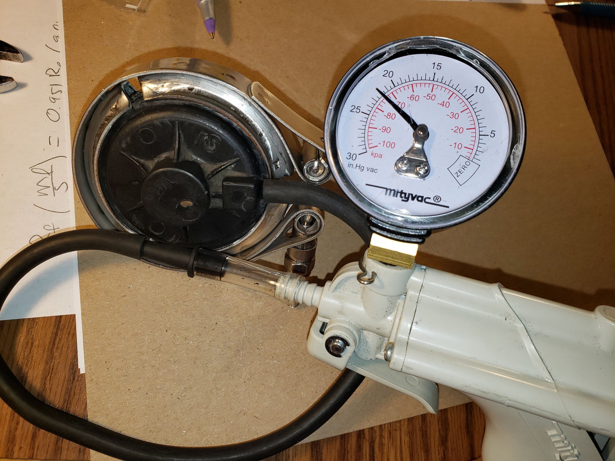

The initial test. I used a v-band clamp so that I can disassemble it.
