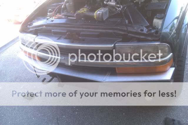

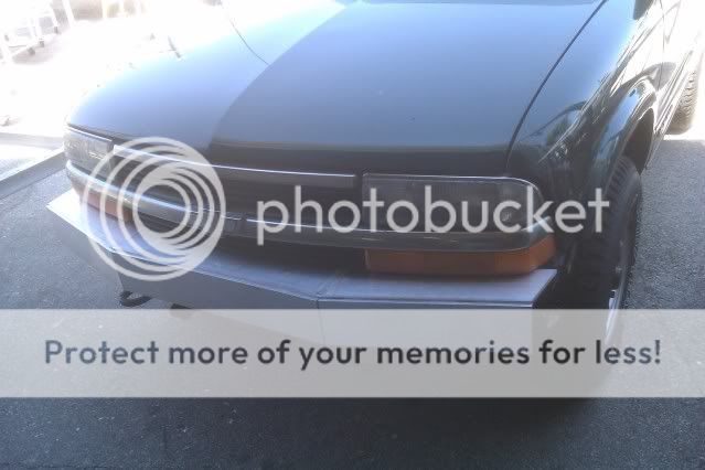

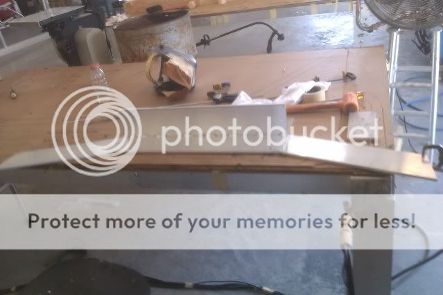

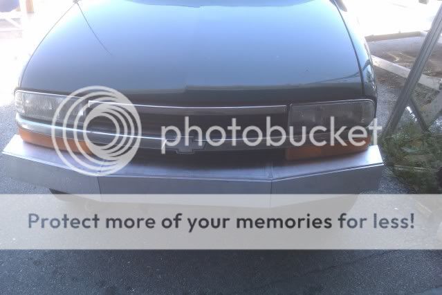

Just thought I would share the beginning stages of my custom front bumper on my 98 blazer. It is made from 3/8'' by 5'' 6061 aluminum stock.

I commend you for being able to weld Aluminum. Looking good so far, are you going to have the bumper going straight down or are you going to make them angle inwards? Would look great the latter, if you can picture what I'm pictureing lol.

There will be another set of plates angled inward below these. I only had like 2 hours to work on it before the boss had to take off. Hope to finish it next friday. Unless I can bring my machine home and set it up. I might start building these to sell if I can get enough interest.

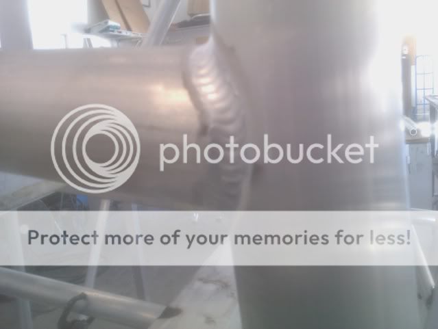

Those are some sexy welds. Looks just like the welds on the chassis of my sled, and those are done by a welding bot.

looks good man, thats pretty much how i want mine to look but maybe with a little more angle cuts, and also outta steel haha but looks sick so far man

All the open angle lines onthe front that you can see will be welded solid with angle braces every 8 or 10 inches inside. I would venture to say that when I get done with it, it will be stronger than 3/16 steel. Also, aluminum doesn't rust. If I start making these I can make them pretty much any way someone wants. Honestly these are the easiest thing I have fabricated since I started working. If you want to see what I build during the week check out Pursuit Boats. I build the tops, seats, handrails and a few other parts.
