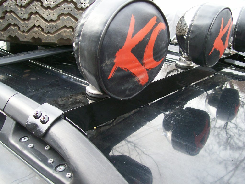

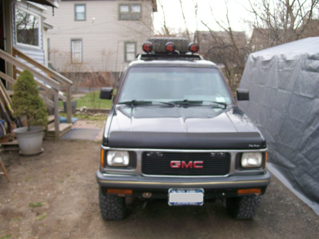

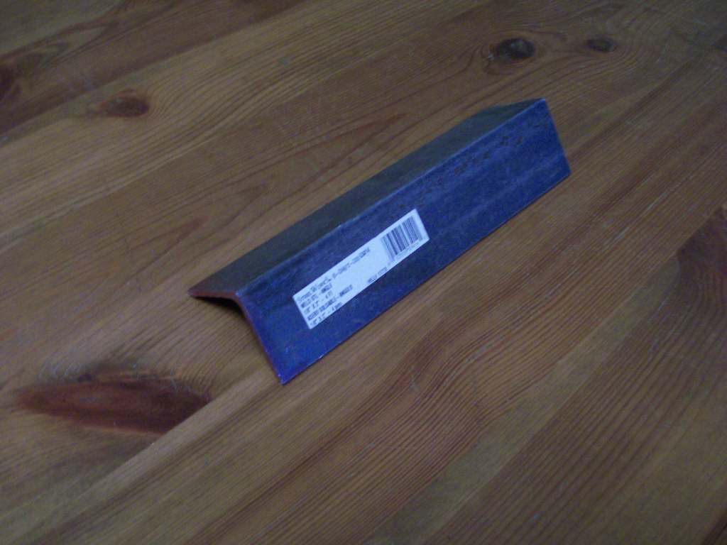

I started with a 2"x2"x1/8" angle steel 48" long, and ended up with a sweet, custom light bar for my 94 GMC Jimmy. I had the 3 lights already, so the total cost of the angle steel, screws, wire, switch, etc... $36.72!

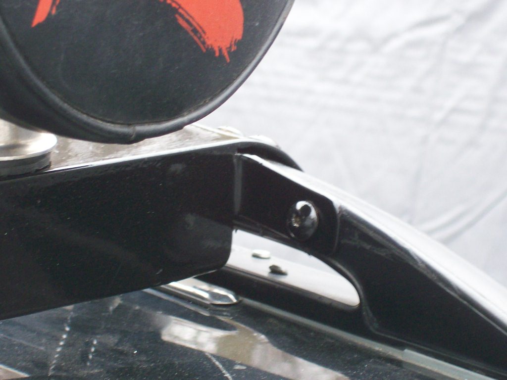

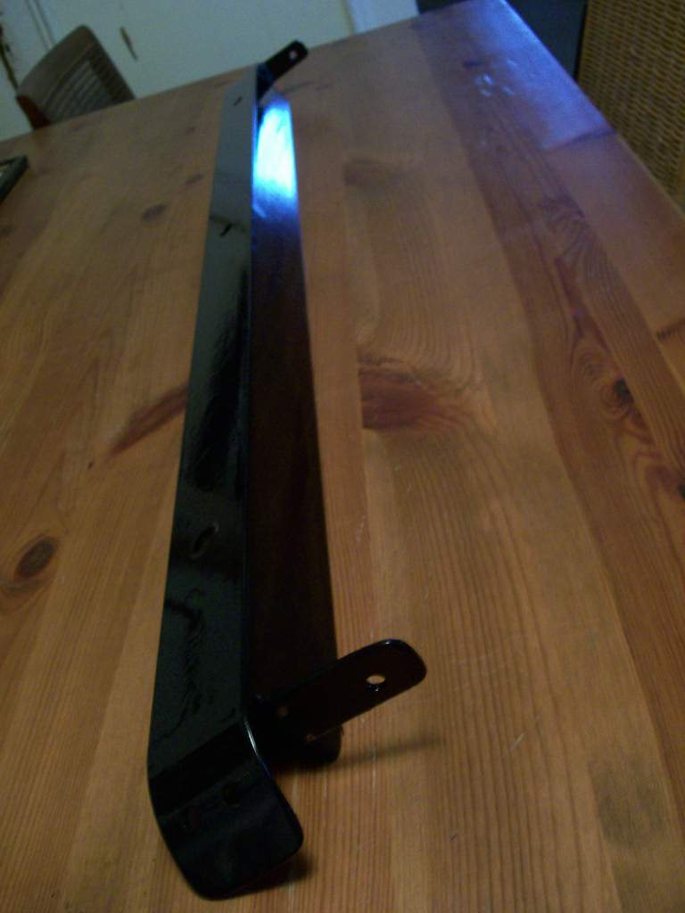

The wires are ran behind the angle steel and through a hole I drilled in the roof on drivers side (also behind angle steel). The dimensions are 35" between the factory roof rack. I added 1/8" so it fit snug. I cut the angle steel 2" longer on each side so the overall length is 39-1/8". The front of the angle steel was cut and bent to fit between the roof racks and the top of the angle steel was bent to hang over the top of the roof rack. The screws are deck screws bought at Lowes, pre-drilled and screwed right into the ends of the roof rack. I used a Sawzall with a metal blade, a 4" angle grinder, a drill, and a plumbing torch to make the bends easier. Slap on a few coats of paint and it's good to go. I'll post pics of the back of it tomorrow, hope this helps all you DIY'ers.
