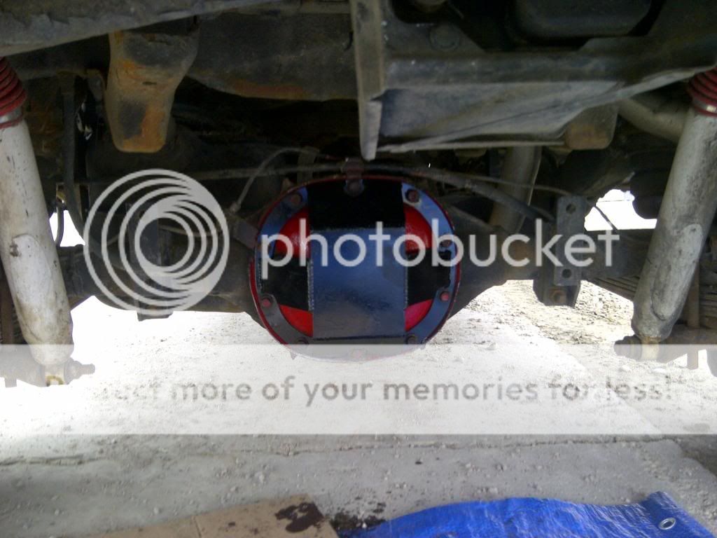

ok so it was a few weeks since i did anything to the truck so i got my friend to get creative with his welder and create me a 7.6 diff armor skidplate cover. heres when he has part of it built
we then had to test fit it around the diff cover and grind it down some more.
after it was ground to fit he then got more creative when i left to go home and added some side walls and painted it gloss black. i will add a biohazzord symbol to the cover soon to keep with my zombie theme truck
here it is installed onto the housing. like a glove
