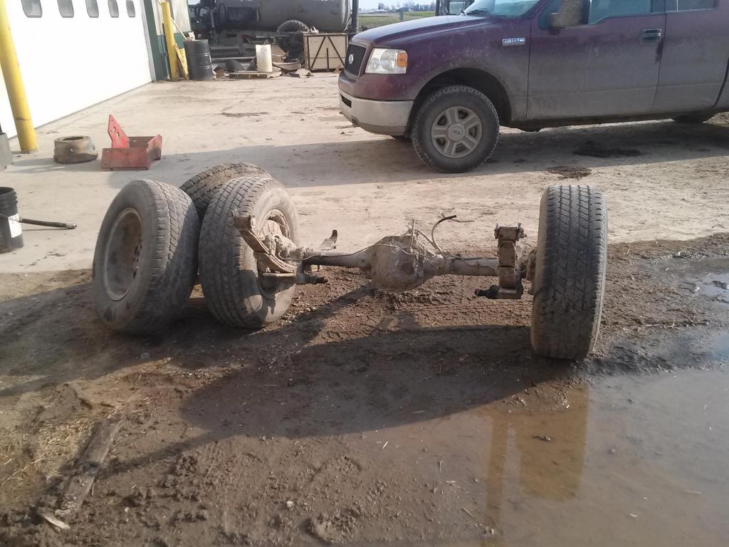

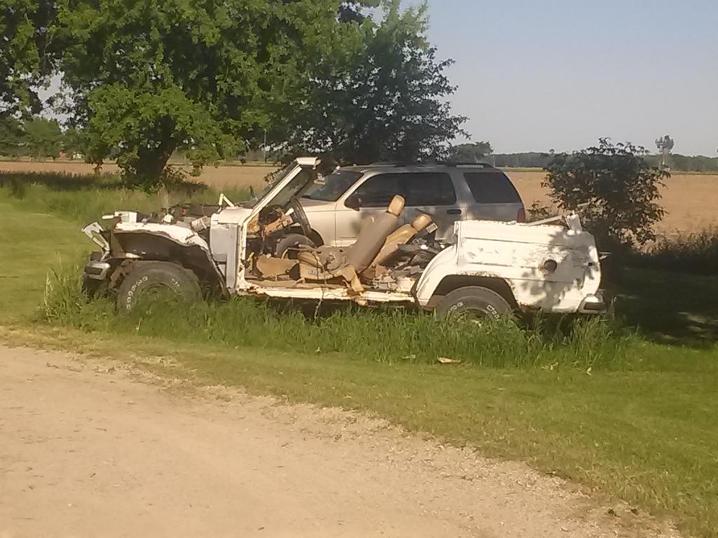

Well it was an interesting fall/winter/spring. Last fall my last trip out on the trail i ended up hydro locking my engine. Got it back running though and it runs as good as ever. Had a good winter other than a few rough patches. Lol
Then spring rolled around and i decided it was time for some bigger tires.
I got tired of replacing front end parts over and over also. So after 6 months or more of research i bought what was left of an 87 Wagoneer for parts and a 95 Honda Passport rear axle and im going solid axle. I have to build a front crossmember and buy a few odds and ends still but I will be doing this swap here shortly..
Waggy D44 front with waggy steering and front springs SOA
Passport D44 rear SOA
35-38" tires depending on the deal i find.
Homemade crossmember for the front

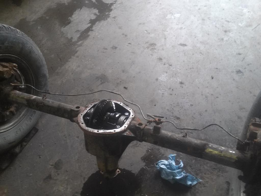

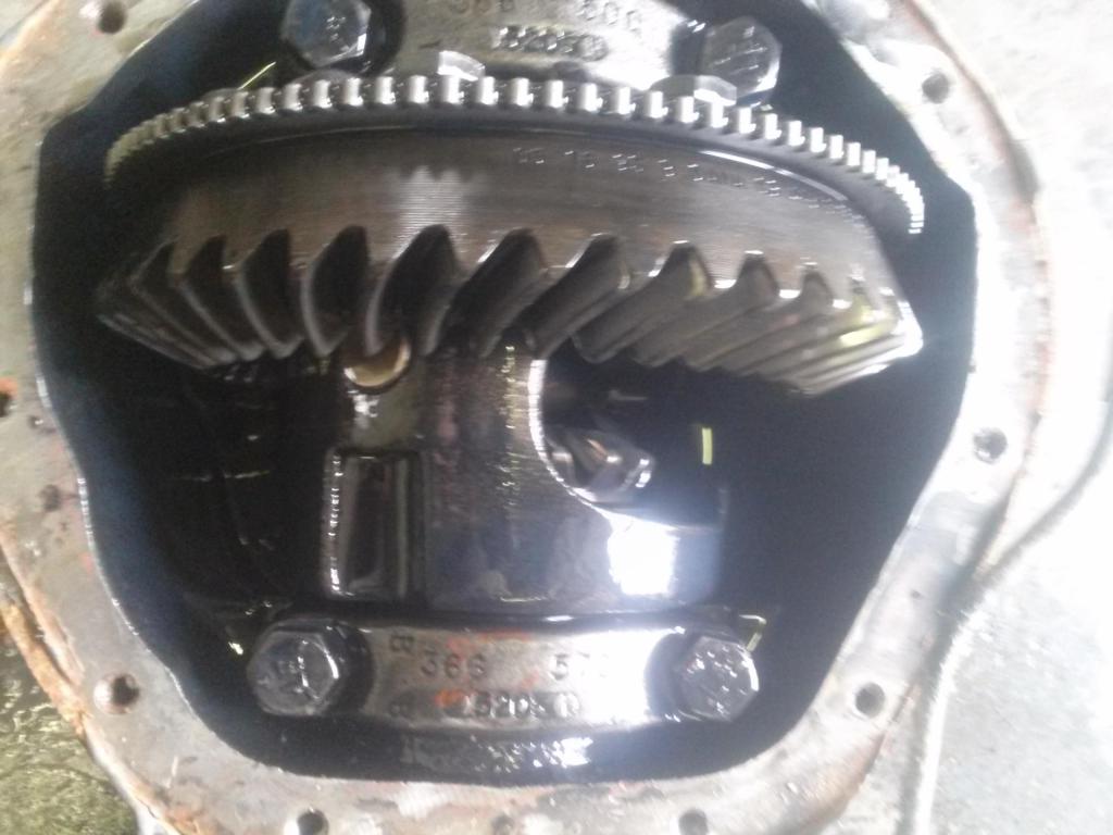

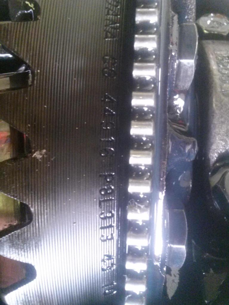

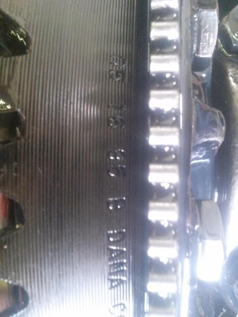

Well i decided to get the perches ground off the rear today. Also pulled the diff cover and everything looks good. Can anyone tell me the gears by the numbers on the ring? Thanks a lot. I believe its a 4.30 but i dont know if you can tell by this or not.

Yeah those are 4:30s. If you fine another axle with the same ratio you can swap the R&P into your front axle as well for cheap matching gears.
