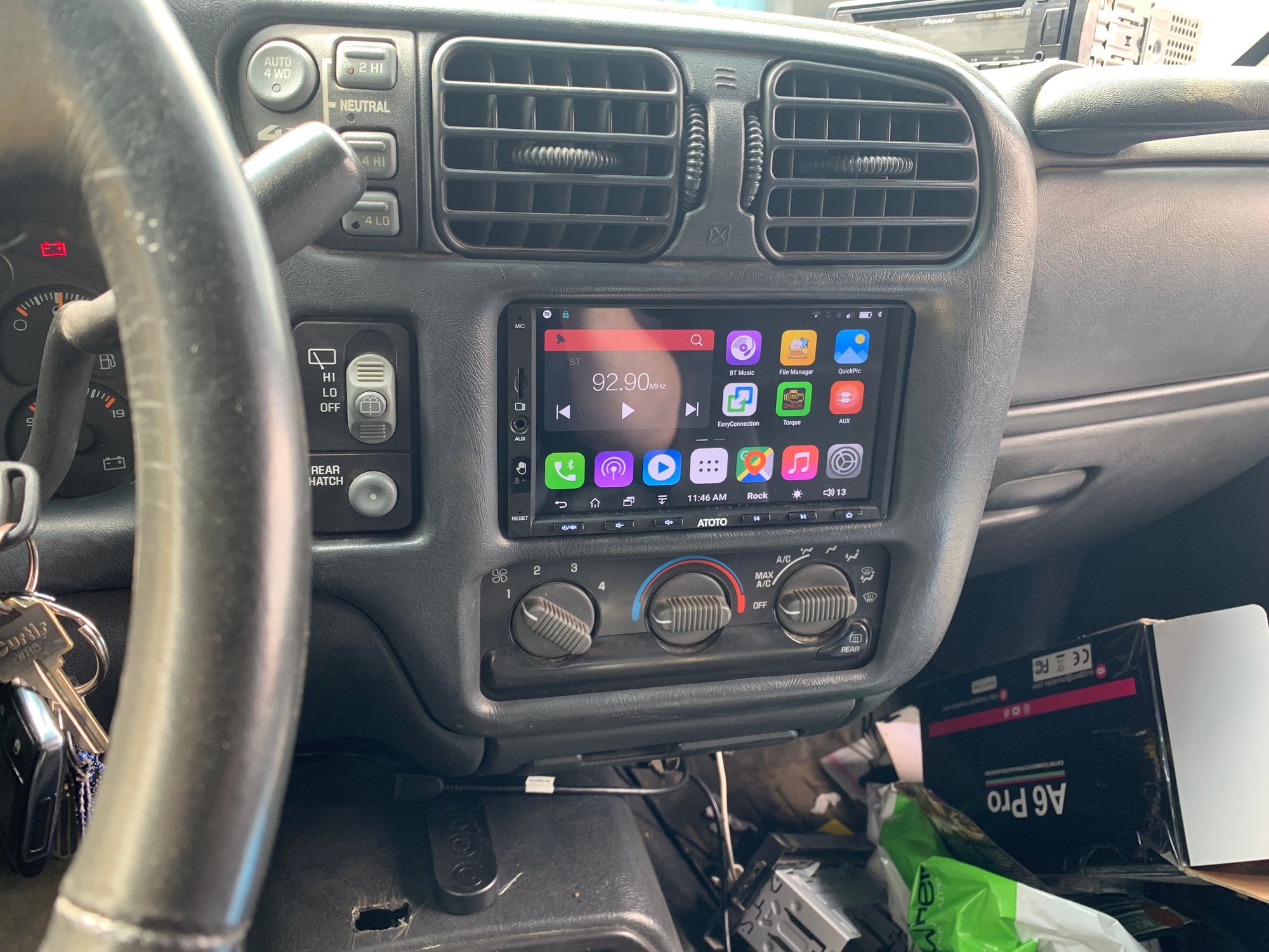

Scored a deal on a double din android unit and atoto a6 pro for $200cdn
Installed
it supported a Bluetooth obd2 reader so picked one up and get it all set up comes preinstalled with torque pro
its capable of so much stuff I love it

What obd2 reader did you go with? Was that the stock 1-1/2 din facia and did you have to cut it?

I went with a Bluetooth obd2 reader from princess auto but any from amazon work as well as long as they are for android and Bluetooth and the facia I got out of an 03 S10 at the auto wreckers it had the rds stereo in it so it was already double din getting the brackets to line the stereo up was the hardest part
