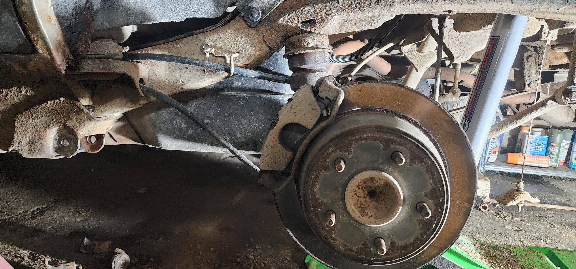

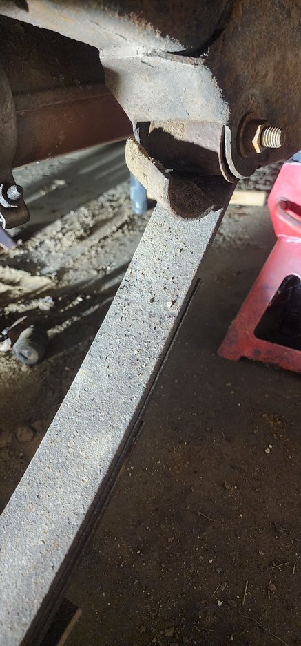

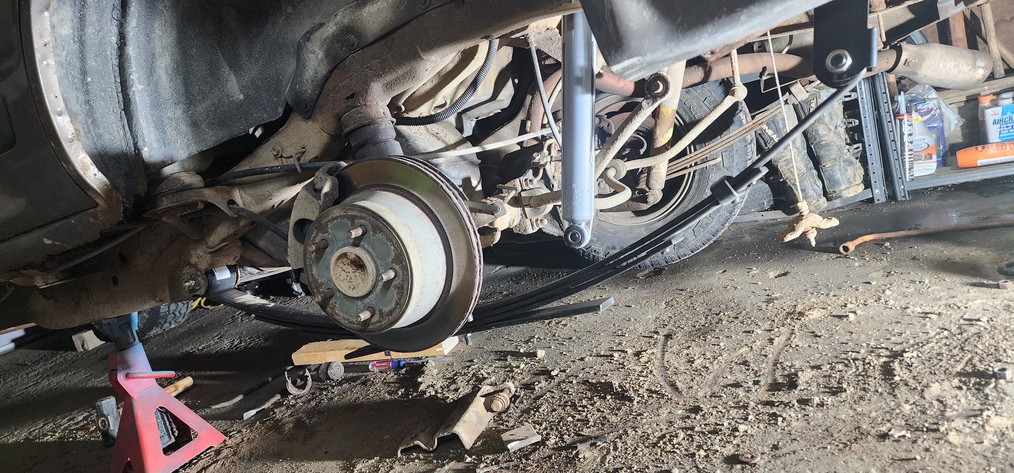

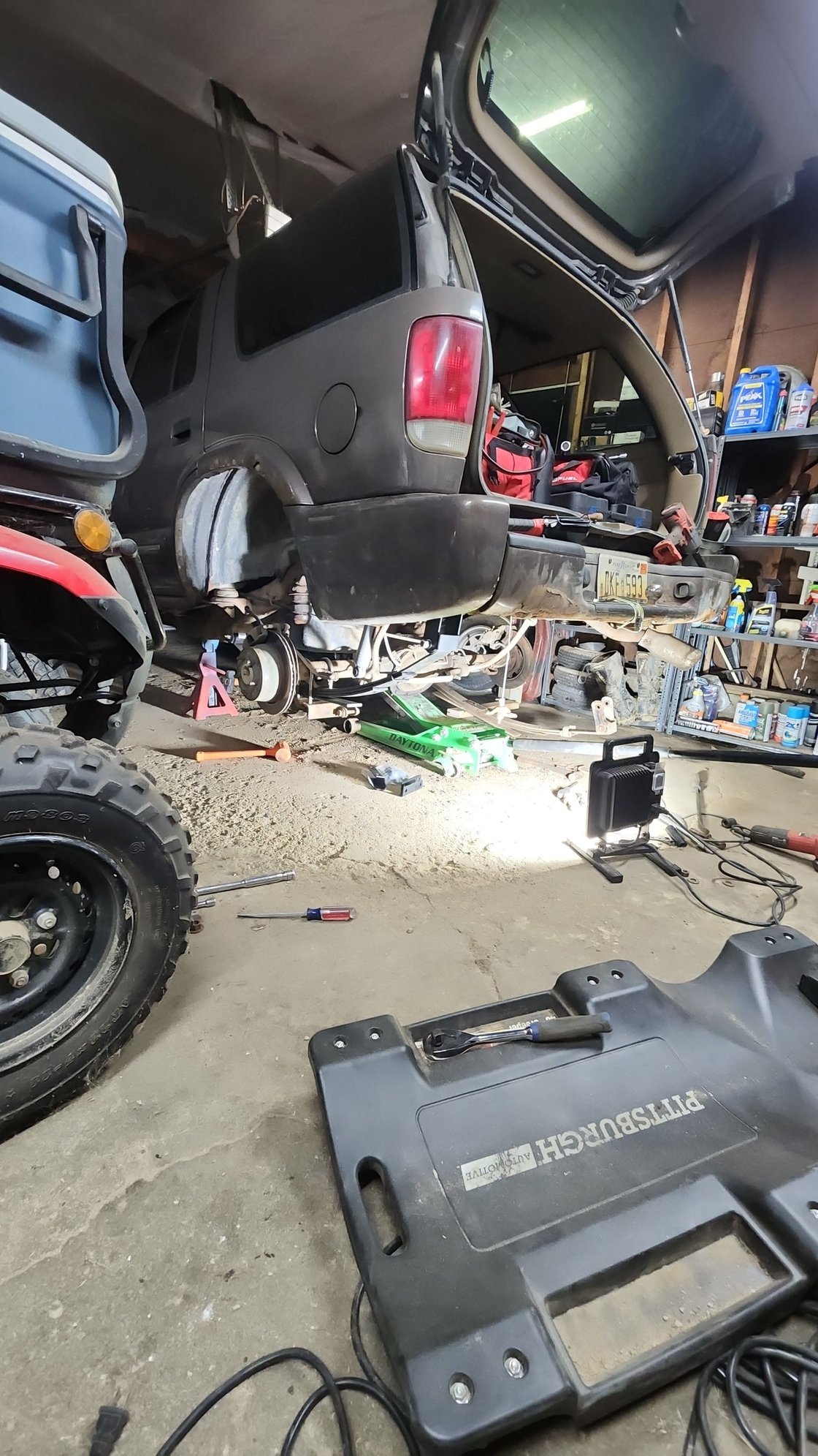

Slowly making progress on the suspension lift.
Ive got new leaf springs installed and new speed nuts for the new shocks installed. Observing and fixing issues I find with her. But I'm looking forward to continuing progress on the ole girl.

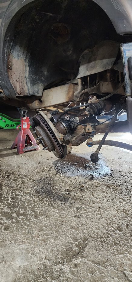

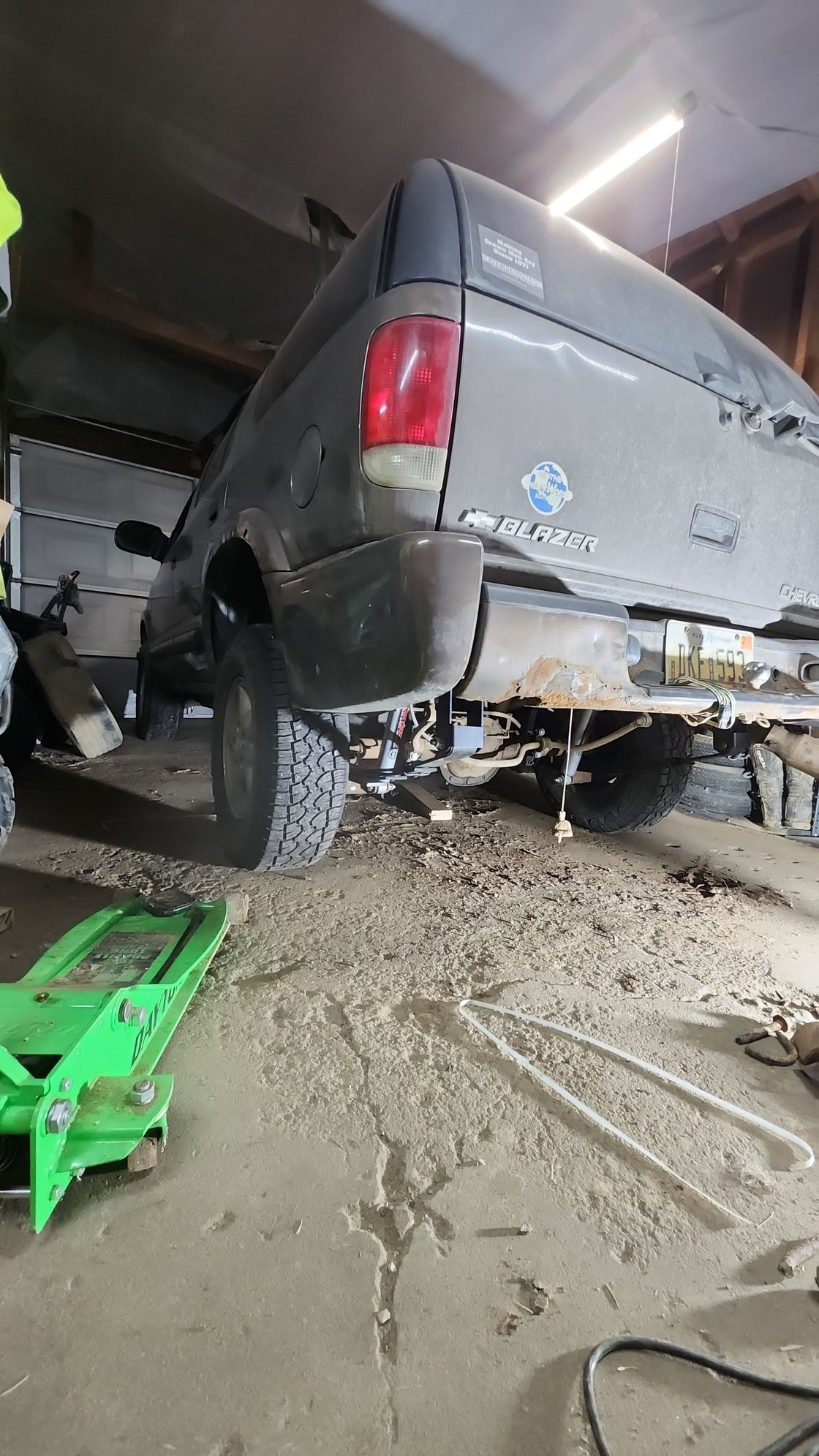

Slowly making progress on the front, the rear is completed and looks awesome! Also, while I had the battery tray out, I figured I'd do a Craigslist rebuild on the battery tray and hit it with some paint for rust prevention.

Forgot to update, the rear is done!

I'm looking at replacing my rear springs soon. Any hints and tricks you learned replacing yours?
Yes!
1. The grinder is your friend here during removal, I watched a video and gleaned some information that made my life way easier here!
That is the link to the video that helped me out on this one.
Also I don't necessarily recommend this, but I did it as I was being lazy. I used my floor jack and a long 2x4 to jack up my fuel tank just enough to tap the new bolt in with a hammer. On the other side, I used the same method on the muffler. You won't need a ton of lift, just enough to get it started and tapped in.
Also, if for some reason you can't get the axle to sit properly on the alignment studs, whilst mounting the perch and U bolts, go ahead and take the bolts out of your rear sway bar to get them mounted. After everything is bolted back up, if you can't get the sway bar realigned, let the blazer down and bounce the rear end to help settle the springs. You should then be able to bolt the sway bar back up without any issues.
Other than that, it should be pretty straight forward.
I definitely would suggest having a Pry bar handy for various tasks.
If you have any questions or run into anything, feel free to ask!
