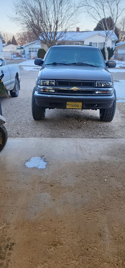

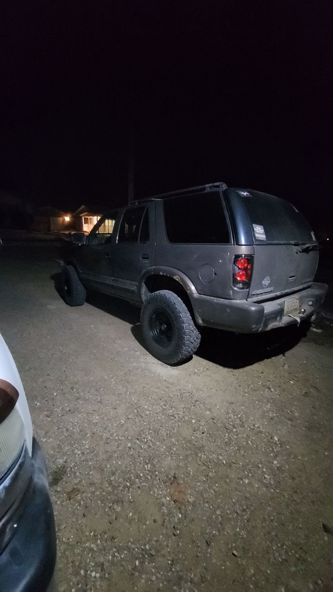

Well to make a long story short.. I had to step down to the 31's... sadly. The body lift is on hold until I have a buddy fab up a new perch for one of the body mounts as its toast. She drives nice though! Had to do a minor bit of cutting on the fender for full turn. The new headlights and tail lights are in and look great! Still more to do but when isnt there. Im happy with how its coming along!
