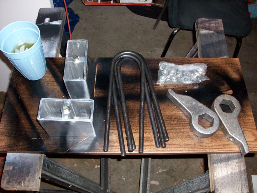

So once again, can't wait for the next couple of days where I can work on the TB's and hopefully get the keys off. I've been soaking everything in PB Blaster every night for the last 5 days. Hopefully that will be enough to let me break them loose so I can get the new lowering keys on.
Here's a pic of the kit I bought, ready to go. Not going to install the blocks though until the fronts get done...

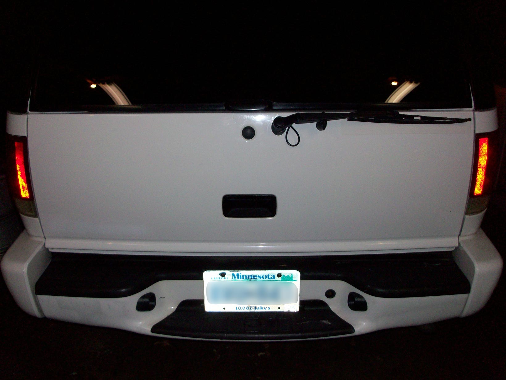

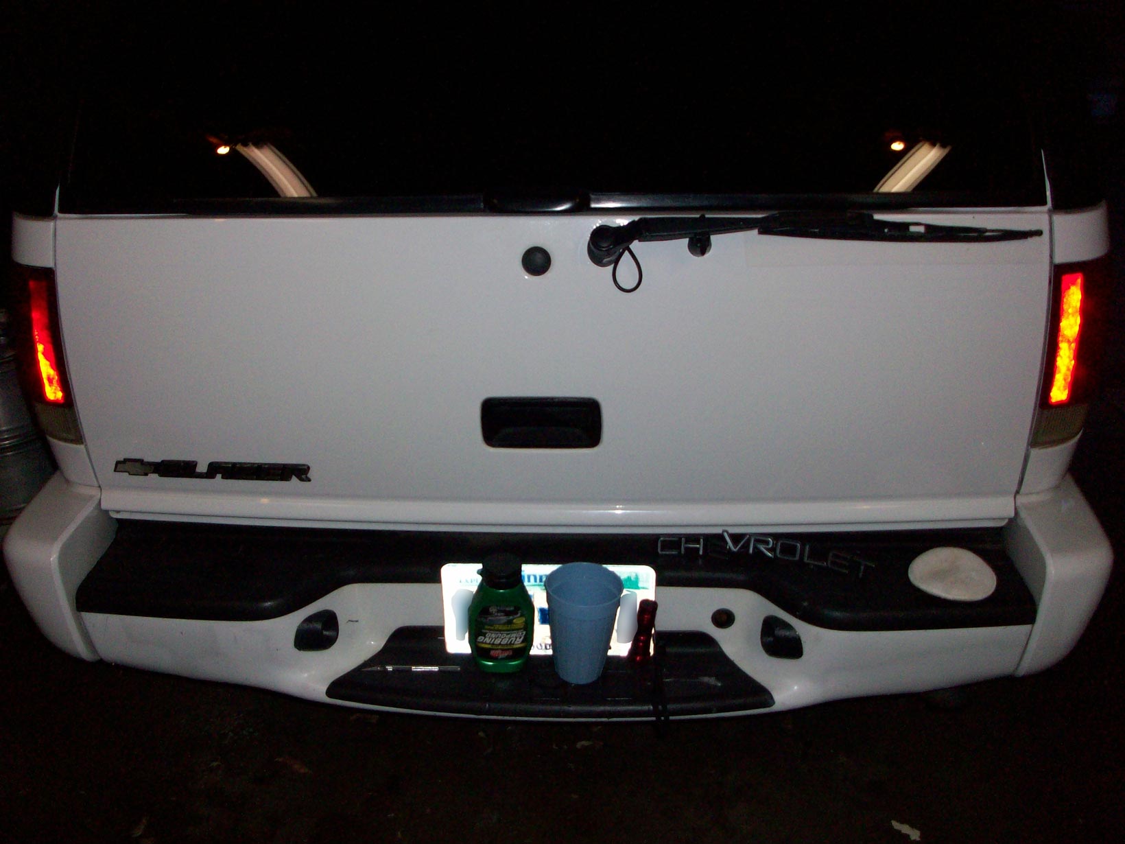

Once again, I found myself wanting to do something to the truck while I wait for my lowering install... So, I decided to de-badge the rear end. Left side was "Blazer" and the auto dealers decal, right side was "Chevrolet."
Midway through and ending.
Nothing says sexy like a smooth ***-end.... : P

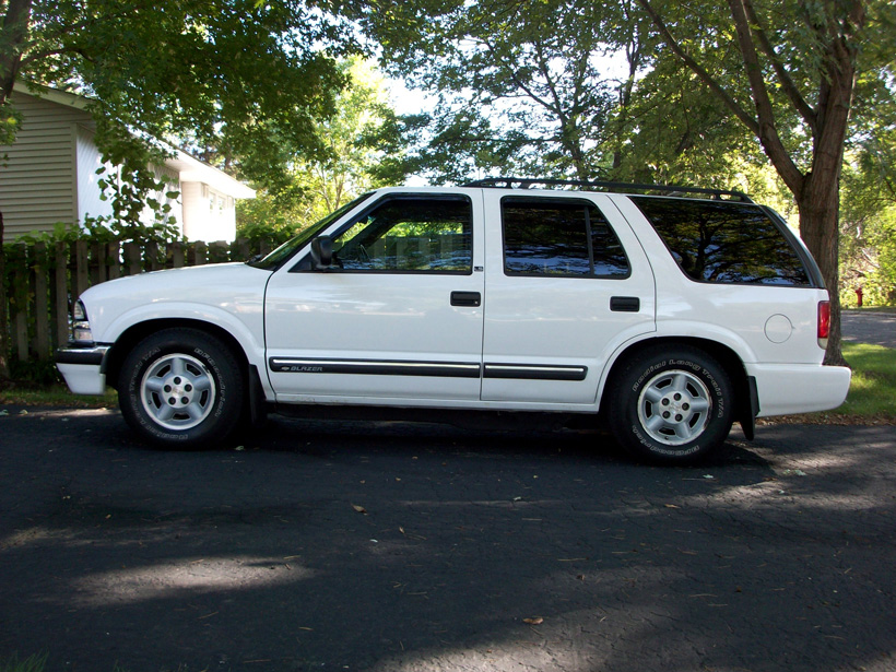

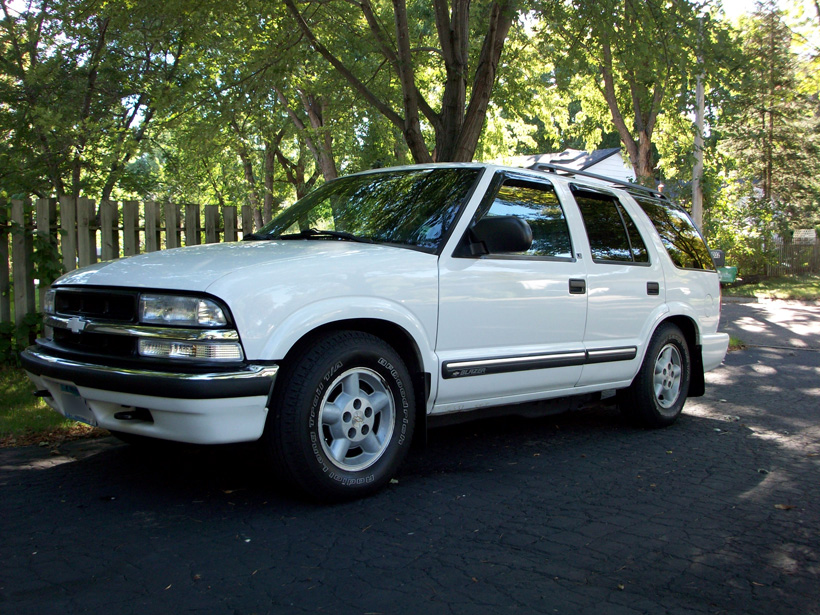

Ok so here she is lowered 2/4. She sits .5" lower in the rear then the front at the moment. Since I like where the front is sitting, I think i'm going to swap to 3" blocks in the rear to raise it up some. She's parked on my sloped driveway in these pictures, so it's not like the angle is off THAT much lol.
Also, debating on what size tires to stick on her.
235/65R16 - Same size as my tires now but in a 16" rim.
235/60R16 - Little bit smaller sidewall.
245/55R16 - Typhoon tire size, would lower my truck another inch.
What you guys think?
