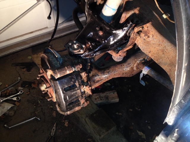

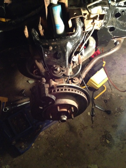

So I think I got a decent amount of work done today.
- Last bolt on the motor mount I was having trouble with is in, motor mounts 100% done
- trans cross member and mount are in place, bolts need tightening still
- passenger side inner fender installed
- coolant reservoir installed
- computer installed
- front diff in place, still needs 1 bolt installed and rest need tightening
- passenger side knuckle, wheel bearing and cv shaft installed
Not bad for 4 hrs

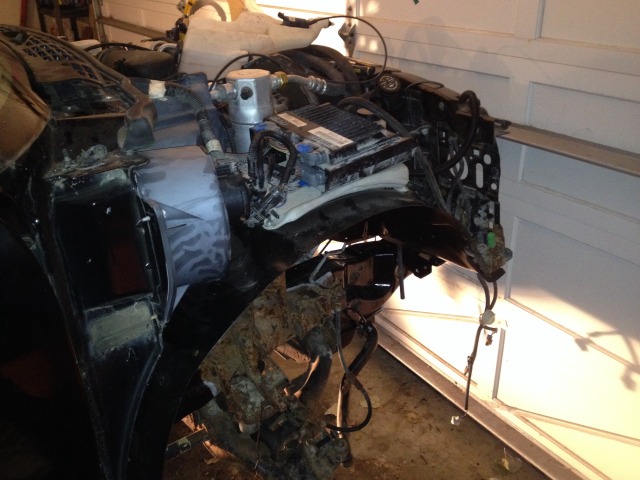

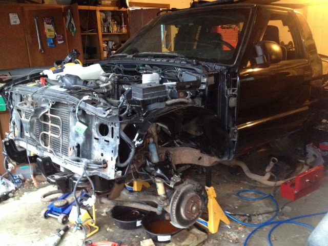

Driver side suspension is all put back together as of yesterday, also tightened up all of the front diff mounting bolts. Front diff just need the actuator installed, otherwise it's 100% done.
Today I was able to clean up the garage and made enough room to get a vehicle in. Also mostly finished up the passenger side suspension, just need to install the brake caliper into the bracket

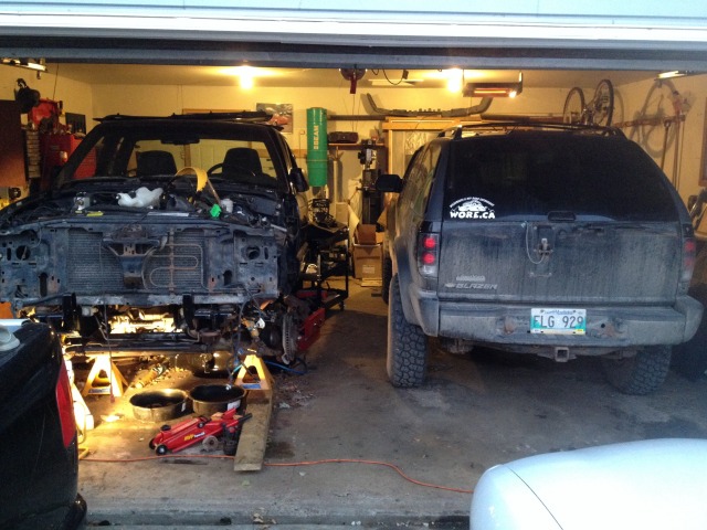

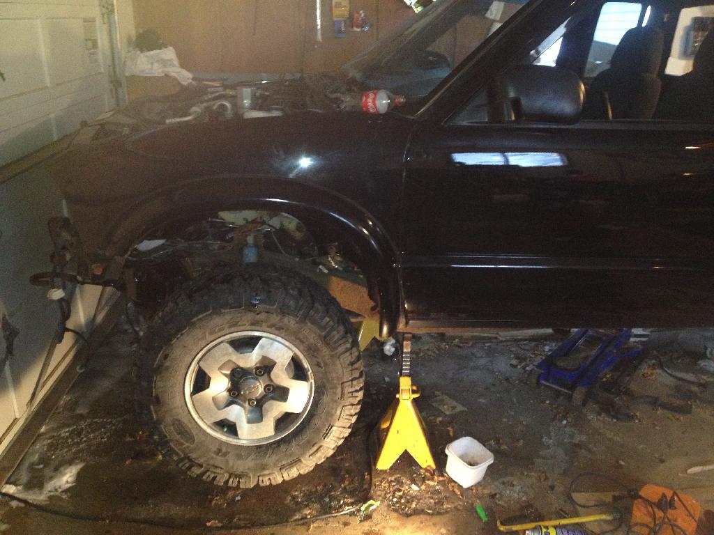

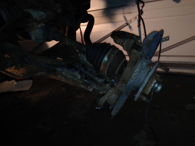

Saturday I was able to get the driver side inner fender installed and finished up the passenger side brakes

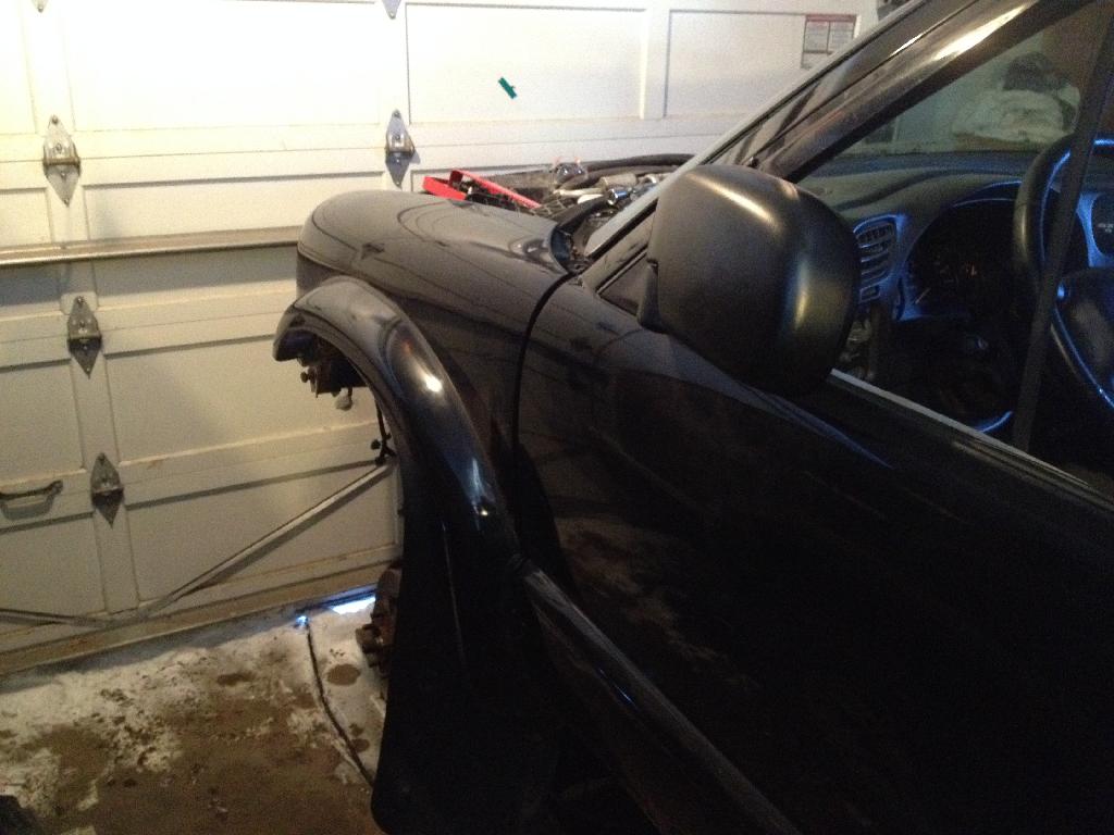

Well I didn't go to work today due to not being able to see the road a foot in front of my car...
So I worked in the garage most of the day.
I was able to get the exhaust installed, figure out some more electrical connections, install the front diff actuator, put the rest of the passenger side fender bolts in, install the battery tray, and install the driver side fender
Attached Thumbnails Jamaroon's S10 ZR2 Trail Rig-b762fbe5-094b-4451-9894-a3bca80e0094_zpssn9lofxx.jpg

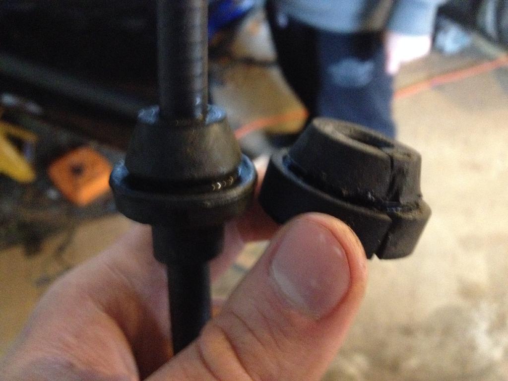

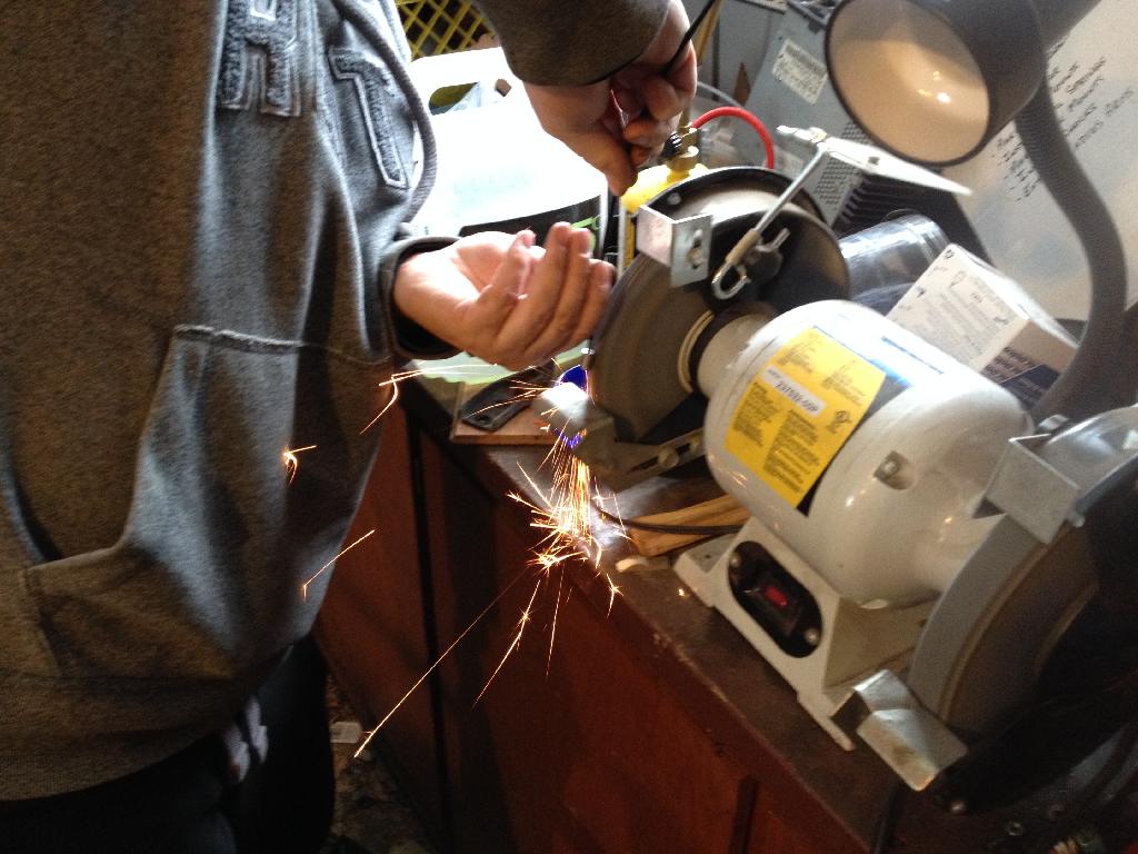

Paul came over and we got a bit done on the truck today.
We got the new parking brake cables ran, just not hooked up to the brakes yet. It's hooked up inside though.
FYI: Do NOT buy dorman stuff, fitment is horrible.
First the rubber grommet where it goes into the cab was way to big, so we salvaged the old one
Then the next piece of the parking brake cable had ends that were way to big to fit into the bracket, so Paul ground it down on the bench grinder
Then the next part of the cable had a different part of the end that was too big, so I filed some of it off until it fit in.
Next we replaced a couple pieces of vacuum line and then bolted the inner fender to the outer fender which turned out to take a lot longer than expected. The capture nuts were all pretty rusted so we had to swap most of the out. The inner fender was a bit bent or warped which made the hole not line up.
We also bolted up one of the tires onto the front and installed the hood.
Attached Thumbnails Jamaroon's S10 ZR2 Trail Rig-b74dfd96-51f8-43e6-8e35-dadad96b794f_zpsidj4vicf.jpg   Jamaroon's S10 ZR2 Trail Rig-fdd7a83b-cad5-4b69-a886-0c821d9f32fd_zpstw7lfau1.jpg   Jamaroon's S10 ZR2 Trail Rig-a2b32154-ed56-4bad-b1b9-6d31b705701c_zpsrshpt4ig.jpg
