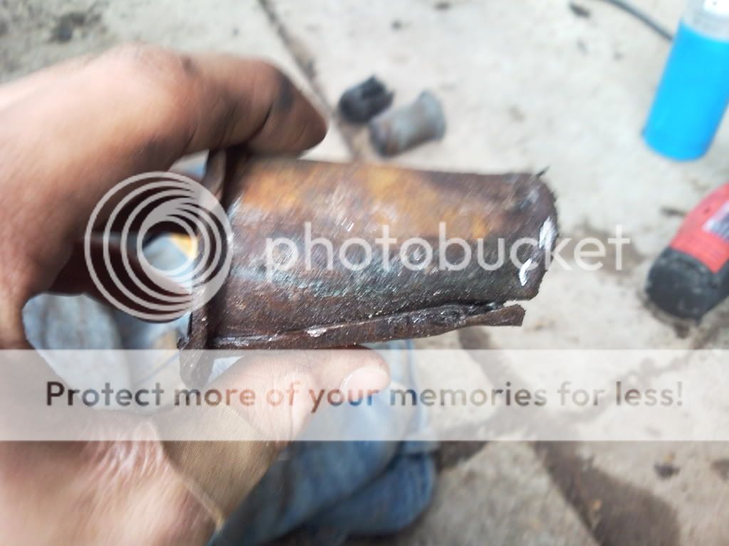

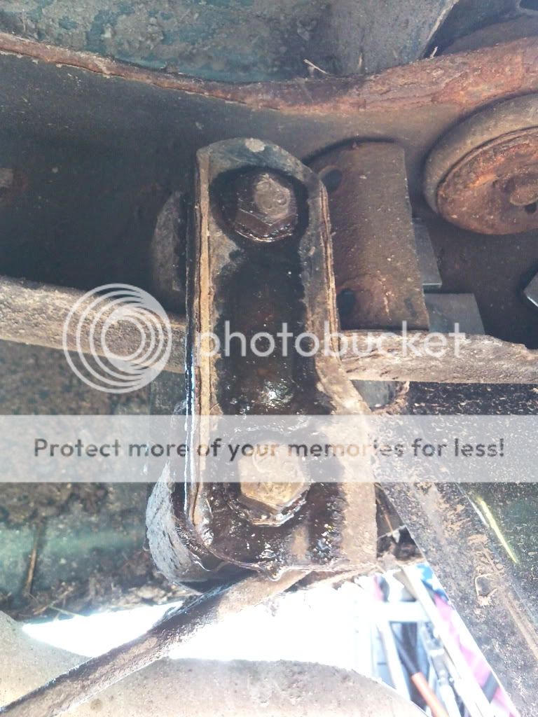

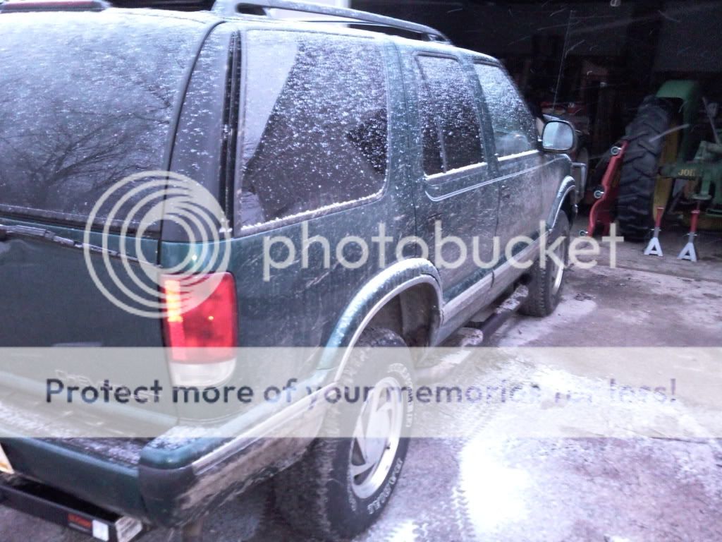

now came the fun part. the top bolts came off just fine. the bottom ones.... not so much. i ended up leaving my truck on jackstands over night cause i couldnt get the bolt out of the bushing. the next morning i ended up driving around looking for new bushings. i found some 20 miles away at the antioch napa. that place is awesome. of course i bought a pair online before i found out they had them there so i will just have to return them online.
so what i did was take a sawzall and cut the shackle so that i could see the rubber part of the bushing, then i took a drill and drilled out the rubber so that the bolt had a little more play in it. then i wiggled the bolt and rubber and sleeve of the bushing out leaving the metal casing.
i ended up cutting a slit where the eye of the spring doesnt connect all the way with the sawzall and just prying it loose with a screwdriver. looked kinda like this at the end:

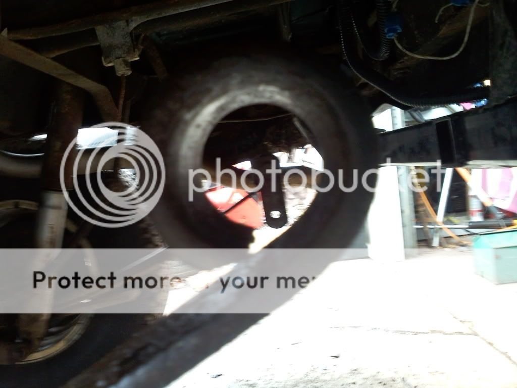

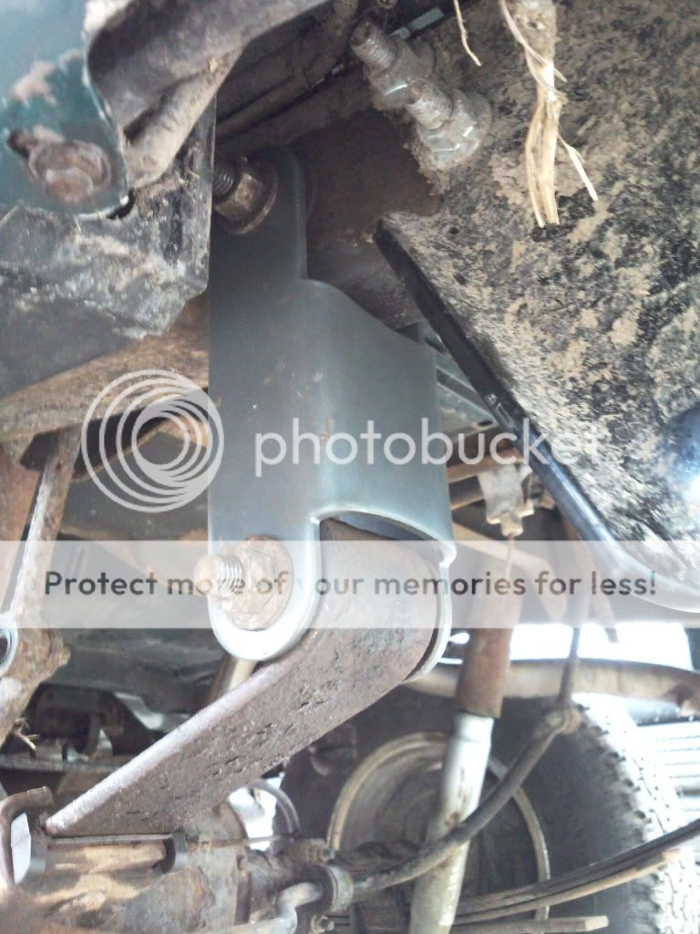

then getting the new bushing was a whole nother story. i ended up bolting the pieces of the shackle together with a really long bolt and just tightening it up into place. my hands are killing me but i got them in. the second one when way faster than the first. i also had to use some new bolts from menards since i couldnt get the old ones out.

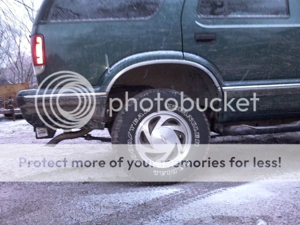

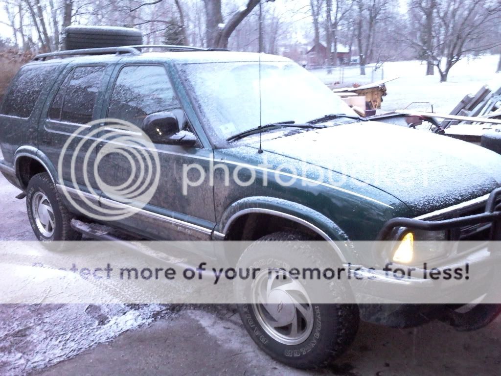

and finally the ride.

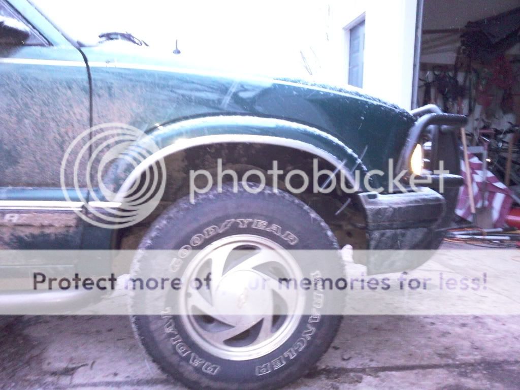

also cranked the torsin bars so it doesnt look retarded.
Overall i am very happy with the way it looks. it better look good for the amount of effort i put into it!!! well let me know what you guys think of the truck so far. my buddy is coming over this weekend and is going to help me nightshade my tails and driving lights. also going to pick and pull to find me a spare tire carrier!!!!! ill keep you guys posted if i find anything at the yard.

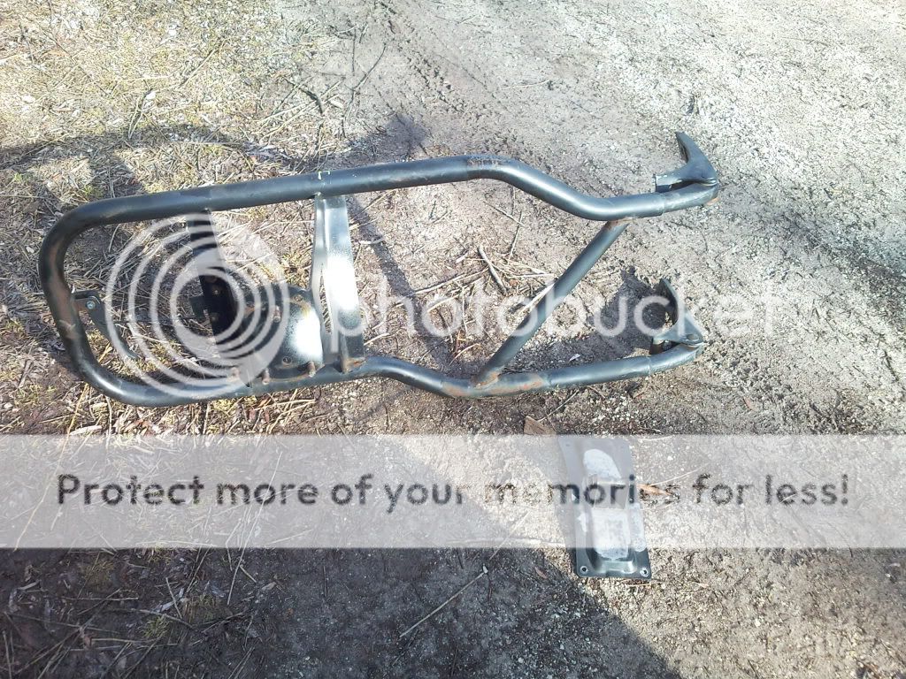

rear Spare tire rack:

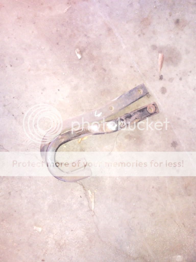

tow hooks:

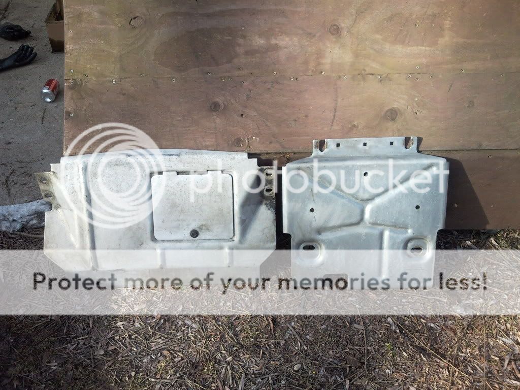

and the grand finale. ALUMINUM SKID PLATES!!!!!
well i got the front skid plate on last night while it was dark out!!! but the front differential one needs brackets that i didnt know i needed. so i will be heading out there this morning to see if i can pick them up. the tow hooks wont fit with my deflector on so i am going to take that off. it will make it look higher i think. the hooks will have to replace the bracket that holds the brush guard on so this is going to be a challenge.
if i cant get the other skid plate to fit im thinking about selling it. i cleaned it up and it looks just like new except for a few scratches on the bottom. but that just means its seasoned. these things were black when i got them but a little brakeclean and some mineral spirits later and they were shining.
as for the spare tire holder, i went to lowes and got all the hardware i needed. i want to clean up the holder and repaint it, get rid of the rust, ect.. before i slap it on. probably within the next 2 weeks it will be on.

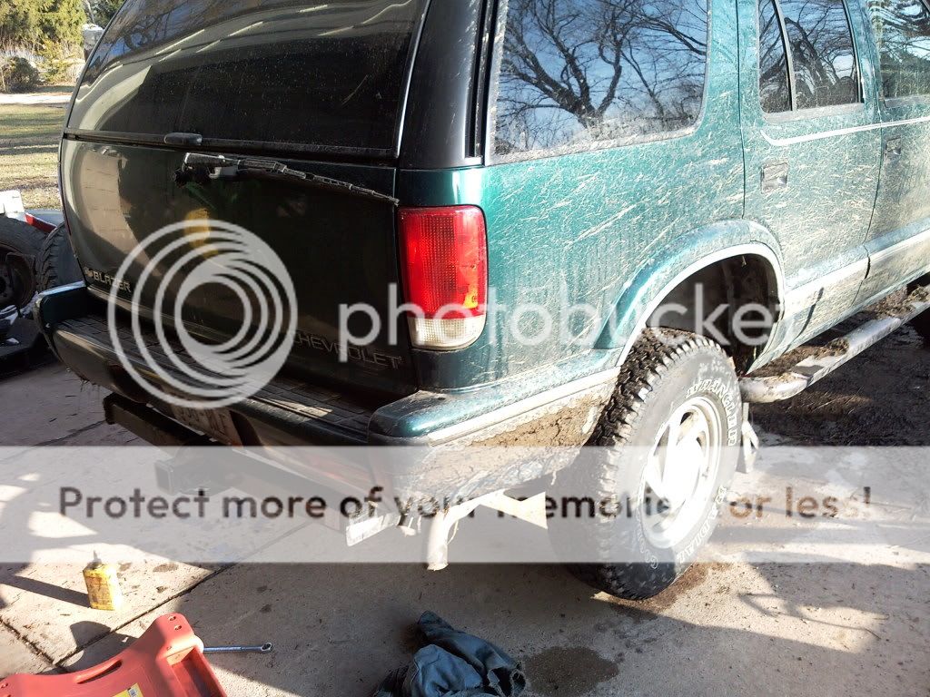

alright. update time. got the muffler installed and everything and it sounds great. great low rumble but not too loud on the throttle. just what i wanted. here are a few pics of the install and i will be sure to post a video as soon as i take one.
