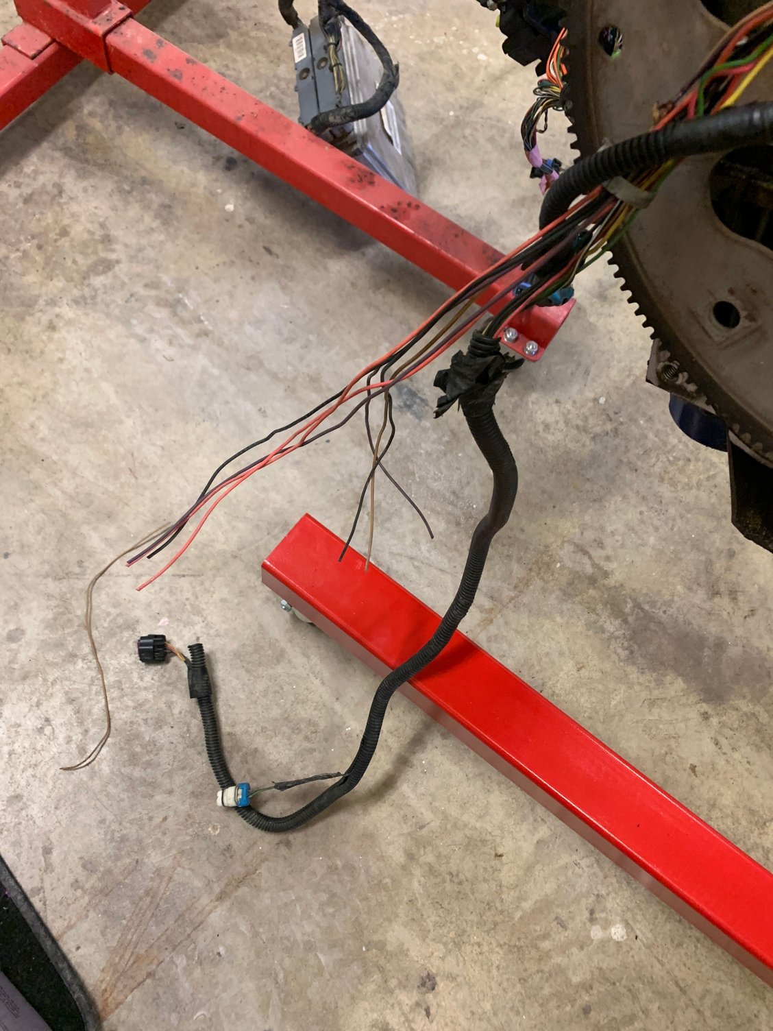

I will start taking wire harness off first and sorting that mess. Looks like motor was robbed of the starter. Some of the harness is also missing after closer inspection.
Cut wires
Starter is missing

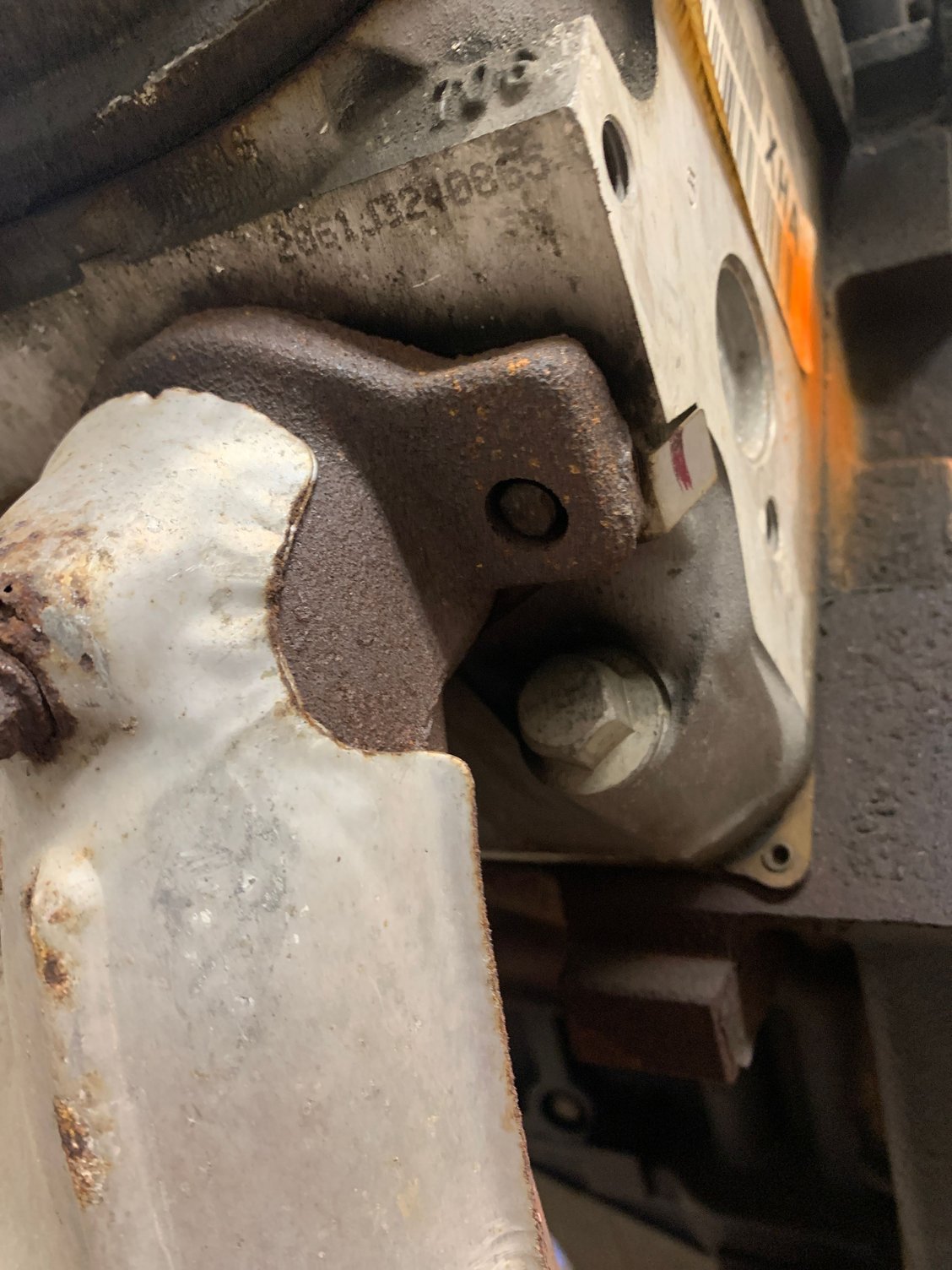

Broken bolt on manifold.

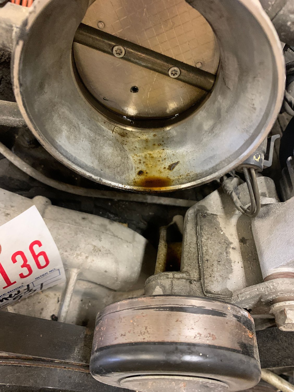

And now that it’s at an angle oil is coming out of throttle body. Ohh boy

Broken exhaust manifold bolts are VERY common on the LS engines of that time. You'll want to get those manifolds off and get a set of ARP manifold bolts to replace them with before you put the engine in.
I wouldn't worry too much about the oil in the throttle body. It likely is just from the PCV system. Those engines could recirc quite a bit of oil back into the intake and it could catch/collect in certain areas inside. What you could be seeing is one of those areas being allowed to slink forward in the tossing & turning of the motor in transit to your place.
It does suck that the harness is hacked up though. It also is unfortunate that you have a 4wd transmission from the donor and not a 2wd. Would have been nicer drop the whole drivetrain down in as a matched pair and use the PCM, everything.

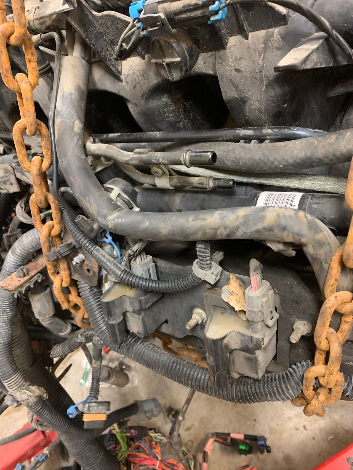

Great plan is to save money from buying a trans and get the servo from vette and beef up what I have. Imma get this engine cleaned up tonight and I’ll post some more pics. I don’t want to say I’m doing this or that because I don’t want to mislead anyone. I am taking one step at a time. A transmission guy will pop on here I’m sure but I don’t wanna turn this into a trans dispute. I think this has the return style fuel rail! I’ll post pic someone tell me!!
I believe this is what to look for on return style s10 came factory plumbed

That is a return style fuel system. I'm pretty sure all of the 00-06 (possibly 07) trucks came with this style fuel system. I have a 2004 Tahoe 5.3L sitting under my work bench at the shop that has the same setup. It needs a new crank & a few new rods though, but I only paid $30 for it years ago and I already used the brand new knock sensor wiring harness & set of knock sensors off it so it doesn't owe me a thing.
