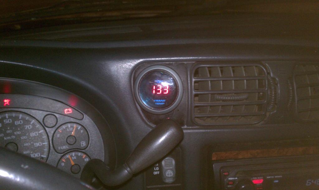

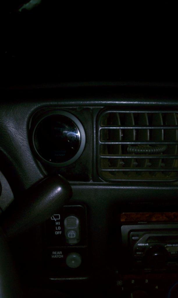

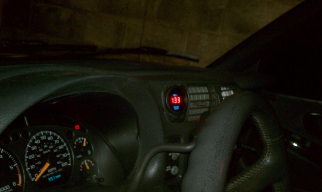

update, moved my trans temp gauge to my 4wd selector switch panel.
Attached Thumbnails The life and times Of James-transtemp3_zps436328e2.jpg   The life and times Of James-transtemp2_zps9e11b514.jpg   The life and times Of James-transtemp1_zps85668995.jpg

looks good pj, i normally don't like interior modes just because i like to keep stuff looking stock in there but that turned out good... looks like its meant to be.

uuum what did you do with the selector?

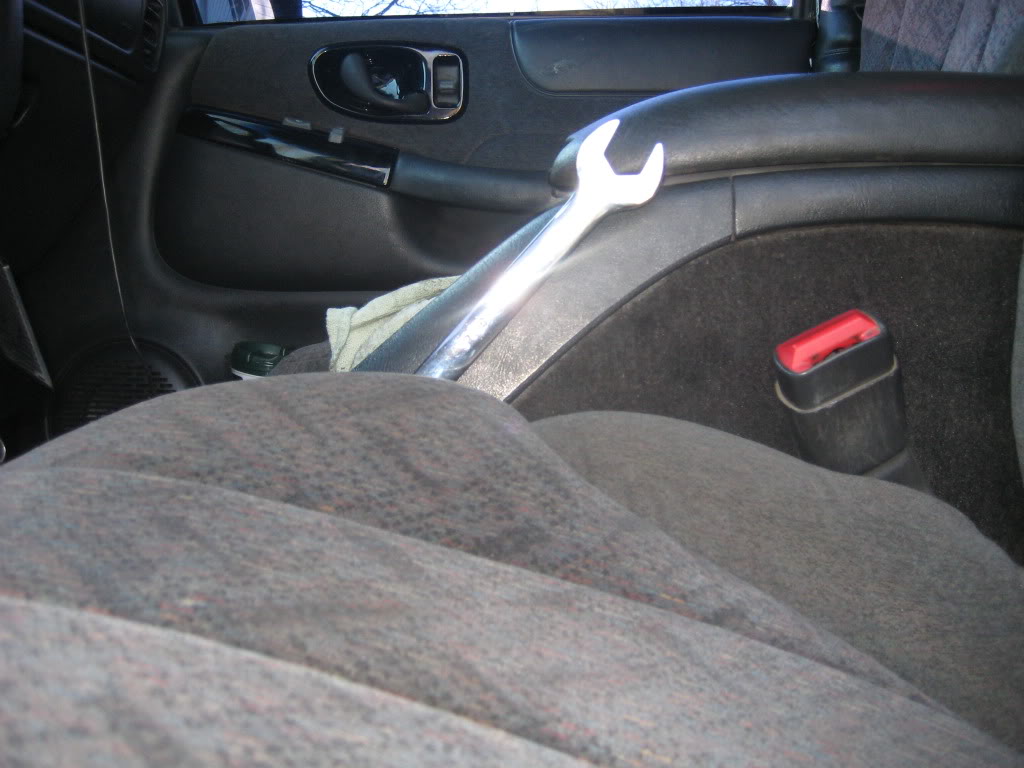

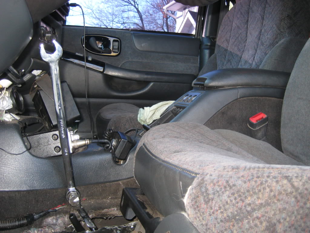

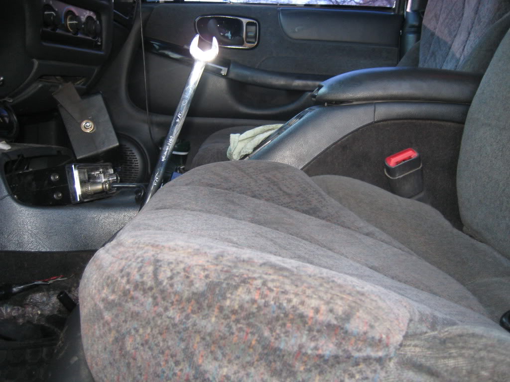

He swapped to a manual T Case. Pics from page 2.
Originally Posted by pj5454302
Pics of shifter
2 hi
4hi
4 low

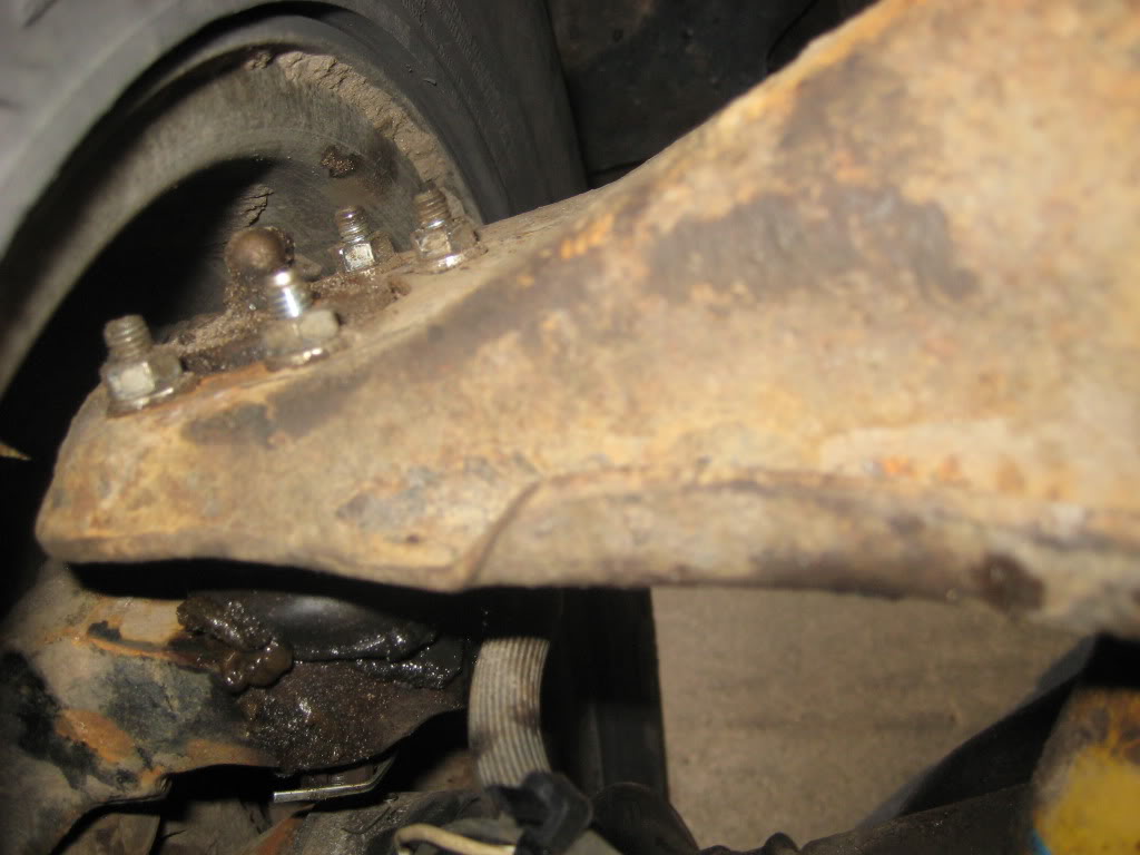

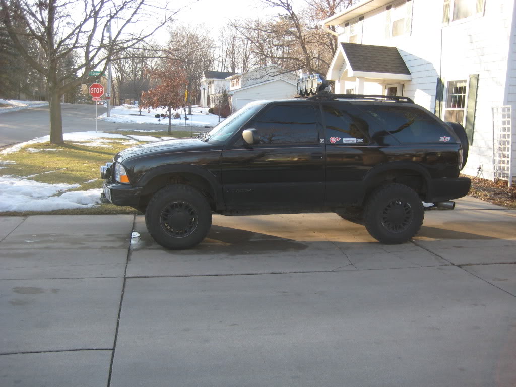

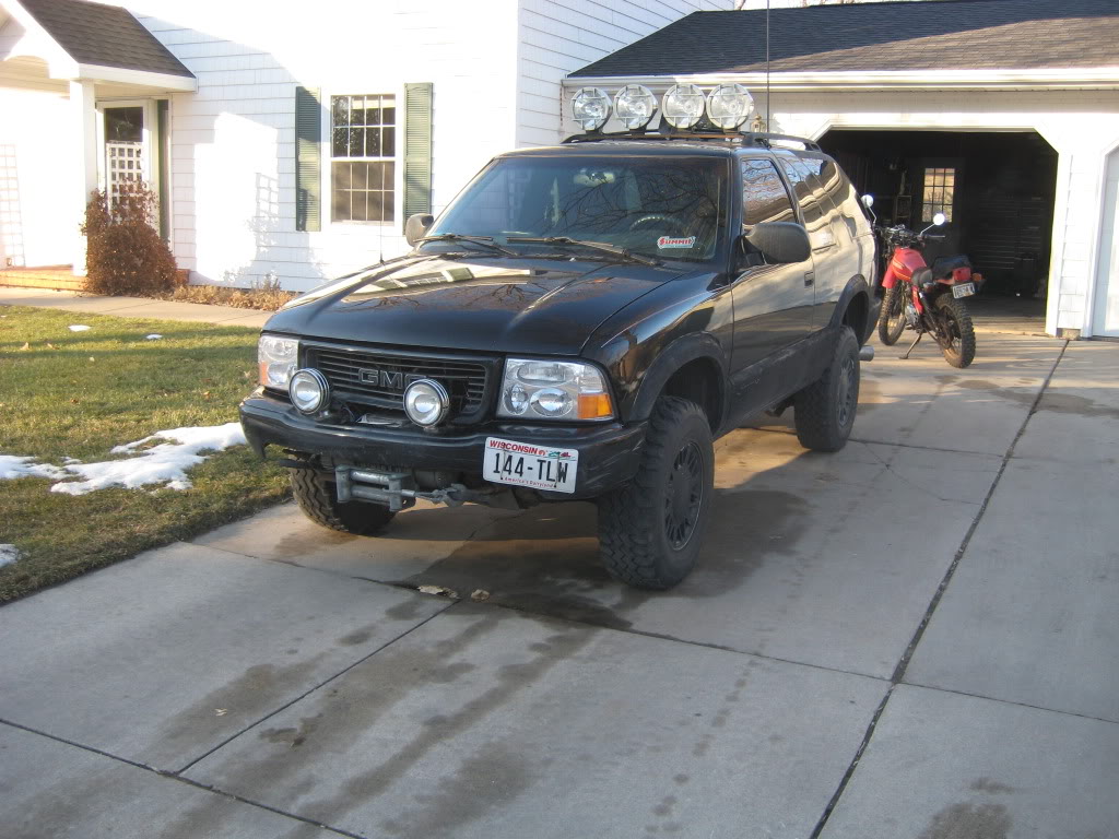

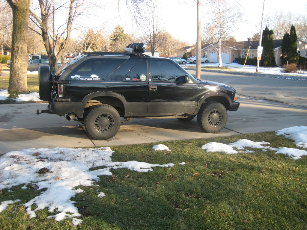

Oh And since my passenger side torsion bar was quite worn I added a set of lift keys lifted the pass side about 2inches and the drivers about an inch and a half. Also did a ball joint flip and than since I did it at my work ( i work at a gmc/caddy dealership) I aligned it promptly
pics
baljoint flip
Attached Thumbnails The life and times Of James-img_3096.jpg   The life and times Of James-img_3097.jpg   The life and times Of James-img_3098.jpg   The life and times Of James-img_3093.jpg   The life and times Of James-img_3092.jpg
Thanks, didnt like it down on the center console and since the 4wd selector wasnt being used I figured id put it there.
And as stated by random I swapped in a np231 transfercase which is a manual shift so there is no need for a push button selector.

that wrench tcase shifter is awesome. good job.
did you flip the rear axle to a spring over? i been thinking about doing just that and ball joint spacers on the front.

S'all good random. and its still spring under axle, have rear shackles and air shocks for lift
