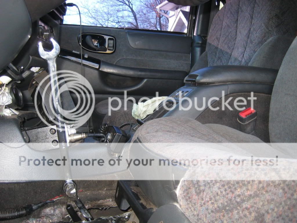

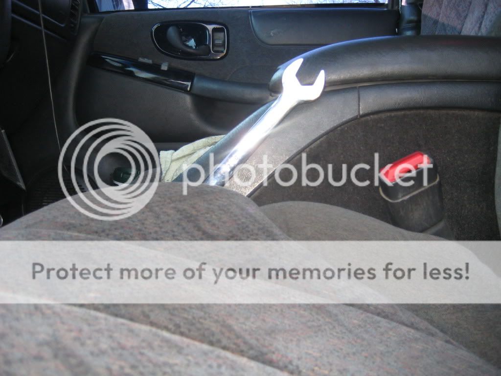

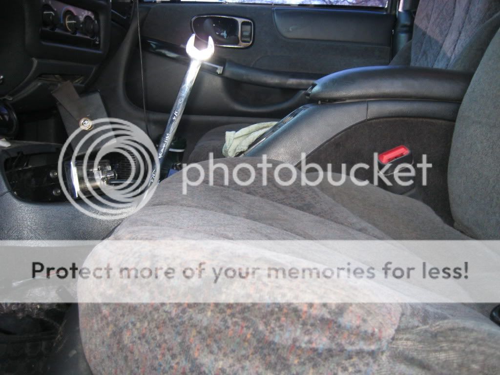

Pics of shifter
2 hi
4hi
4 low

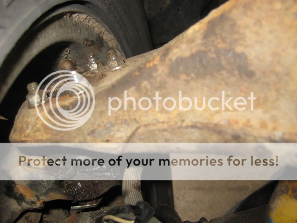

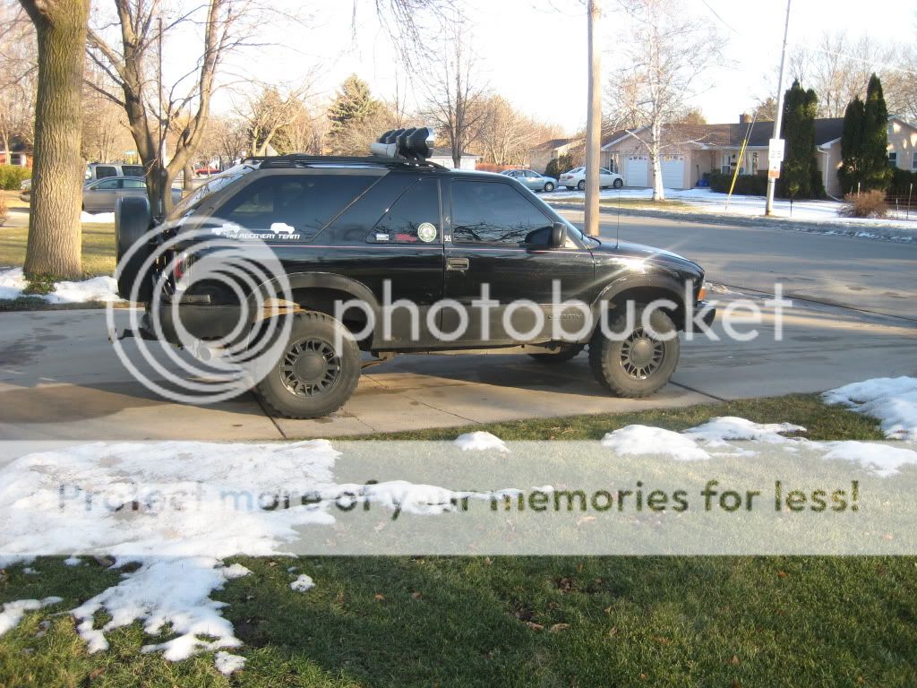

Oh And since my passenger side torsion bar was quite worn I added a set of lift keys lifted the pass side about 2inches and the drivers about an inch and a half. Also did a ball joint flip and than since I did it at my work ( i work at a gmc/caddy dealership) I aligned it promptly
pics
baljoint flip

Neat shifter

Any problems with the manual shift so far?
Old Feb 5, 2012 | 12:26 AM
  #28
pj5454302's Avatar
Joined: Nov 2009
Posts: 981
From: Green bay Wi
I have to ground a pcm wire when in 4lo so the tranny will shift but other than that no
