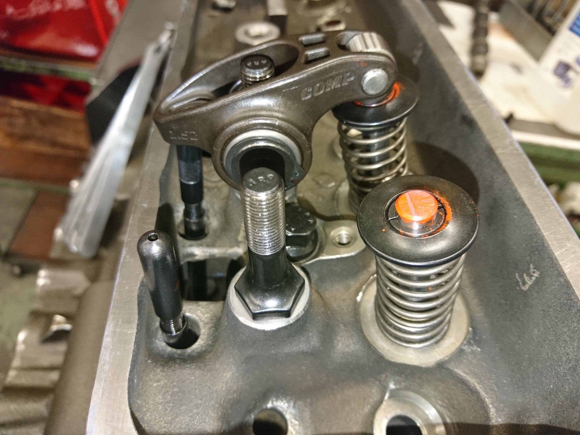

Head work. Finally got a couple of hours into the "missing link", the pushrods.
Block with one head placed with spacers (feeler gauge). The rocker screw-in studs needed quite a bit of chamfering as the radius below the shoulder of the stud into the 3/8" thread is very pronounced. Should have gotten the angle of the bosses when it was on the mill, then used a cylindric milling bit to cut down along the thread. Should be ok. for this low power, low rpm application.
Machinists dye to get the geometry right and finally get the pushrod length. The pushrods used are checking rods. After dinner going to re-assemble a second time and get all the same measurements again just to make sure.
Perfect witness marks. Starting inboard of the valve tip center and running the same amount to the outboard side. Minimum side loading of the valves.
​​​​​​The lift is a near exact 12.5mm which is 0.500". So the hydraulic lifters spring is much stiffer than the check springs I use to mark out the valvetrain.

Just having dinner, afterwards back to the shop. Turns out 7.250" pushrods are what I need. I measured 183 mm, add 1 mm for the hydraulic lifters and 184 mm / 25.4 = 7.244" (close enough).
The next step is addressing that bugger of a problem with the timing gear. As these engines have a balance shaft you need a specific timing gear. Unfortunately CompCams does not make them with an adjustable sprocket. When I had the head and valves on last week we found out that the cam is too far ahead by 6°.
That means boring the cam pin hole over. cutting out the bolt holes on a radius and inserting an excentric fitting to get it to the proper timing.
As usual with these R&D problems, you solve one - you get another one!

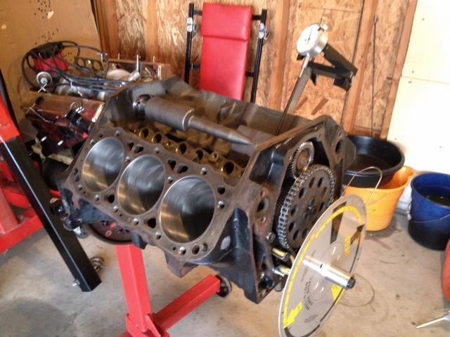

At 6 degrees off I suspect you are making an error in the measurement.
Usually the best method is to set the dial indicator right on the edge of an intake lifter with the head and lifter retainer off. Assume you are using a real degree wheel zeroed with a piston stop and a dial indicator.
LSA on this camshaft is 110 degrees. Camshaft has 4 degrees advance ground into it. So install on a 106 degree intake centerline by finding exact center of lobe. This is exactly halfway between 0.050 movement shown by turning engine from one side of the lobe to the other. Rotation should be normal engine rotation when running and you should turn the engine over with the flywheel (not disturbing the degree wheel or crank snout bolt). This is called the "Intake Centerline Method" for degreeing a camshaft.
https://www.compcams.com/amfile/file...product/25658/
Here is how I set things up to measure cam timing. I did have one piston in at the time with no rings to find TDC. Jegs provides a plate with a piston stop that bolts onto the head surface across the bore (not visible). Hope this helps.
When I did mine, I used a Mellings timing set with a Mellings tensioner P/N 3-8MMSRH72SB but not sure it will work on your block (1994 with a roller cam and balance shaft). I do know you have to use a specific plastic timing cover with the tensioner. In any case, a new stock replacement camshaft installed dead nuts on target.
My kit is a Jegs one. https://www.jegs.com/i/JEGS/555/81621/10002/-1
More instructions: https://www.jegs.com/InstallationIns.../555-81621.pdf
