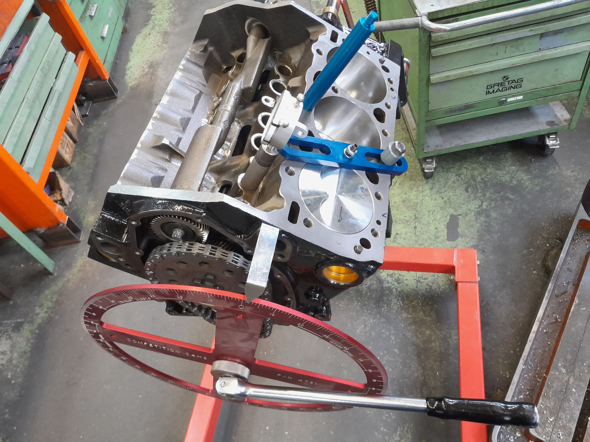

Next small step, verify the timing.
short block.
Unwrapping and putting on a stand. I have to verif, the timing.
Degree wheel and stop fixed.
On the stand. And now "lunch"
Finally, camshaft timing is confirmed. I can continue. Next to the cylinder heads.
NOPE, no luck

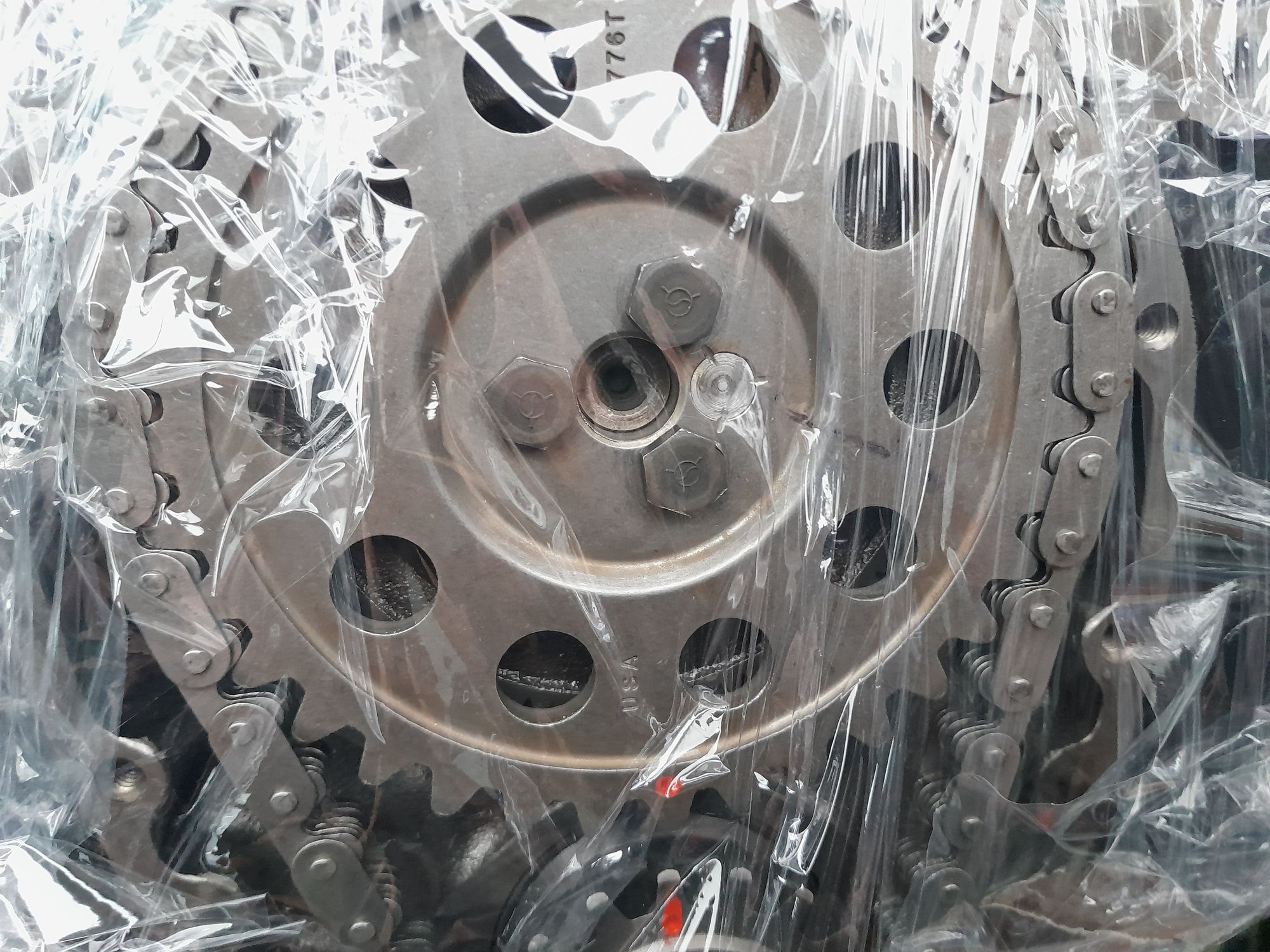

Comp Cams grinds 4° advance into the camshaft, so the intake C/L is at 104° isof 108°.
"crap" - machining again .
Cutting oblong holes for the fixation bolts. Now the hole for the excentric keys.
The boss will take care of that tonight.

Retarding the cam centerline vs. the crankshaft with a gear drive which is not meant to be adjustable made us fumble some more.
After cutting the holes into oblong radius holes and opening up the cam center pin hole to accept the COMP CAMS degree bushings i csn proceed.
picture of the assembled valve chain on the block.
