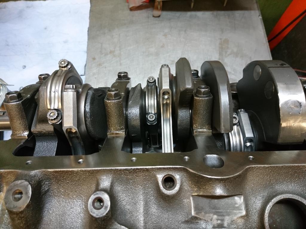

Got one step further. Assembled all the rods and placed all the bearings. Then test assembled the block. Now it is ready to be measured for decking and honing.
A first measurement shows that the pistons are at the correct height below deck. (0.40 mm about 0.016")
With a 0.027" gasket it will create the right amount of squish. Have to check against rocking pistons but it is where it is supposed to be.
If we have to cut the deck further down, I have the option of using a 0.030" gasket giving us a lot of freedom to cut the deck.
With this setup which turned out nearly perfect for this block I have the option of decking again in the future. Eventually by shaving off a bit of the crown of the pistons.
For now it seems the right setup.
The assembly of the rods is a lengthy thing. First torqued a test rod and measured the bolt stretch. Turns out it will need more torque than indicated. So made a compromise in between stretch and torque to reach reasonable values. Disassemble again, then chamfer all sharp edges, wash, clean, dry. Wipe with a lint free cloth, set the bearing shells. Torque to specs, then measure the bore. The EAGLE rods are amazing and the bearing shells as well. Exactly within specs.
Then open up one bolt and measure how much it opens. This is an indication of bearing "crush". The shells are slightly larger in diameter than the rod big-end bore. This is the force which keeps the bearings from spinning. Simply crushing them into the bore with a given amount will yield enough friction to keep them where they should be.
Then take the rod apart, Re-apply ARP bolt lubricant and set ready to assemble.
The test assembly is made with all the rods and pistons in their correct place but without piston rings. Marked all the pistons with an arrow pointing forward to facilitate correct final assembly.
The V6 rod's are asymmetric and need to be placed correctly in order to be centered in the bore. With pistons such as I have, with a sliding piston pin, they could eventually be assembled in the wrong way which would cause all sorts of problems.
Pictures showing:
Rods with bearings shells. Unfortunately we could not get tri-metal bearings for the rods. But it's no race engine so the OEM stuff will do.
#1 rod with the bearing shells, the others ready after chamfering.
Picking the rod pin diameter and setting into the micrometer, then transferring into the bore gauge. Measuring proper bearing clearance against rod pin.
Measuring bearing "crush".
Asymmetric assembly.
Finished assembly from below. (crankshaft side)
And the assembly seen from the deck (or cylinder head) side.

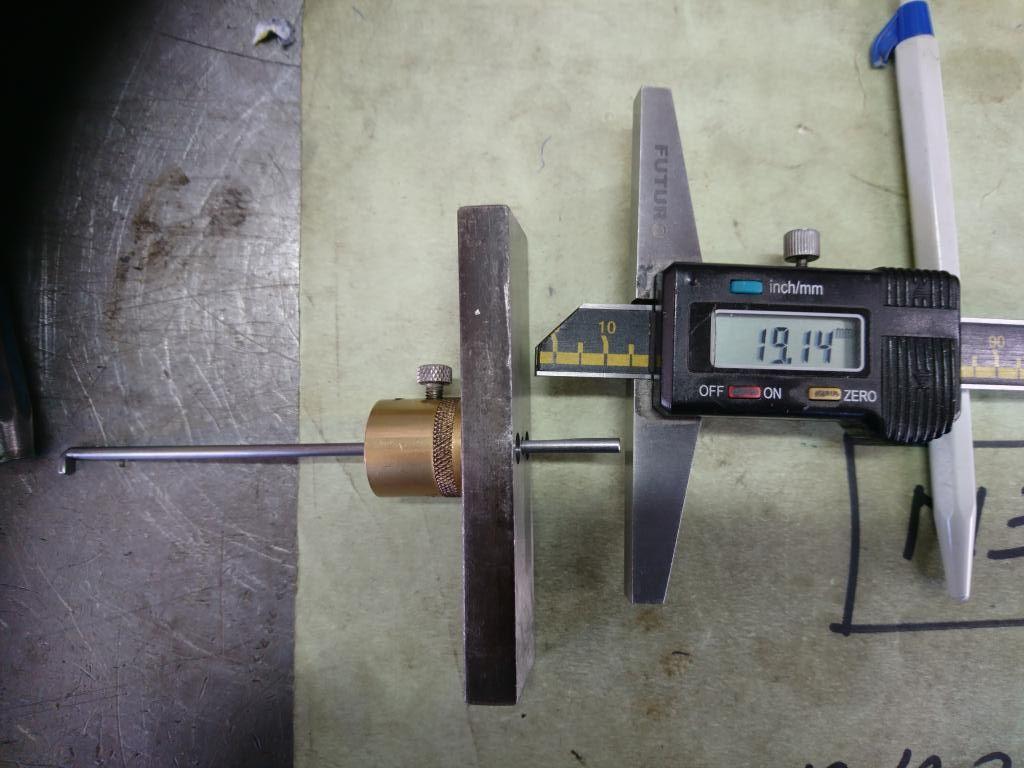

The rocker stud bosses have been machined and tapped for screw-in studs. These heads are the same as for the TPFI the little dome on top of the runners is for the injectors spraying to the valves.
19.14 mm is roughly 3/4"

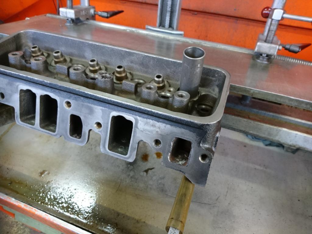

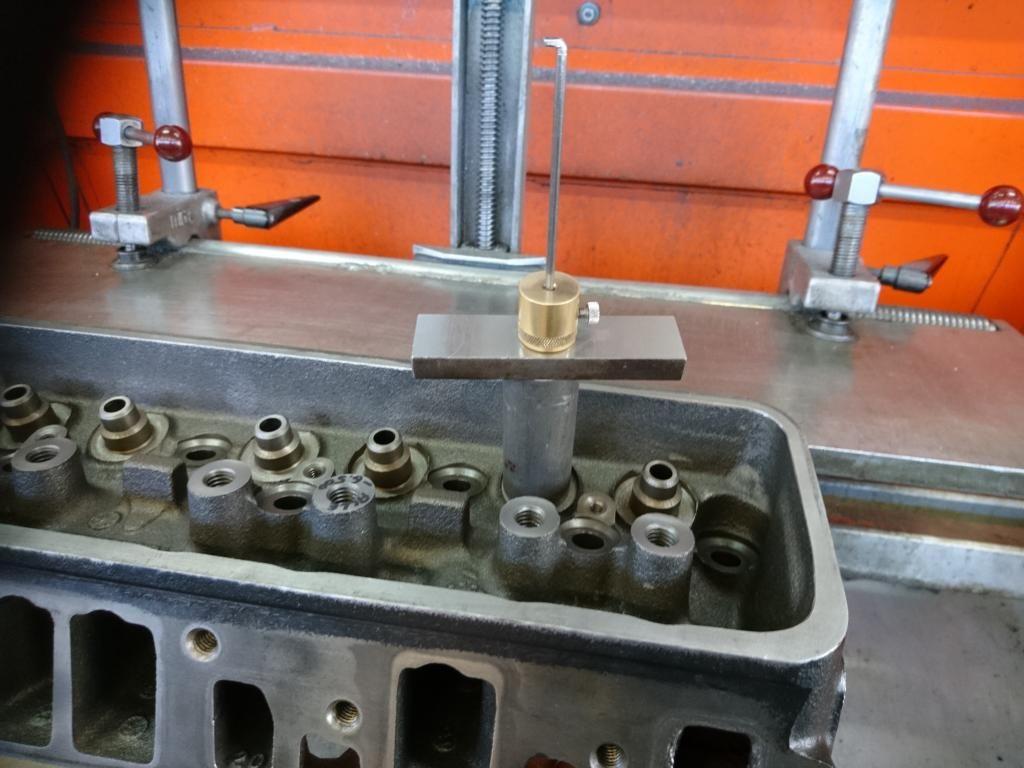

To determine the quality of the seats I have measured the valves protrusion above the machined surface where the valve-spring will sit.
Simply by using a piece of steel tube that has been ground to exact length (70 mm - roughly 2 1/2"). The tube is longer than the valve stem when sitting on it's seat.
Measuring the distance down into the tube and subtracting from the length I know how far the valve stems protrude.
Mind you! The 1994 has rotator-caps on the exhaust valves. In order to achieve the same spring pressures GM has machined these spring seating surfaces deeper than the intakes.
Therefore I will have less spring pressure on the exhausts without shimming. Now the shims need to be about nearly 1/4" on the exhaust springs and 1/8" for the intakes.

Images show one of the heads, my machine-shops special tool to measure depth and the Manley valves with K-Lines ready in their box.
