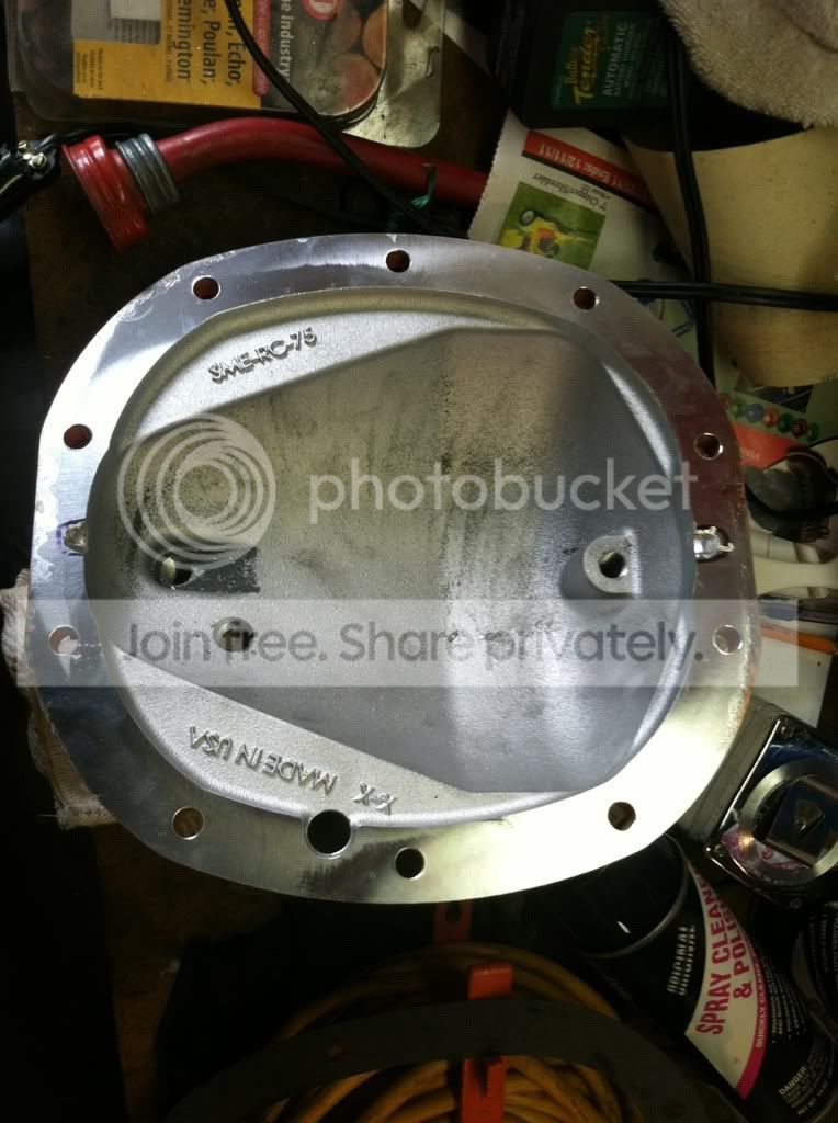

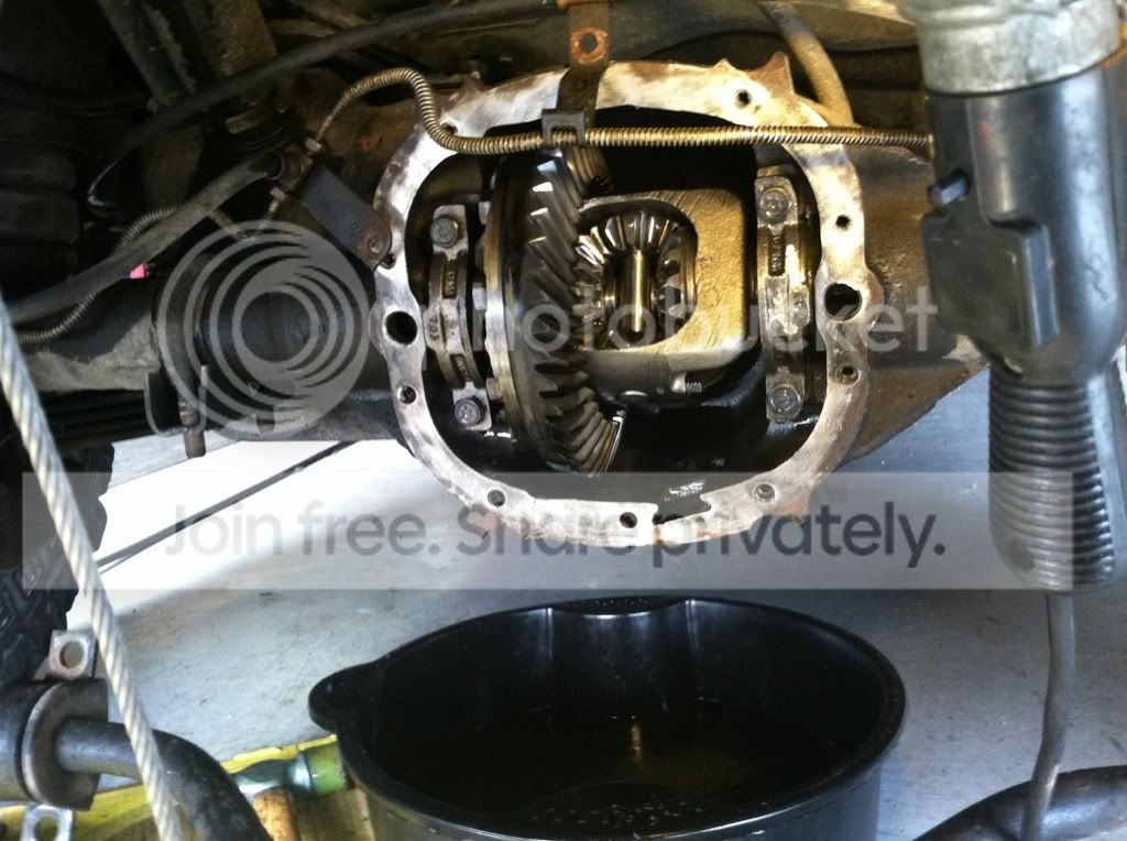

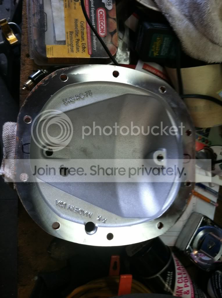

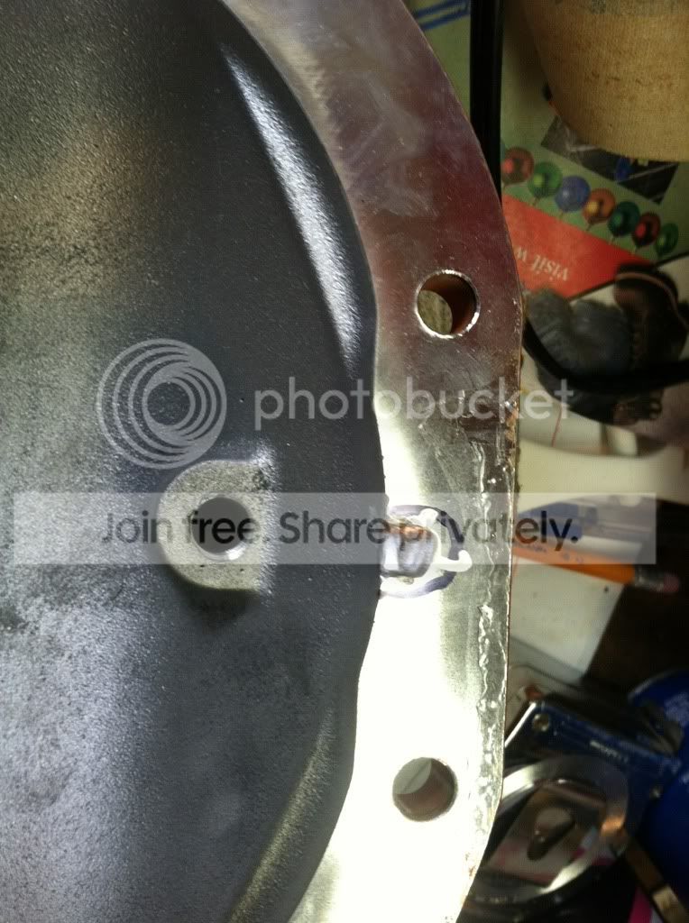

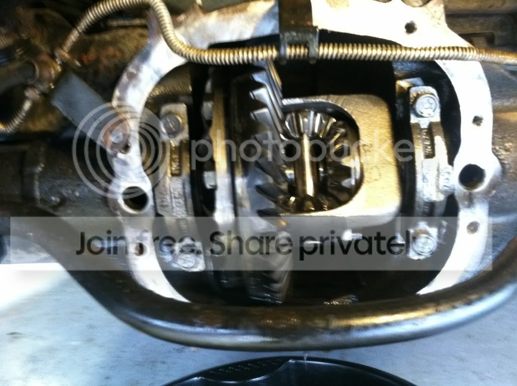

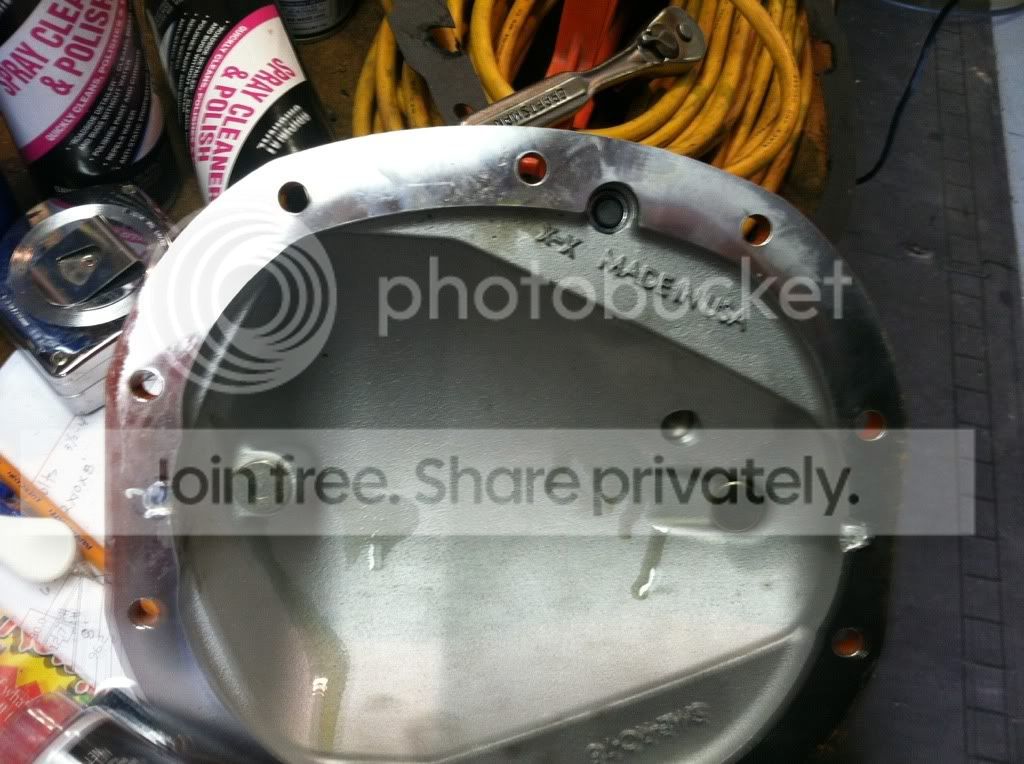

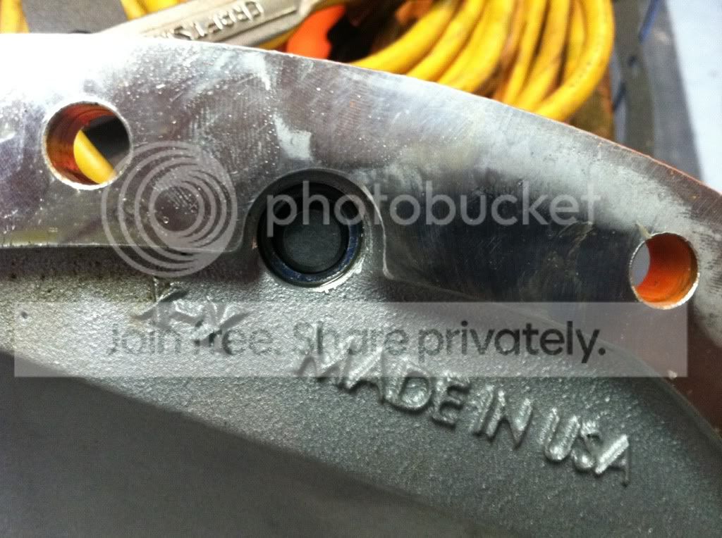

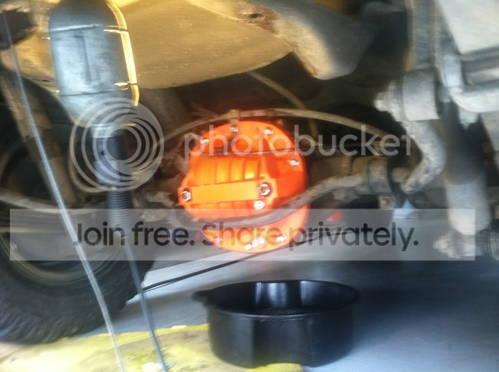

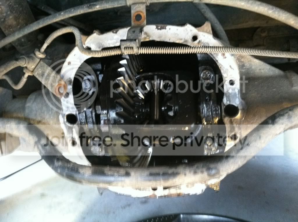

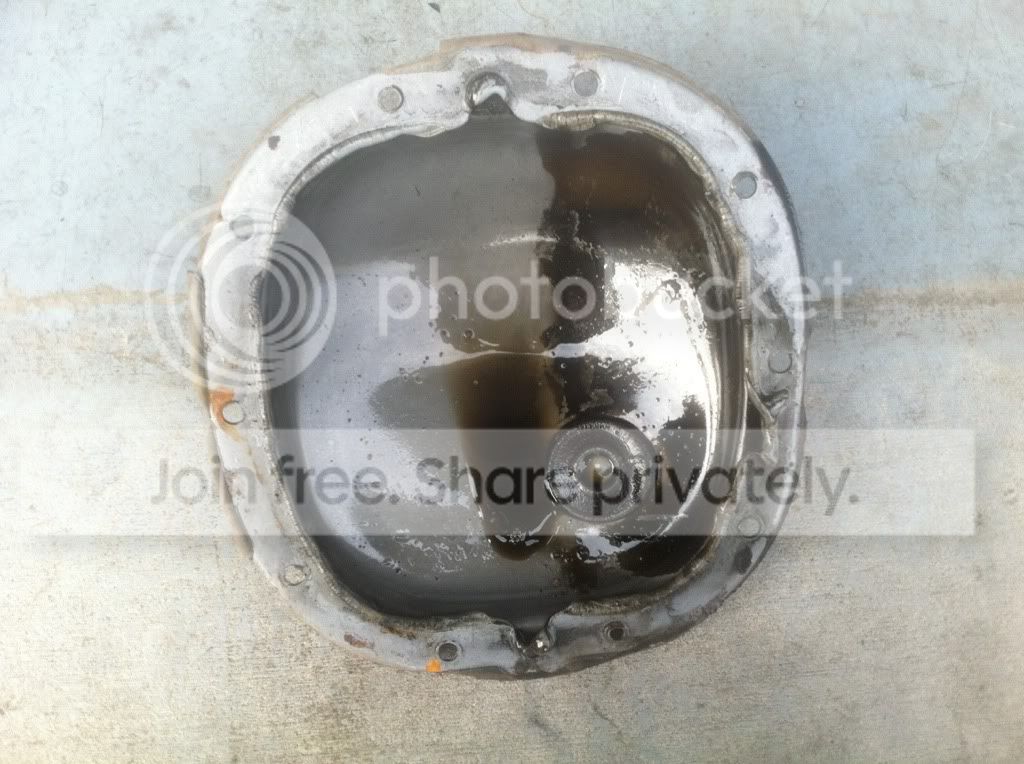

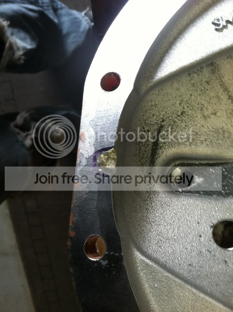

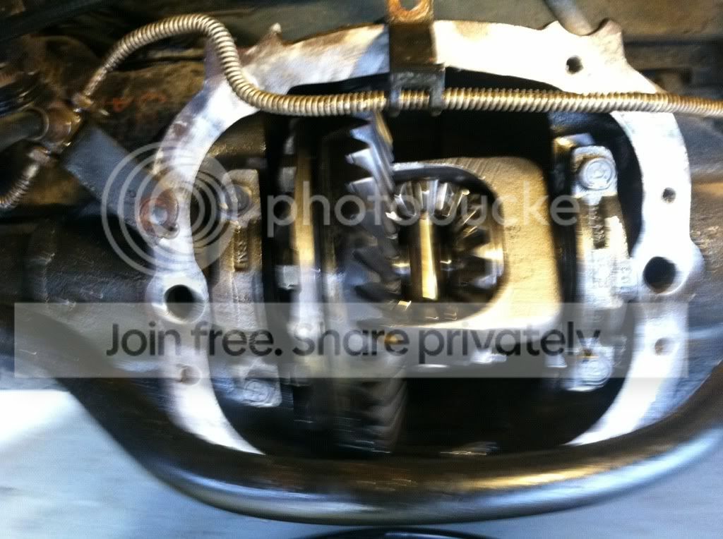

Well it's been a little bit, Haven't done the DS headlight bracket yet but I'll get around to it eventually. Did mess up my rear diff cover on the trails so I replaced that. Got my front diff full of water so I changed the fluid in there as well. Here's some pics of the Diff cover install.
Here's the metal shavings on the old cover
all pulled apart
Cleaned up and ready
Had to modify the new cover for the bearings to get oil. So i marked the gasket
Then used a dremel tool to groove the cover so the oil can flow to the bearings.
oiled the support rods and put in the fill and drain plugs
Also (did this yesterday before starting, painted the cover so it doesn't corrode.
and all put together
Keep in mind if you do this the new cover won't go on unless you take the rear swaybar off the axle tubes and move it out of the way.
