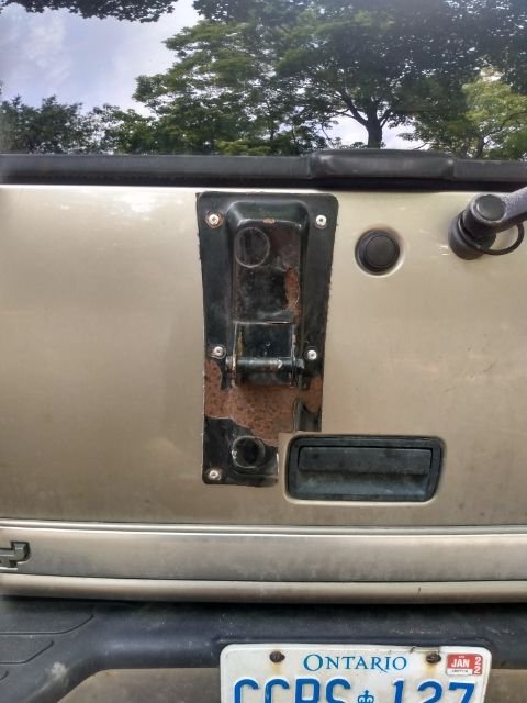

Now I have to look into a complete upper door hinge setup, probably do the bottom at the same time. I think I'm gonna try the bolt on ones, but weld them on. Hopefully the metal isnt too bad to work with...
anyone try this approach?

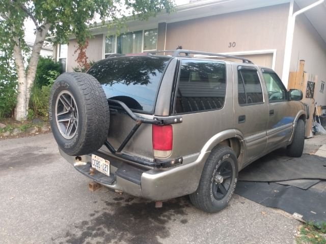

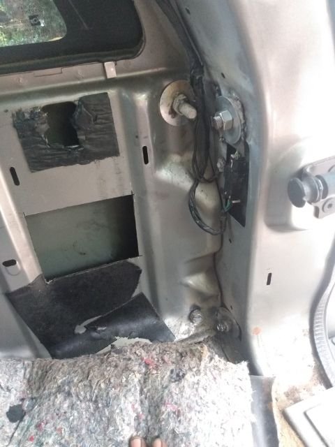

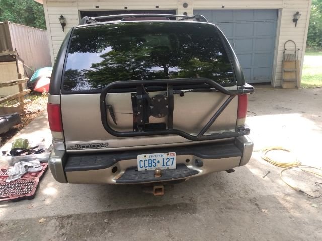

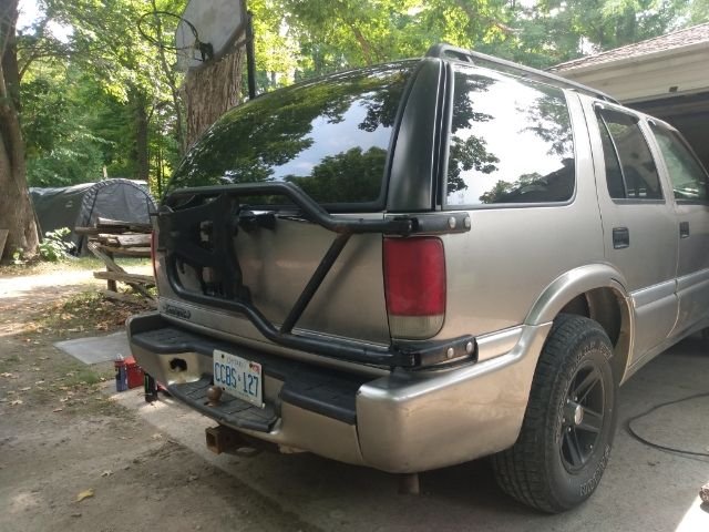

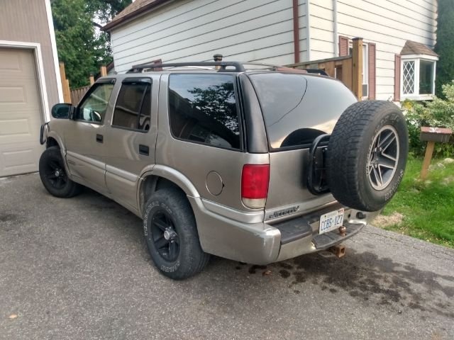

Tire carrier finally installed. Went a little different then the blazer, notice some wear on the body panels of the blazer. So gonna redo that.
I went with longer bolts above and below the light with some reinforcement... cut a hole to access the 2 "middle" bolts...
Fits nicely
Had to cut the side bumper to fit the lower hinge
Rivets hold better then screws
Welded whatever nuts i could access so they dont loosen

Nice install!
I've been saving how people have installed their carriers for reference when I install mine. Sadly it always seems to be a "I'll get to it next summer" project.

Thanks! Definitely feel better about this one... cant remember when i got it lol...
the blazer needs to get redone now... let see how long that one takes...

And tire is on... rims look familiar?

Looks great! I need to find 2 of those! Both the blazer and the jimmy need something to hold a spare! The original under body ones were rusted beyond repair.

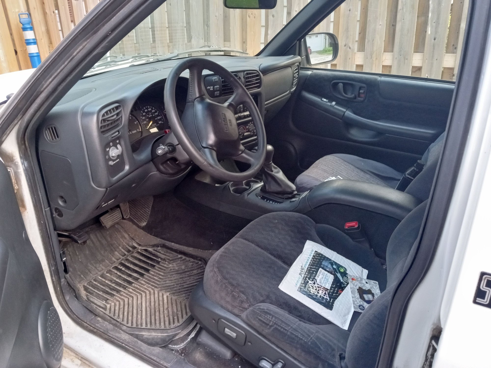

So after putting all that time and money into her, I figured I can find one that'll last longer for cheaper then putting more money. She needed more work. A leaf spring broke on the passenger side, the rust was starting to take the body mounts, and well many more important areas. So I went online, and I ended up finding a 1 owner, better condition with 100k less, 2000 GMC jimmy. Only difference is this one is white with black cloth interior, and a 3 button setup. So been swapping parts, and trying to get the neglected ride back to shape.
I looked under the seat covers and floor mats, and they are in great shape. Going to swap the heated seats in and get seat covers tho
