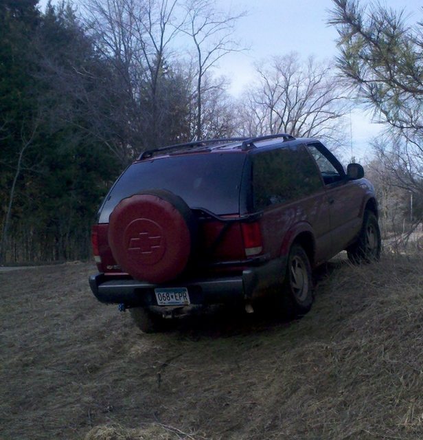

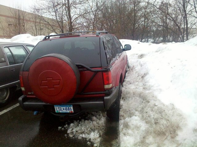

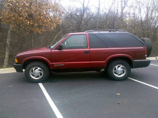

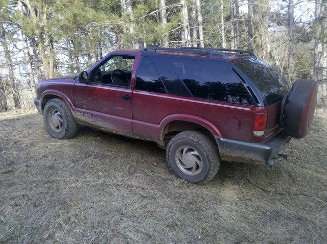

I'm calling this a rebuild, because lately, it seems that all I've been doing is replacing parts on the thing to keep it going. That being said, with the winters we get in MN, I wouldn't trade my Blazer away for anything, except maybe a newer ZR2. I know my posts will be sporadic, but bear with me, as I REbuild and build UP my old machine.
Background:
1997 Chevy Blazer 2dr LS
160k miles on original engine and original transmission.
What I've already done:
Painted the Pillar between rear windows black
Custom spare tire cover
Added a hookup in rear for the Ramsey QM 5000
New front and rear U-joints
New Radiator
New Alternator
New front CV Joints/half shafts

I really like that tire cover! Thats awesome.
It took me a while to figure out why your ride looked so different, and I couldnt figure it out... Then I actually read that you painted the pillar in the back and I was like "Doh, I shoulda noticed that one!"... Makes me think S10 with a canopy. Thats the first time I have seen that part not body color. I think you should do the whole roof and doorframes to match, that would look sick.

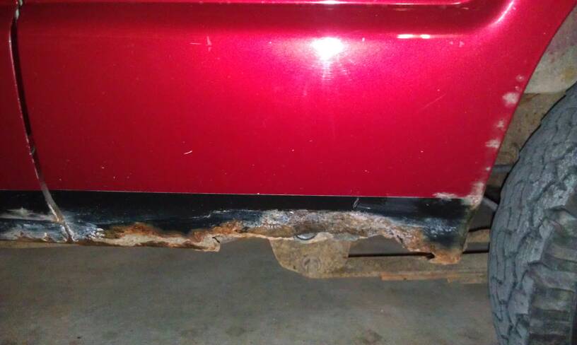

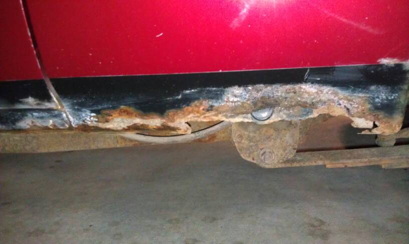

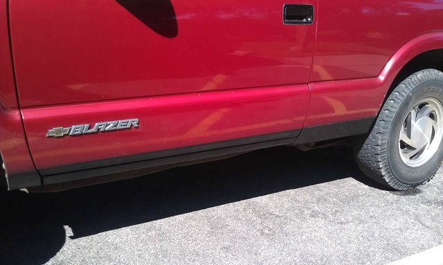

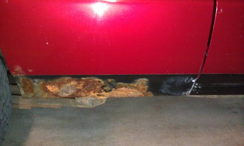

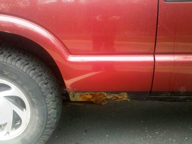

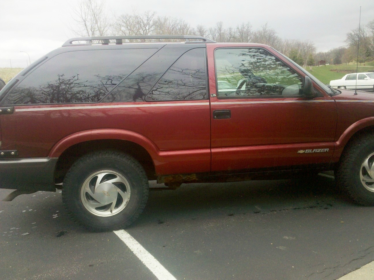

Below are some close up pictures of the rust I'm really wanting to repair. Remember, this is a 2dr, and the bad areas are behind/more rewards from the door.
- passenger side -
- passengers side too -
Would replacing the rocker panels fix this, or do the rocker panels only replace the door area? (Raybuck Autobody Parts LLC) (Raybuck Autobody Parts LLC)
Overall question is, do the rocker panels from above stretch from font fender to rear fender, or do they stop before the rear fender and if so where? I wish we had a shot of these highlight or circled while on the tuck. Or should I be looking at rear fenders instead?
The drivers side rust is in the same location as passenger side, directly behind the the door towards the rear of the vehicle.

See the welded seam right below the door jamb? (I can highlight if it's really necessary) From that seam forward is your rocker. Rearward is the rear quarter panel (or, fender as you called it)

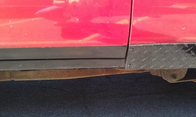

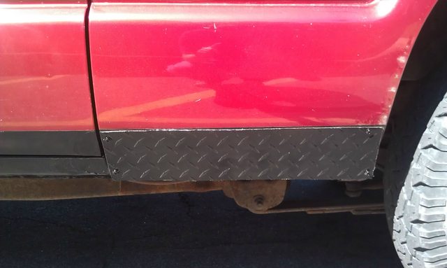

So, I spent some time on the rust issue and came up with a good, but tempoary fix, as seen below.
Before:
After:
After:
After:
I put up Diamond plate aluminium to cover the gaping hole of nothingness on my bottom rear quarter panel. Mounted it with some screws into what remains of the body, and then hit it with "rust proof" paint, followed by a black gloss. After this I'll get some Herculiner bed liner on to really seal it up good. By the time this is done, and I've gone over the rest of the rear quarter panel with a grinder, paint, and Herculiner, I bet I'll have a two tone paint job going on.
