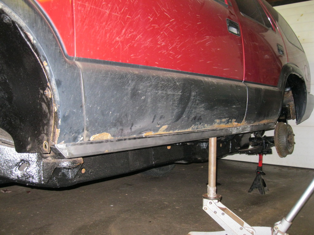

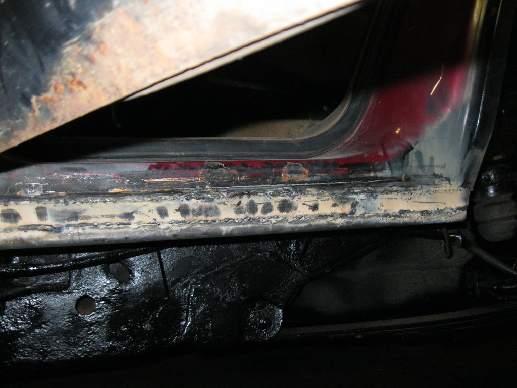

Hey Rex, I'm adding sliders too but a bit different. My rockers are a tad rotten so I cut them off and replaced them with 2"x3" tubing. I had to add a relief for the door post. I also angled the front to clear 31's sometime.
and add a 1" strip to match the bodyline and tie in the edge of the doorsill.

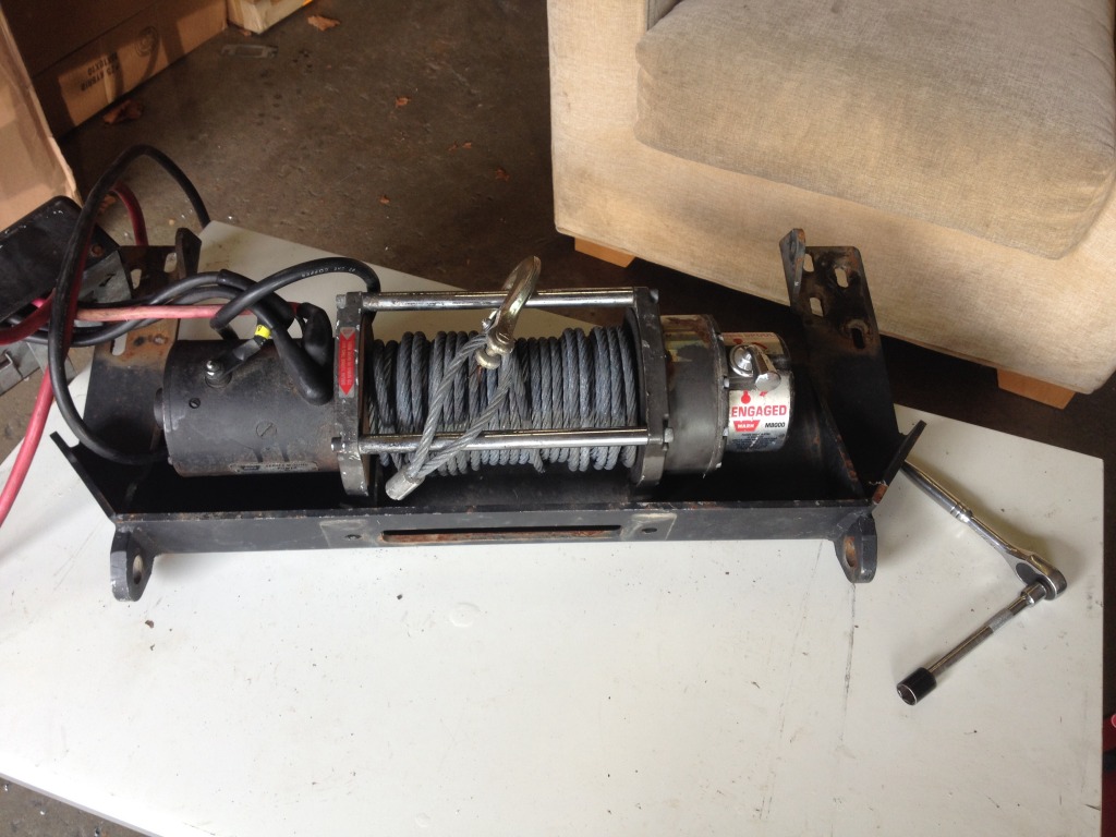

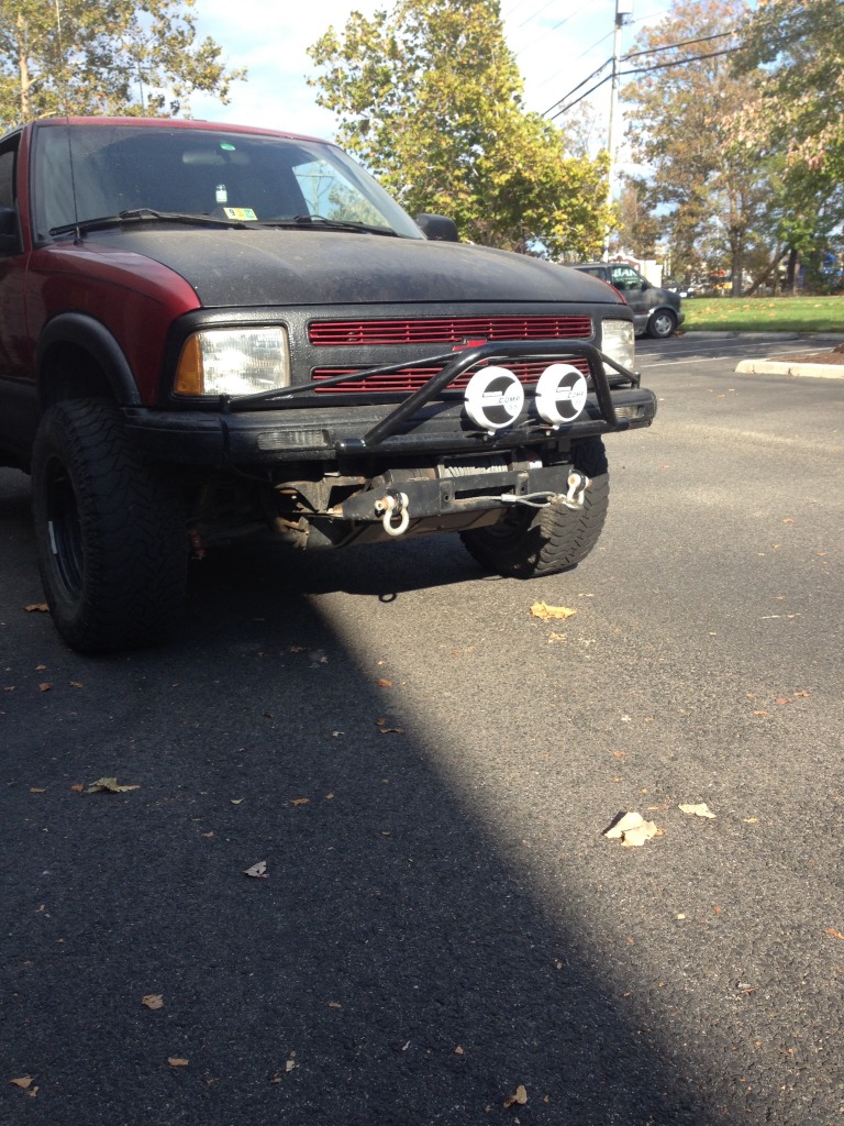

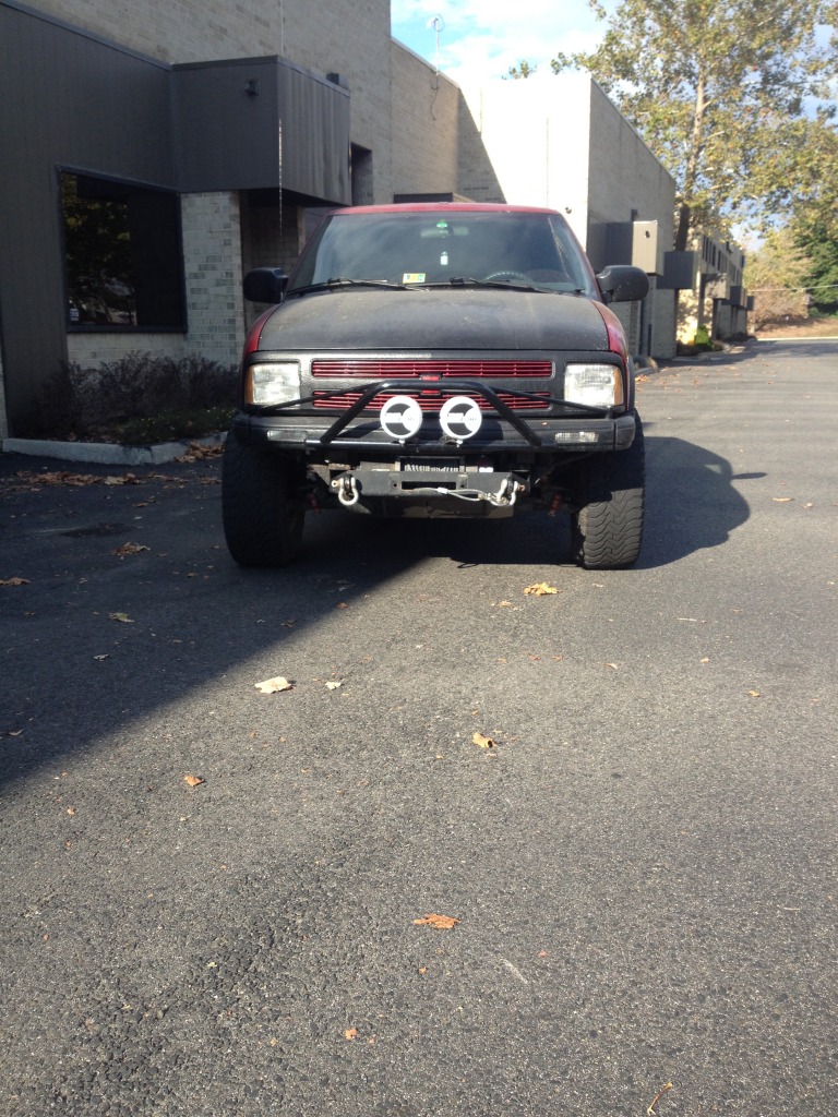

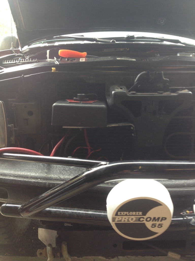

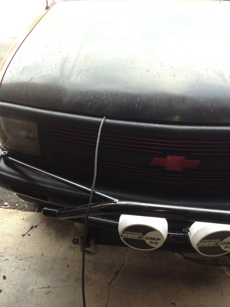

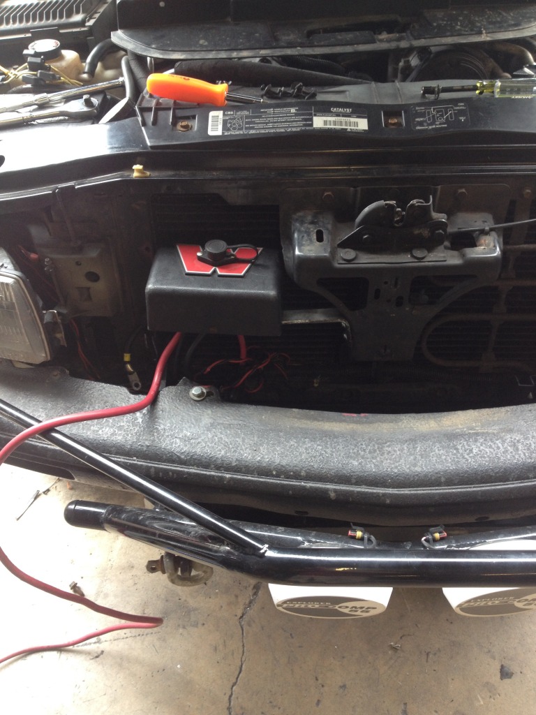

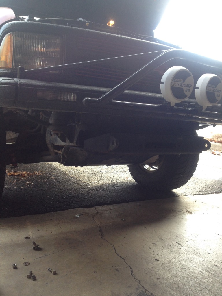

Well I got the winch mounted today I still have to do the wiring but I need to order some terminals cause I am gong to have to extend all of my wires. On with the pics!

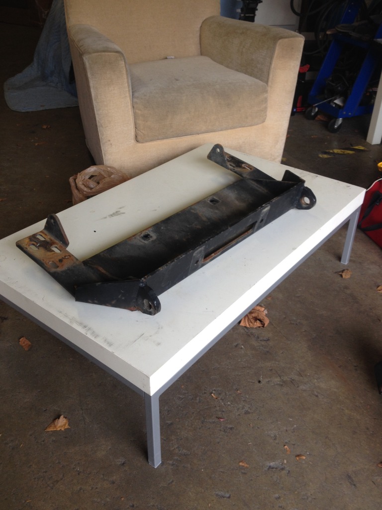

Its an ORD mount I am happy with it for what I paid I will probably modify and raise it when the time comes to build a bumper since I feel like I have lost alot of approach angle with it on there.

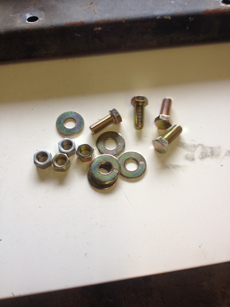

All grade 8 hardware (except two nuts cause HD was out)

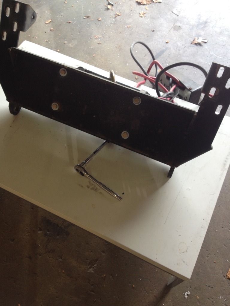

Test fit

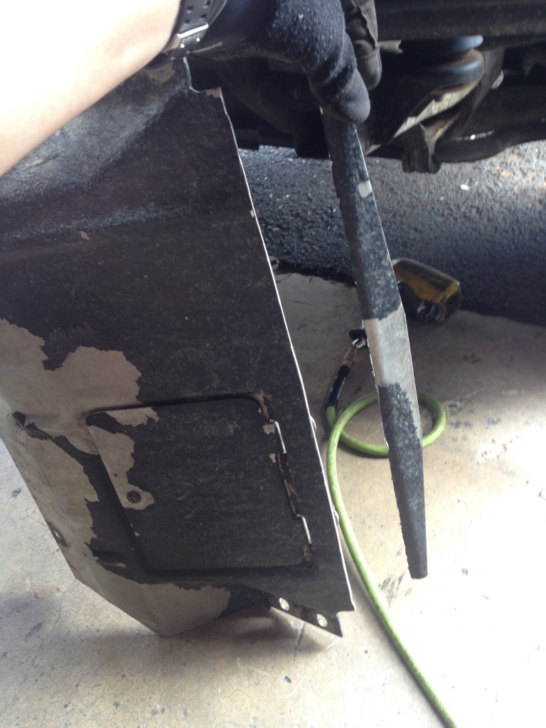

I had to cut a bit off the factory skid to make the mount fit correctly
Test fit without winch

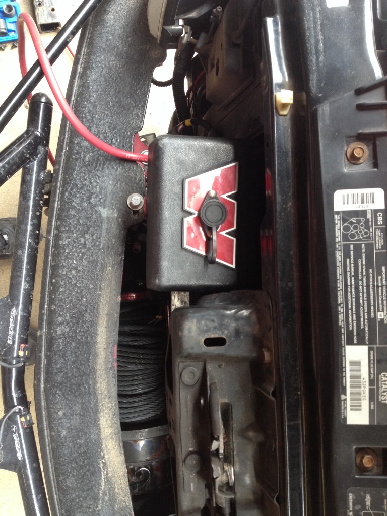

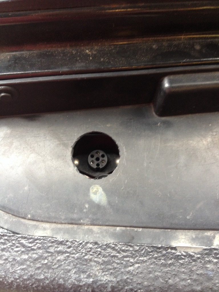

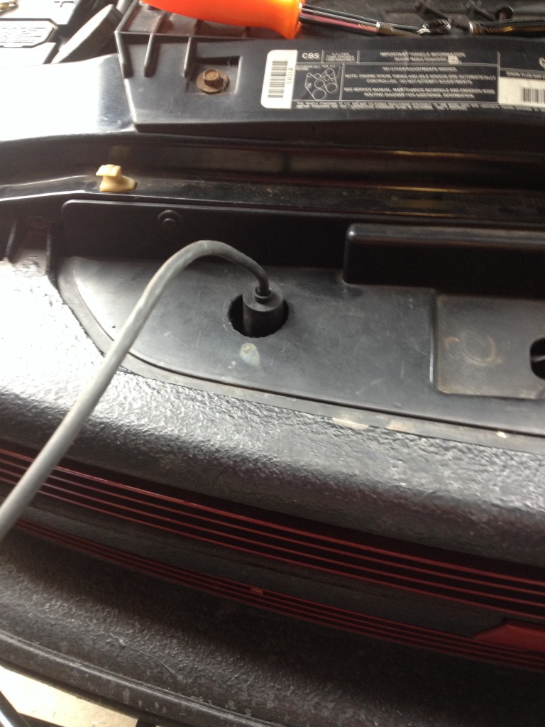

This is where I mounted the control box.
And here it is all back together. I am happy with the way it came outnice and clean and with the exception of a small bit of the frame horns I didn't have to cut anything off of the truck!
Its nice and recessed so it is hidden and out of the way but still very easily accessible
I set it just low enough to be able to close the hood completely with the controller plugged in.
I sill need to cut the spool handle off and mod it so that it is longer and accessible without reaching behind the grill. I figure I will do something similar to the controller with a removable handle of some sort.

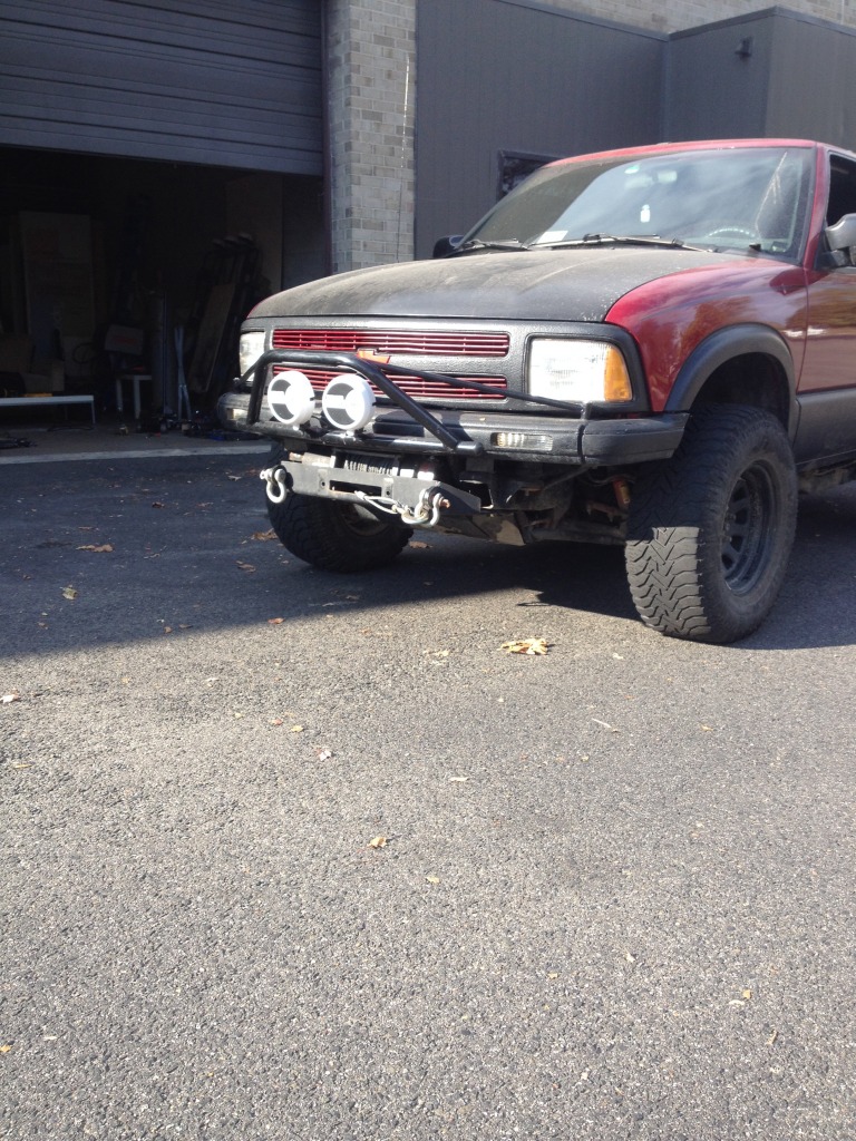

And here's the truck with it fully mounted.
So now I need to order a roller fairlead and the terminals I need to wire it and I will be ready to winch!
