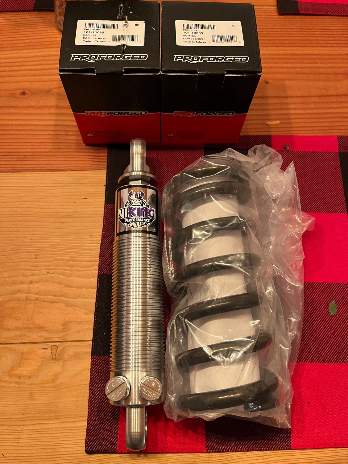

-Viking front coil overs

i have bunch of holley stuff and misc on order (drop leafs, holley AC box and steering shaft, terminator x max and 7” touchscreen dash.
currently waiting to finish my shop and we have bunch of snow, so physical progress is still a bit out, but looking forward to this project! At a point in my life I need to jump deep into this or I won’t ever finish, so any suggestions or ideas I’m all ears.
