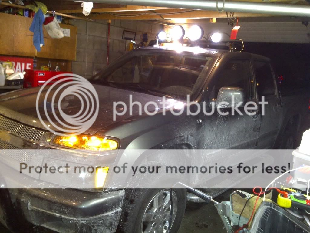

1 positive and 1 negative per light, 4 lights, 8 wites total running from roof to under hood wiring harness. 4 wires per side.
its all done, just have a little bit of adding zip ties on the roof and silicone a few spots to make it water tight in the seals again. it was easy but time consuming because i had to splice the PIAA harnesses to run them in the door seals and i also had to extend both of them by 5 feet, the harnesses that came with it were short, i think they come for the lenght needed for putting them on the bullbar.
the remote wires for the on off buttons are tied intot he DRL..i could have put it right to the battery but i didnt want the led running all the time, and i didnt want my sis and her husband to forget them on and kill the battery, this way car turns off so do the lights.
overall it is a very clean install and ill put up pics of under the hood tomorrow.

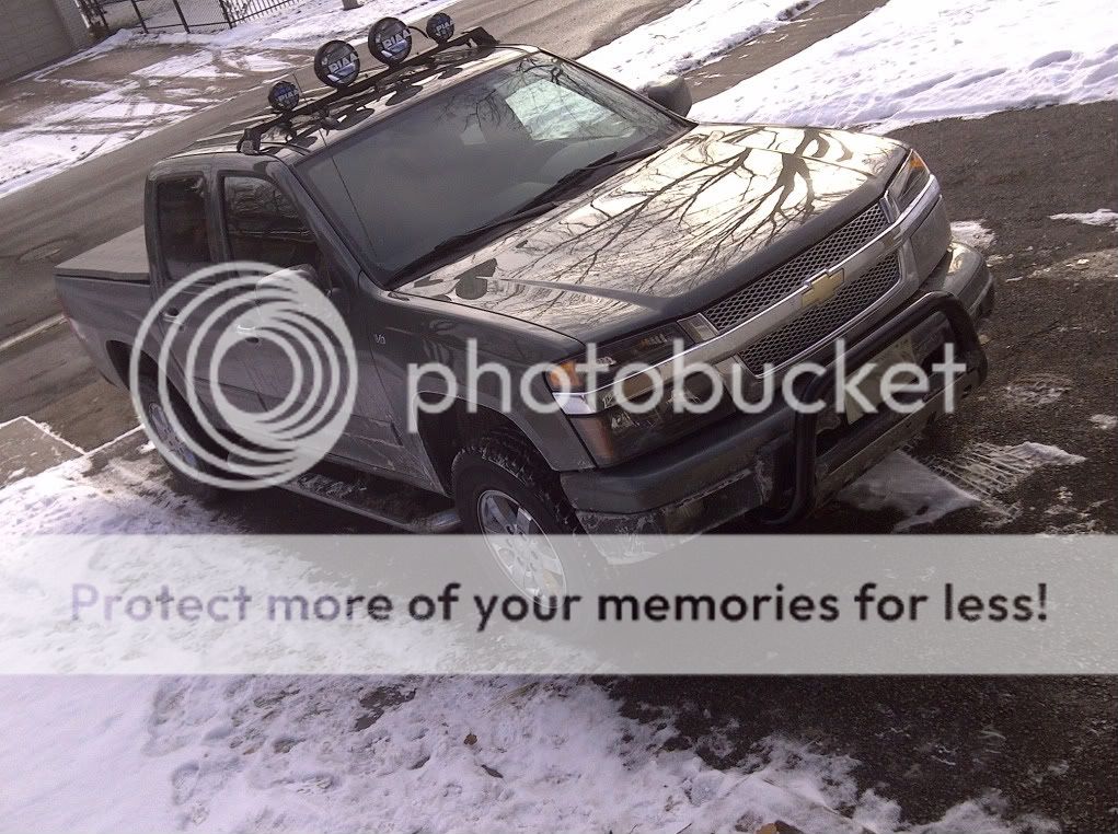

daytime pic
roof wiring
my sister and bro in law were very happy with the install. i used that wiring conduit on all the wiring under the hood, he was showing it to a few people and they all said it looks like a factory wiring harness with the exception of 8 inches of wire going to the battery because i ran out of the conduit so that will be cleaned up next time i get a chance.
