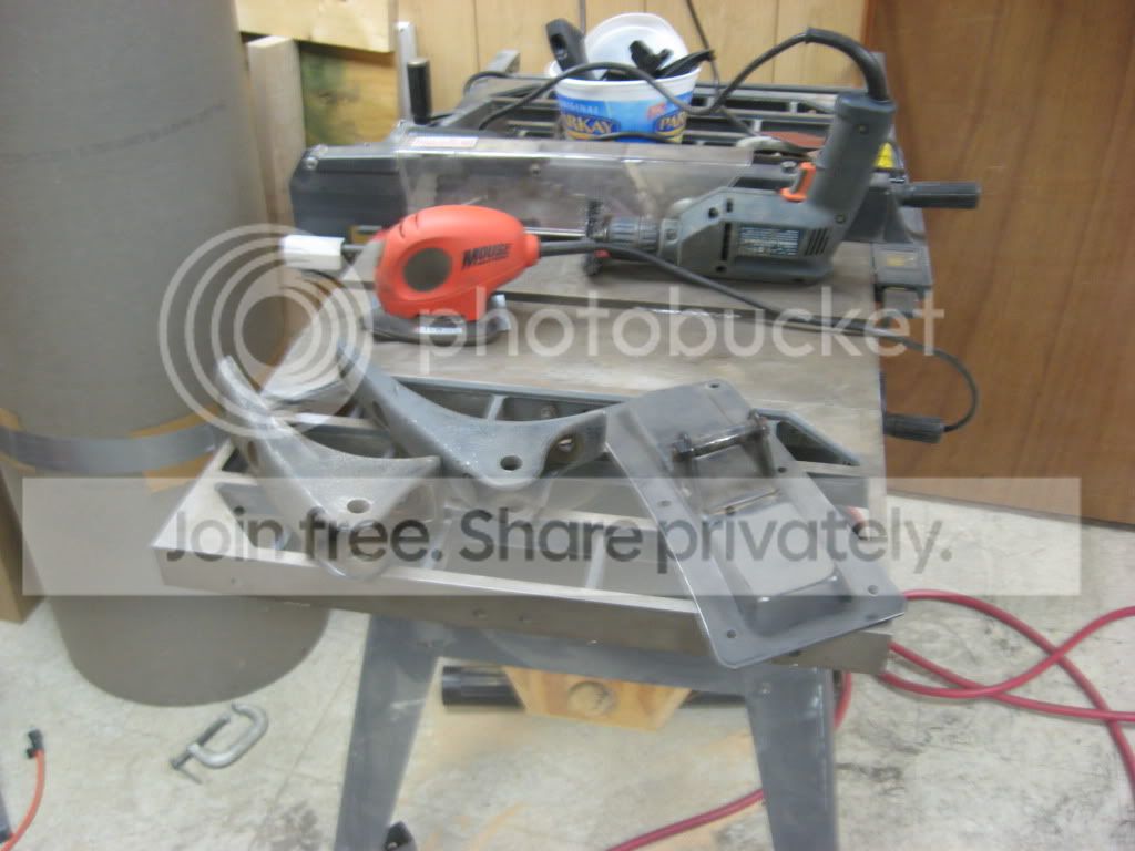

Then if you want to repaint the bracket that it latches on remove the six torque screws and take it off.
Alright, so now you have them both off, it is smart to remove the pins that hold the mounts and the frame together. First remove the c-clip then hammer the pin out, you will have to hit it pretty hard to move it.

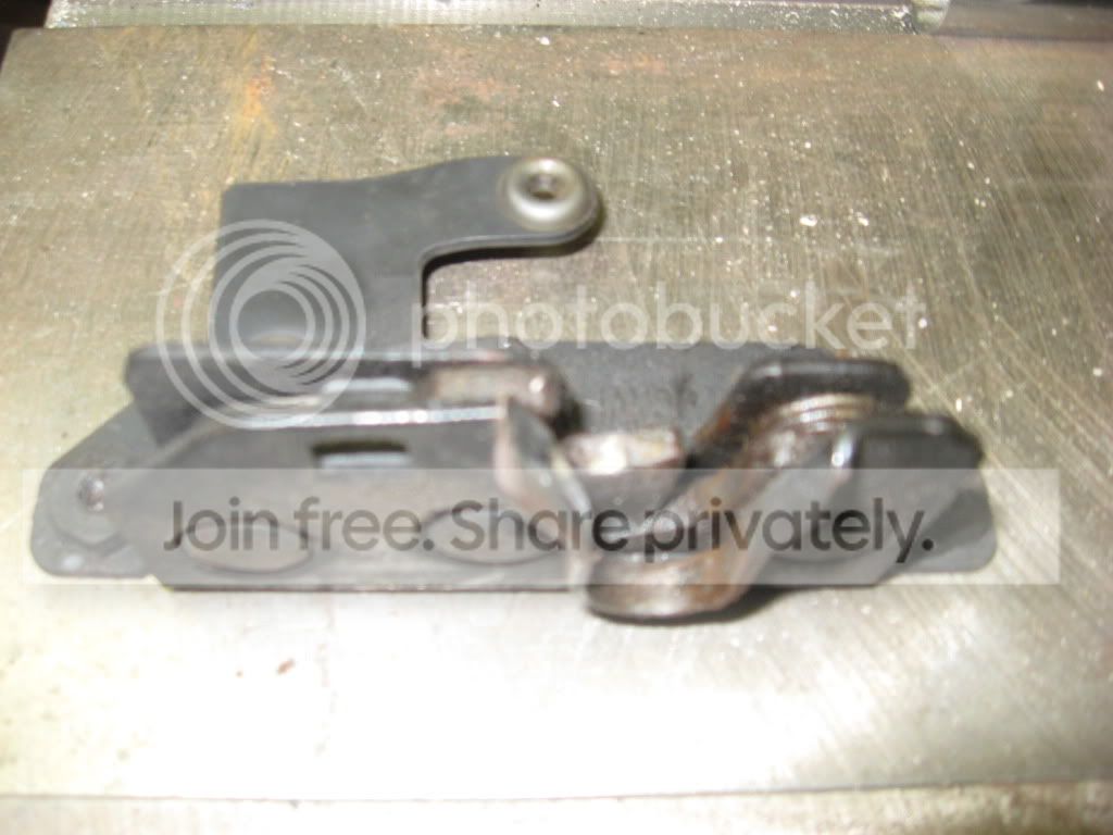

Next i suggest you remove the latch hard ware because you do not want to paint this, do this by unscrewing the 3 bolts holding the latch on and the 1 holding the handle.

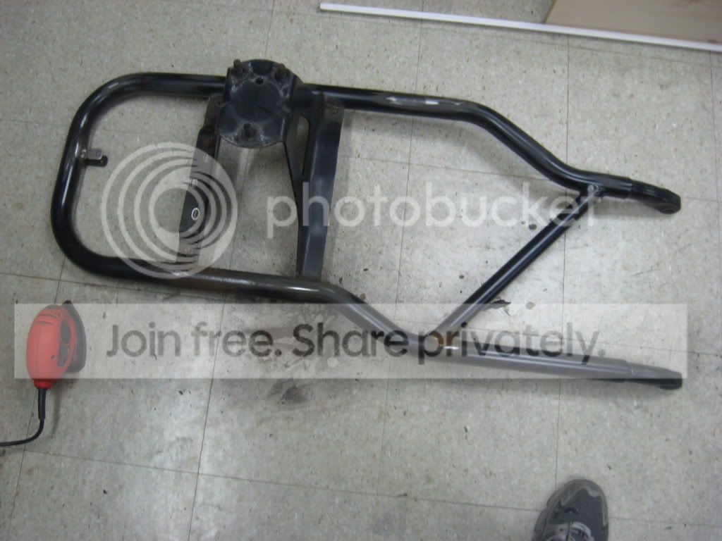

Then begin to sand, try to sand down all the rust until you can't see it anymore, you can try using just sand paper but you may have to use a wire brush.
So today i continued to sand the living daylights out of this rack and heres how far i got....

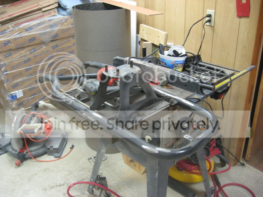

My worst area of rust...
The Brackets
