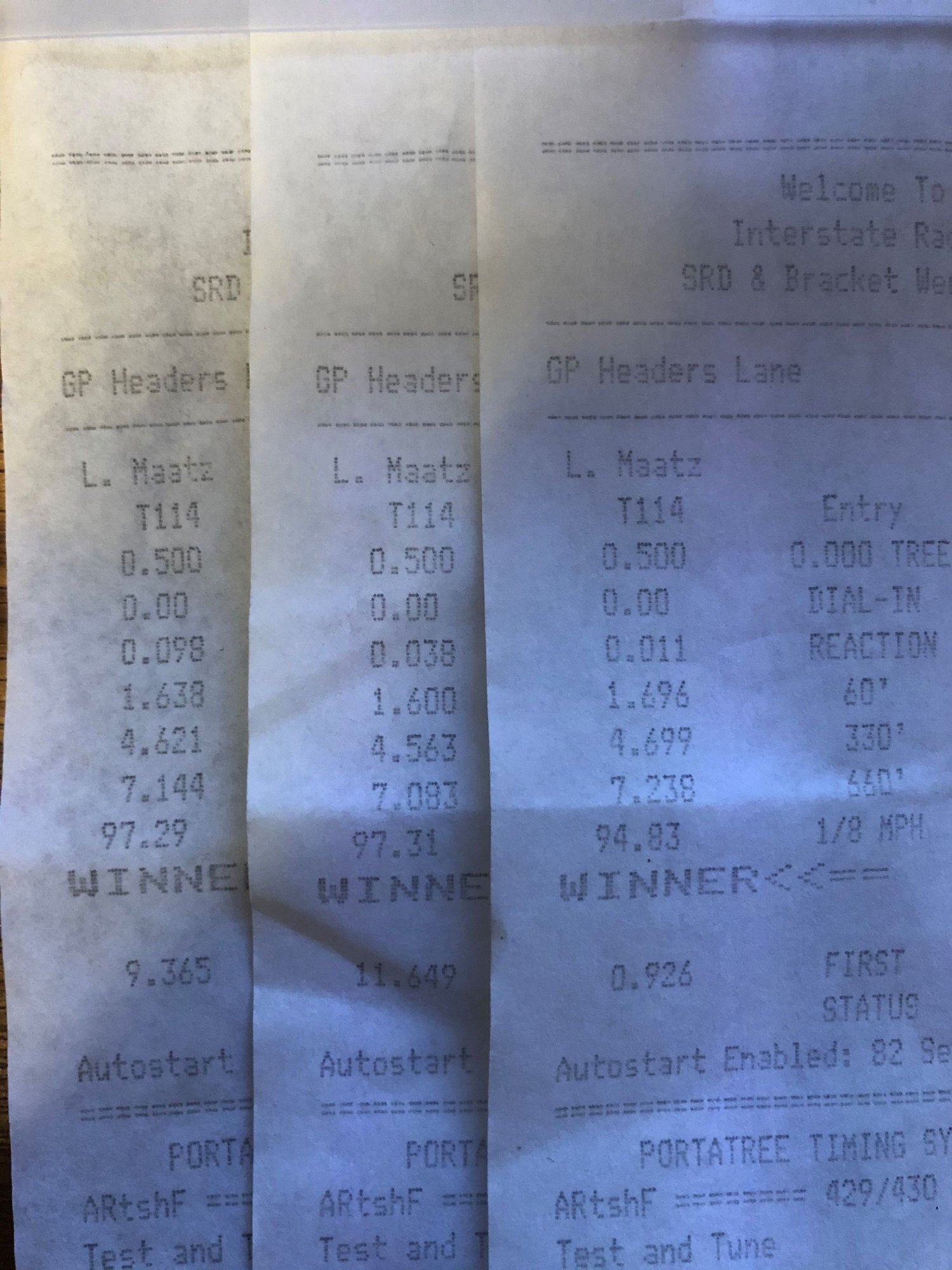

Originally Posted by LesMyer
There are streetable drag radials and then there are DRAG RADIALS without tread that are soft and sticky and won't last at all on the street if you really want to hook consistently.
But your 60' from when you posted a time slip was just fine. What was it on the run when you didn't hook?
Here are my slips from my local track. Its not spinning too bad, but it does not dead hook unless the prep is perfect with my current tires.
The last run was terrible because it danced bad off the line, then pulled right towards the other lane and i lifted twice to get it back in line. It was quite a butt hole pucker kinda run in the beginning.

From: North Central Indiana
Definitely spun quite a bit. Over a full tenth different from before. Interesting that MPH is down a full MPH as well at the 1/8th. Looks like not as much power as before when you ran the 10.9 ET. Was this not as good of air as before, or did you run capped headers or something? I suppose even a supercharged engine is susceptible to weather as long as boost is controlled by just pulley ratio. I suppose turbos would be less affected by weather because they can control to same boost level and that would tend to make the air uniformly dense from day to day - the only thing that would still vary is humidity.
My advice... if you want to ever go multiple rounds in a bracket race, you will need consistent 60' times and reaction times less than 0.05 Looks like you are getting a good handle on the reaction time. Good job! If you can get it to dead hook consistently, then I predict you will do quite well bracket racing.
As an aside, doesn't running 1/8 mile suck? To me it's like having to abort in bed.

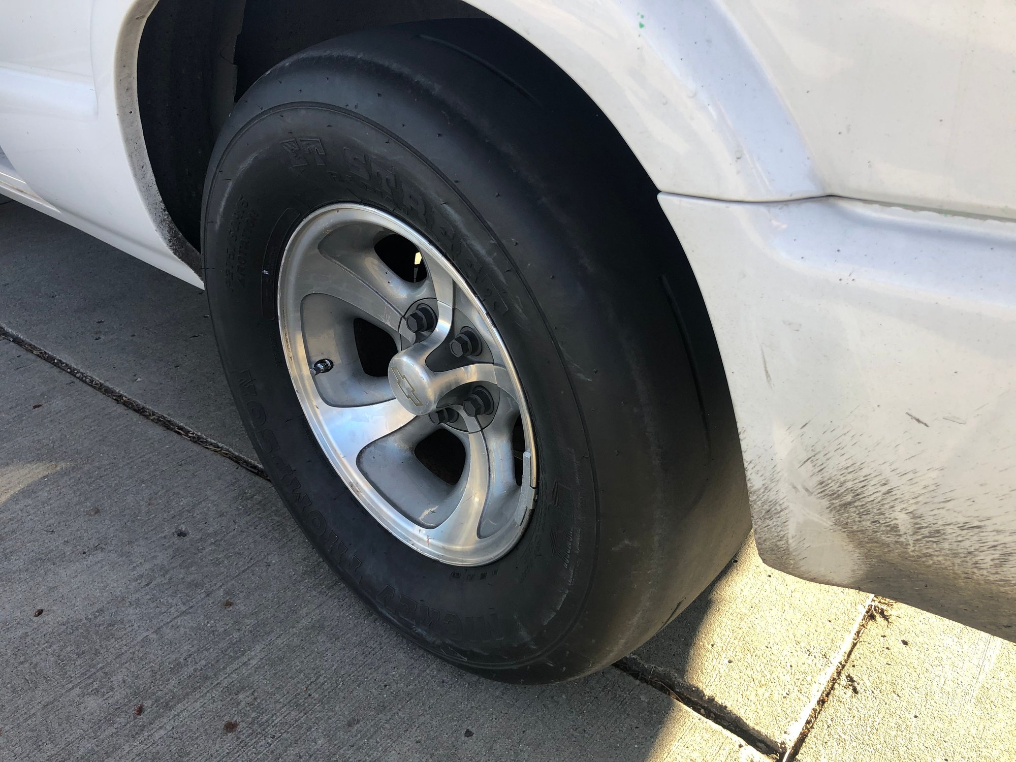

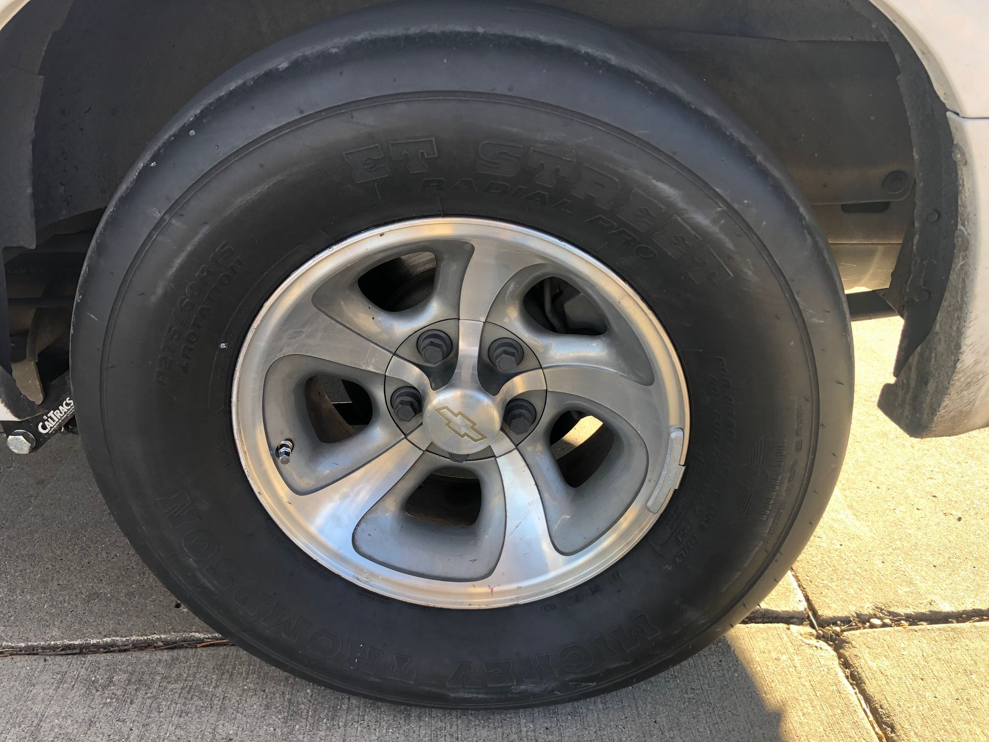

From: North Dakota
For anyone that is curious, you can fit 275/60R15 tires on the factory 7in wide swirlies. They do bulge a bit and ill see how they do at the track when the weather gets warm again. These are drag radials that are not supposed to be a daily driven tire, so i am not worried about street manners or tread wear with them. I will have to play with the psi and see what the contact patch looks like, but i would really like to keep the sleeper look if possible. If they dont work out then i will end up buying 8in wide wheels and going with a different look for the truck.

From: Idaho
Looks good! I've put 35x12.50x15 on the factory swirls. Yes they do poke out lol.
