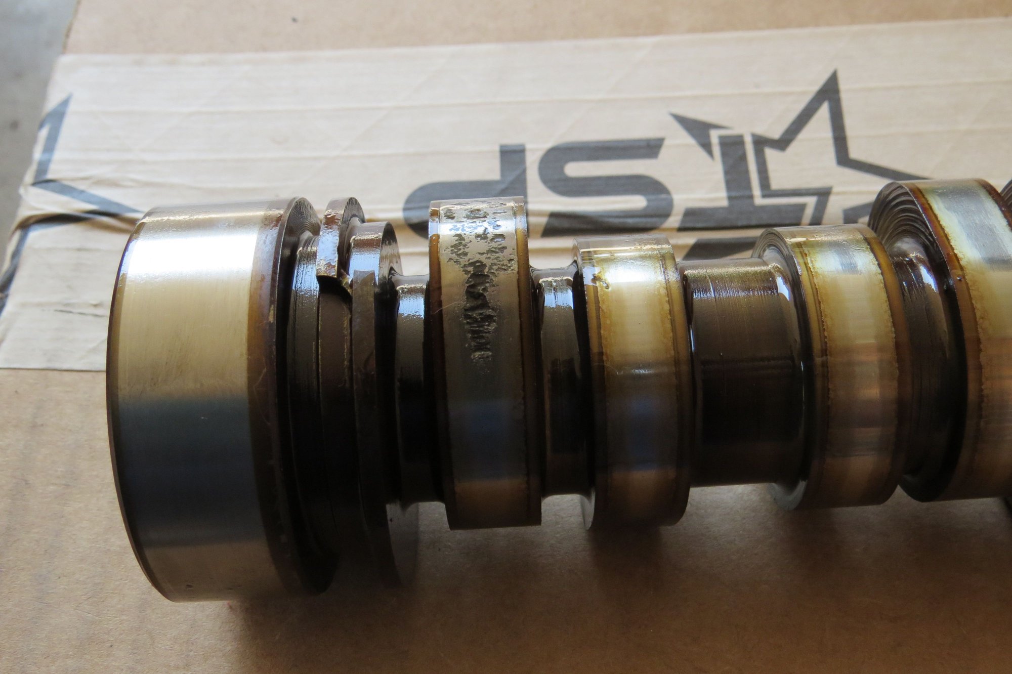

This is not how i want my blazer to look
But im glad i did.
One of these things is not like the others
It looks like the cam is damaged also......so time to upgrade.
BTW the only symptom of this was a slight tick in the valvetrain between 1500-3000 RPMs. At idle she was quiet as a mouse.

This cam is good to reuse right? I measured it, its only missing 5 thousandths of lift on that lobe. HAHA
The last lobe was about to eat it also.
Oh well, hopefully it didnt damage the rod or main bearings. for now im going to slap a new cam, LS7 lifters and LS7 valve springs in and let her rip.

Good thing you decided to tear into it, yikes!
Old Sep 12, 2017 | 07:33 PM
  #44
Better now then down the road. That sucks.

I personally would pull the pan and have a very close look.
Purge the oil and let it filter through a coffee filter - may take a day. You will know where the shavings went.
Pull the oil pan and inspect on the inside. You will see if there is particles in the sump and the slush.
Pull the oil pump and inspect for damage or wear outside the expected.
And as the bottom is open and you have already pulled the heads - why not just pull the first two mains and inspect and at least the 1 + 2 rod caps to have a look?

Thats my dilemma right now. i know i should pull the pan and inspect the mains, but to do that i have to pull the engine and put it back on the stand. I have spoke with quite a few guy that work for GM and they have seen this happen way too many times on LS engines. everyone i have spoke with so far says to just throw a cam and lifters in it and go but deep down i know thats wrong.
I think im going to run the oil through a filter like your saying and open up the oil filter to see what it looks like. If they both look ok im just going to run its and see what happens. Luckly these engines are cheap and easy to get another one if needed.

I agree a good way to go - step by step. If not happy with what you find in the oil, at least you know.
The Blazer is always a tight fit. Just seen a nice shaved camshaft at my machine shop. Ford 351, solid lifters - wrong oil.
Eaten up to 1/4" from the lifter and the cam. The engine is shot, total rebuild. Particles everywhere.
Good luck that you won't find anything and can continue running it.

Well the oil looked good so im just gona run this engine and see what happens.

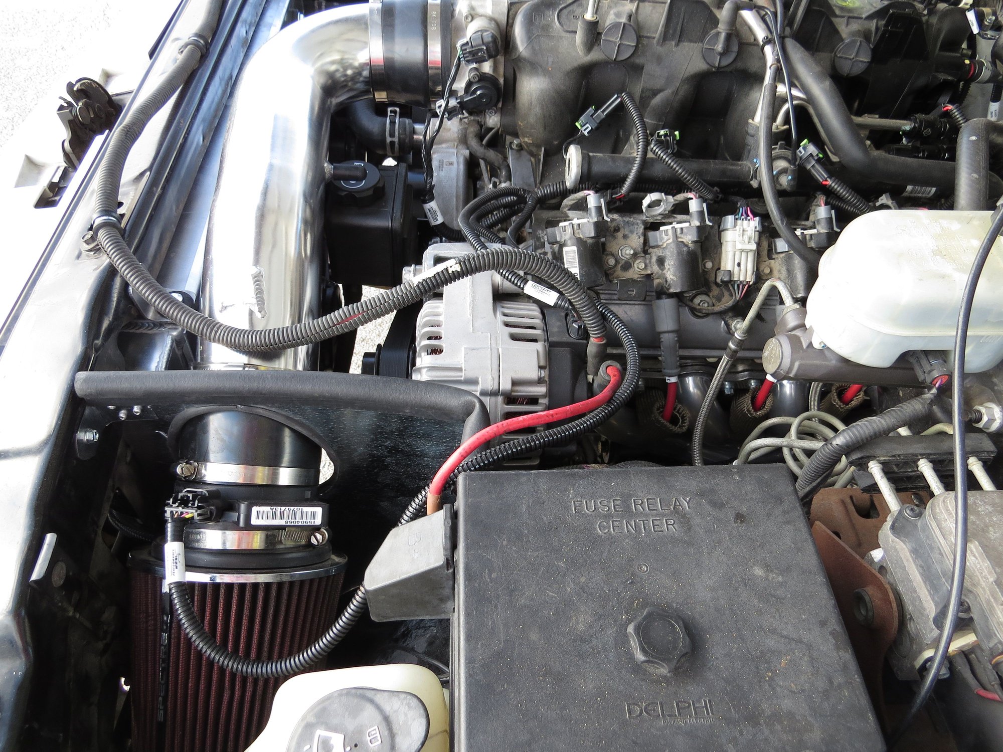

Im also building an air box to try to keep my Intake Air Temps down.
