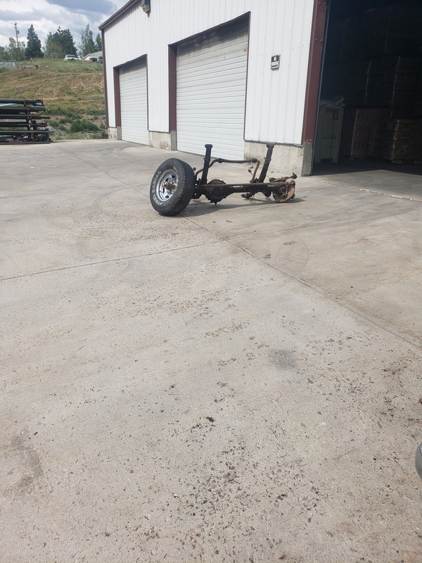

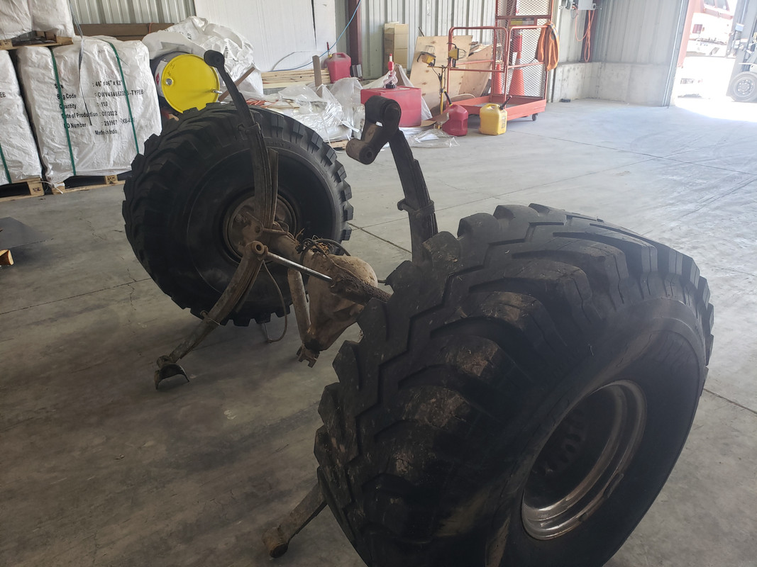

Axles are pulled from the suburban and waiting to go under the jimmy!
