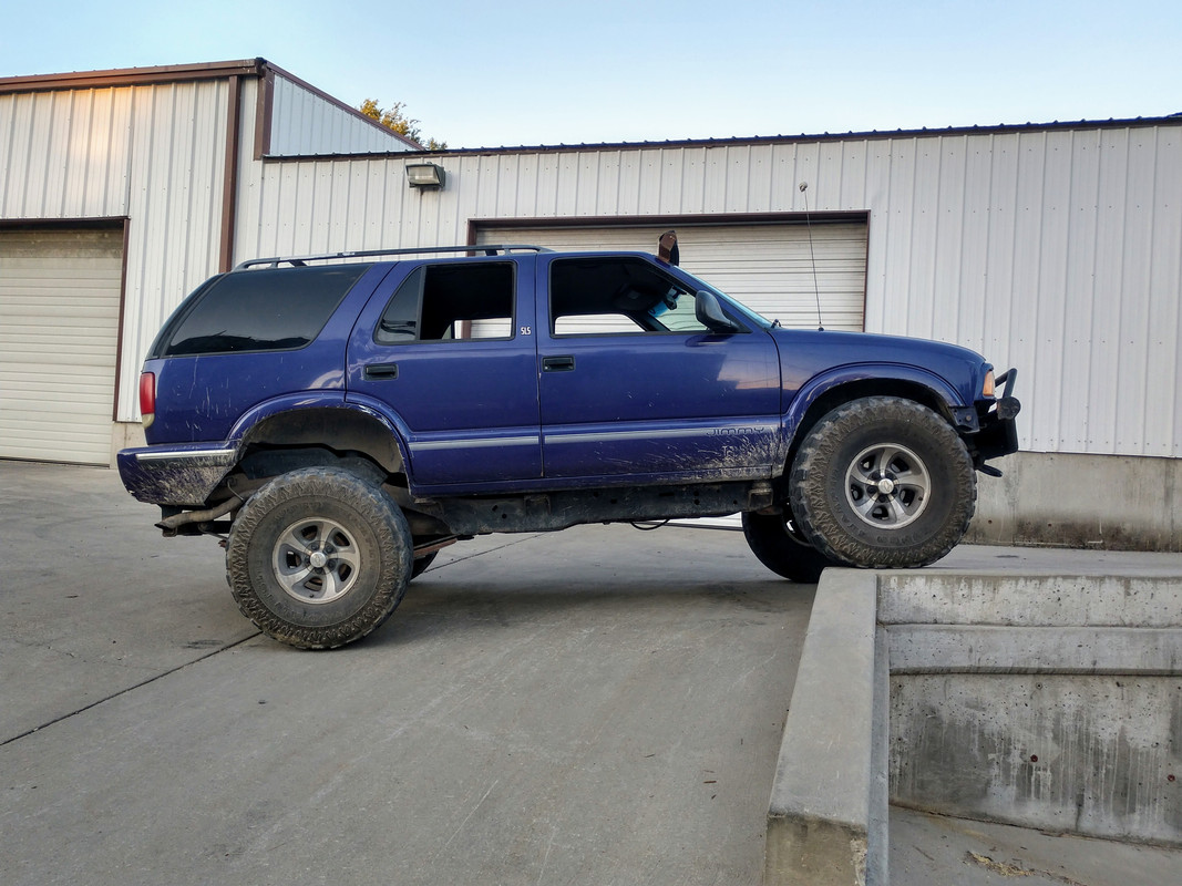

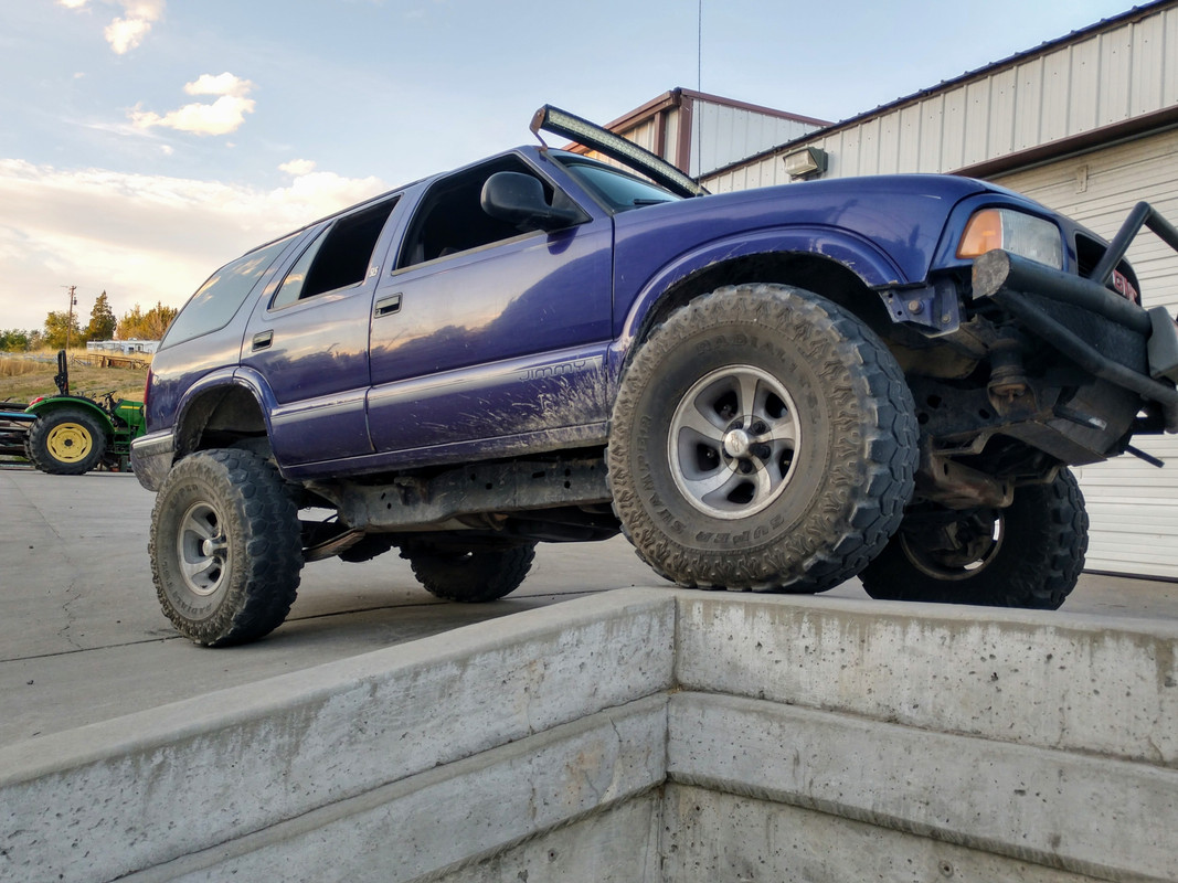

Had some time at work today to work on my bumper. I added some diamond plate filler panels. Still need to finish the end caps and brush guard.

Pulled off both sway bars and extend my shock mounts. Not bad for ifs on 35s.

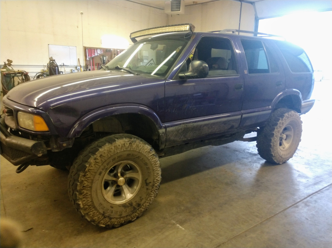

Swapped the 2" body lift for a 3". I built up the steering stops to keep the tires from rubbing the frame until I get some spacers. Now I can finish the front bumper and start working on a rear bumper. Rock sliders/step bars are also started to be built.
