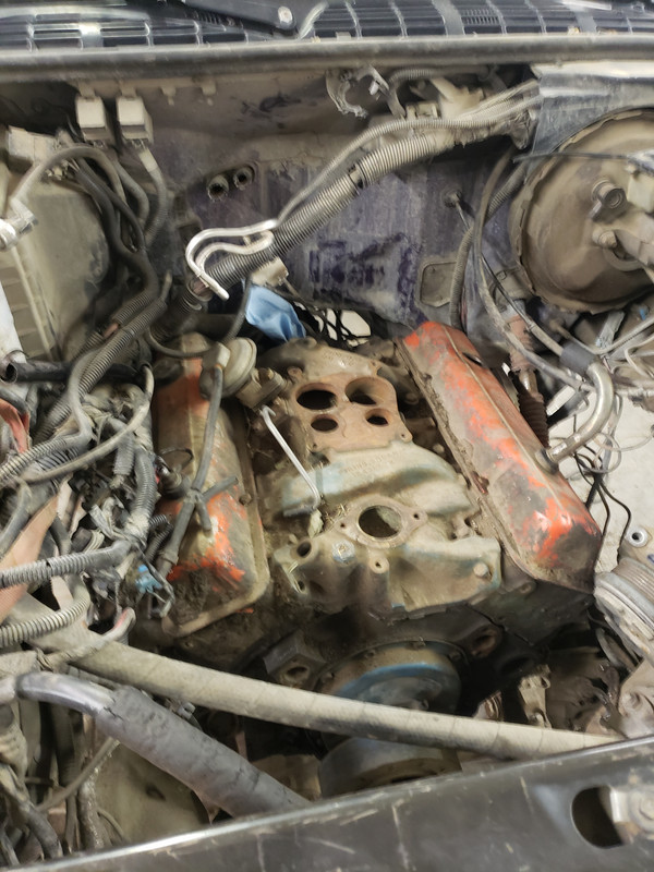

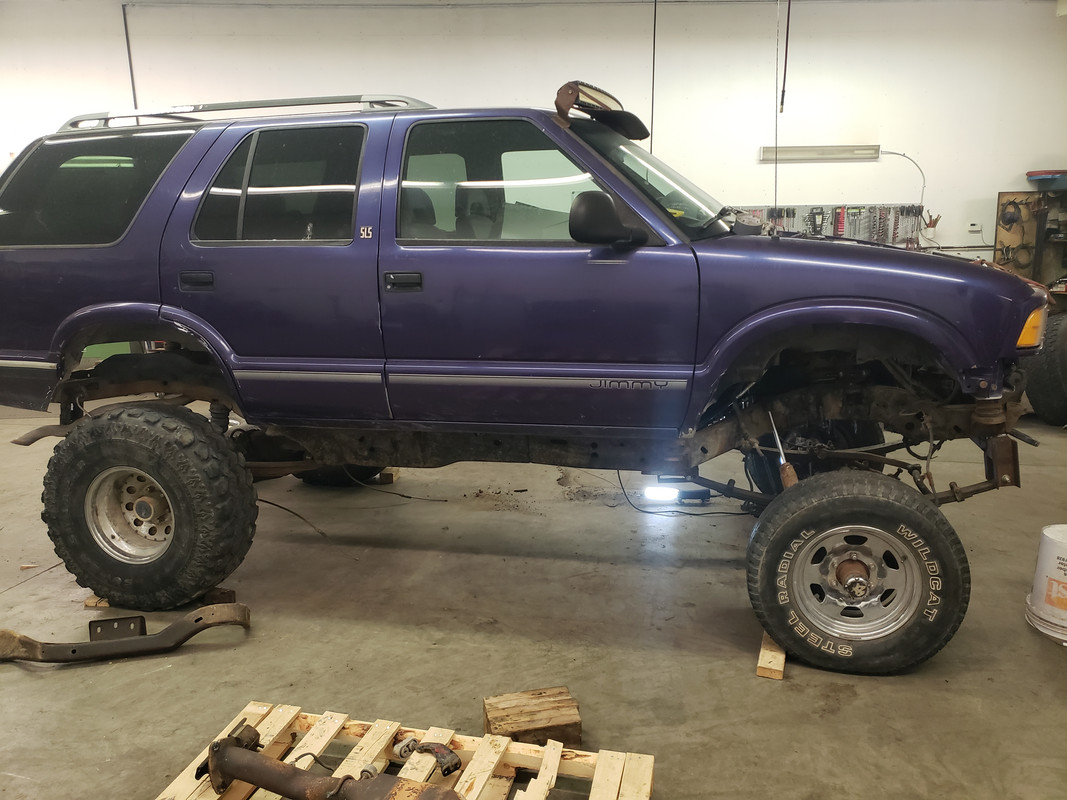

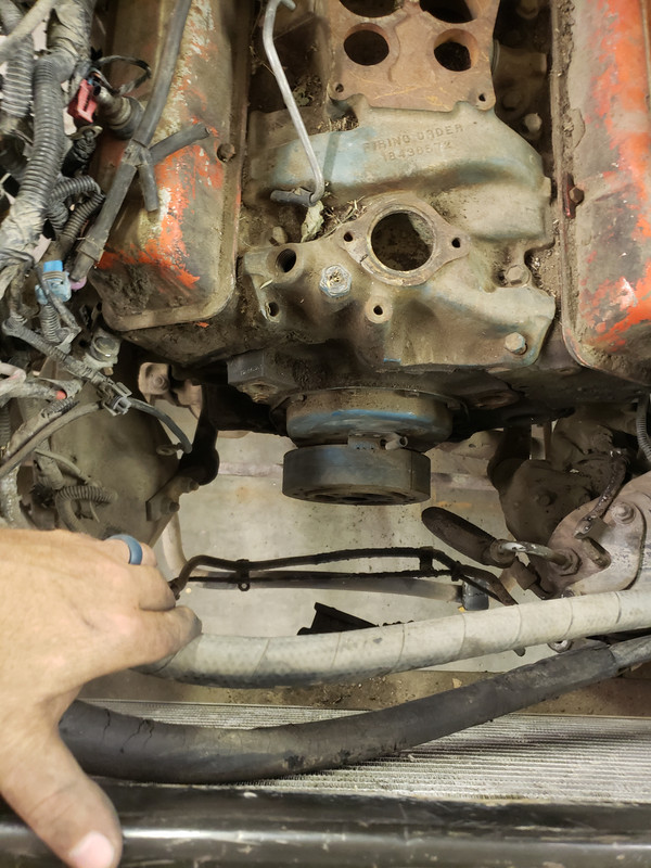

Progress!!
It fit better than I thought.
Transfer case tucked up nicely!
It didn't drop the front end as far as I had hoped.
Thats on 235 75 15 on the front and 35x12.50x15 on rear. So I either have to pull a spring from the front or add some from 6in pack to the rear.
Old Sep 10, 2022 | 06:14 PM
  #223
If you can still fit the tires you want to run, I would lower the front to match the rear. If you do it the other way around, I would be concerned about your front driveshaft angle. I've seen several SAS S-10s with Bluetooth front driveshafts because people didn't think about that.

It wasn't supposed to be this tall lol! Plan was 37-40 inch tires. The drive line angle doesn't look terrible but I didn't have them with me today to test. Im thinking removing a spring off the front will be the way to go. The front is very stiff even with the drive train in it now.

Mine started out quite a bit taller than it is now, but I've lowered it over the years. I started out with the 6" front springs off my K5 with one leaf removed and I'm currently running 2-1/2" springs with all leaves still in place. But my rig is a tank, so it rides pretty nicely and gets plenty of flex with the K5 springs.
My drivetrain (SM465/NP205) was really short, so my driveline angle in front was terrible. I replaced the 205 with a divorced-mount Atlas so it's all good now.

Thanks Don! Its slowly getting there... didn't get as much done today as I wanted. I will say the 350 dropped in very easy and without a fight. The trans and transfer case went in smoothly as well. Im almost scared I missed something lol.
