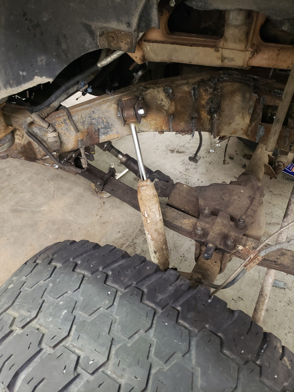

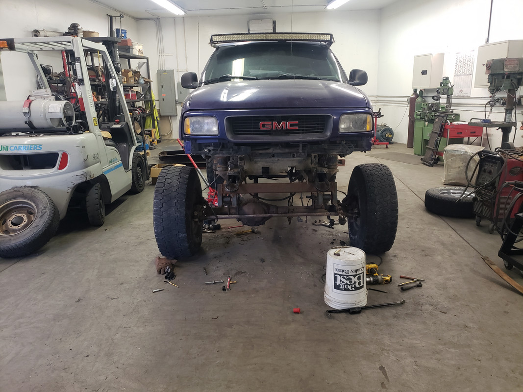

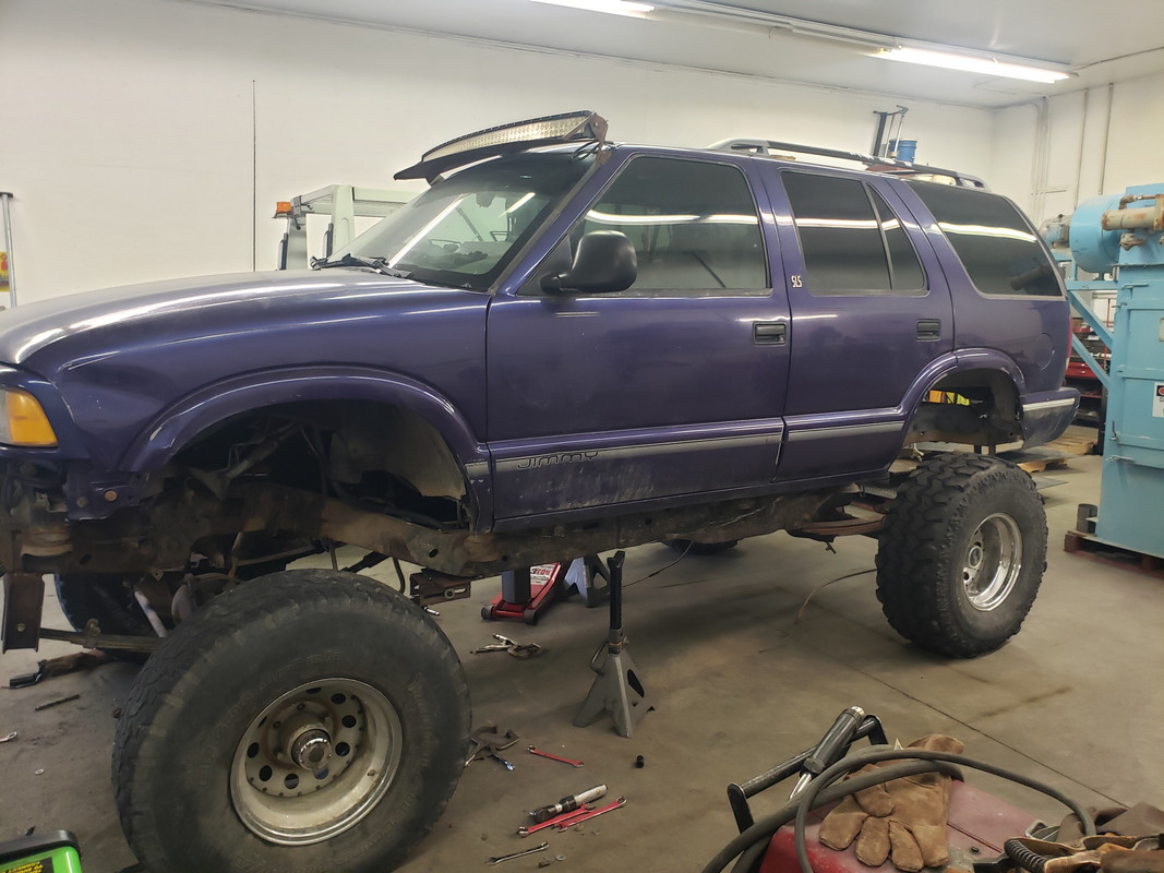

Got the jimmy in the shop this weekend! Pulled a spring from the front and redrilled my front hanger to drop the front 2 1/2 inches. That helped the drive line angle. Then I cut down the front shaft and clearanced the cv and got that installed. Then front suspension is almost finished. Going to work on brakes and steering tomorrow I think.

Buttoned up most of the front suspension today. I think all I have left are brakes and steering.
Then finish up the drive train and front bumper and I should be able to drive it!
