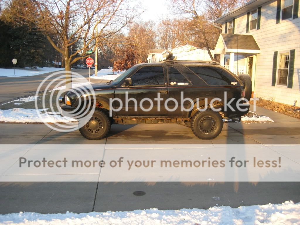

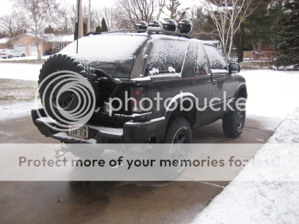

pics of firebird rims with treadwright 265-75-16s (32.2inch tires)
Before with just the body lift and keys
after with tires and rims
